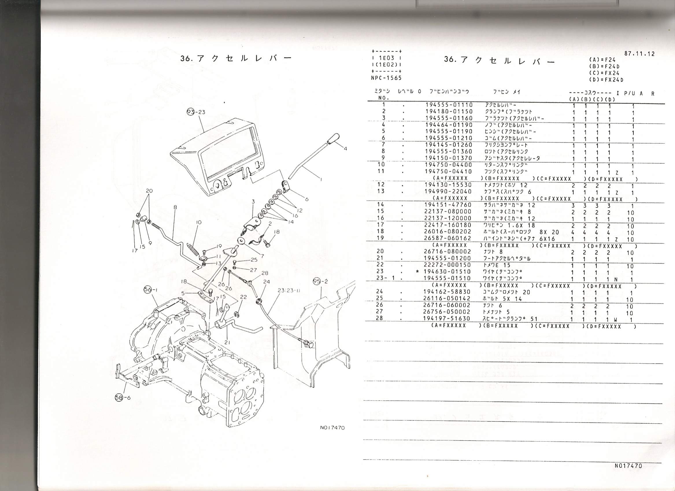

The previous owner cobbled together the throttle assembly. I will try to post some photos tomorrow. The throttle is held closed by a spring attached at the throttle valve and then on the hose clamp on the fuel line from the injector pump to the fuel tank. The throttle does not stay in place. I assume there is supposed to be a friction place somewhere in the throttle controls, but I think it was removed.
Can you describe what it should look like, or do you have a photo or drawing of the throttle assembly (specifically the friction mechanism)?
Thanks!

I will attach the page out of the parts manual. The friction washer is #7. The assembly has double lock nuts #12. I remember GW's was pretty much stuck but with a little penetrating oil and working it started working pretty good. Not real easy to access this assembly but I'll be suprised if it isn't on yours. A little hard to find. I'm sure you know the hand throttle is what utilizes the friction plate and the foot throttle just releases it back to where the hand throttle is set. Not sure I'm making sense. :confused:

I opened it up to take a look. I am missing the double lock nuts. Do you have any idea of the size of the nut?
/ FX24D throttle friction #8
The size is indicated on the parts list. 12mm. However, it does not give the pitch. That part number crosses over to this steering wheel nut but it doesn't show pitch either. I find it interesting Hoye sells this nut for 96 cents and some sights are selling it for nearly $10. Sort of like price gouging. Having said all that you could most likely look at the threads closely or measure them and determine the pitch. Then most likely buy it at Tractor Supply or a Hardware store. Yanmar Tractor Parts: STEERING WHEEL NUT _
