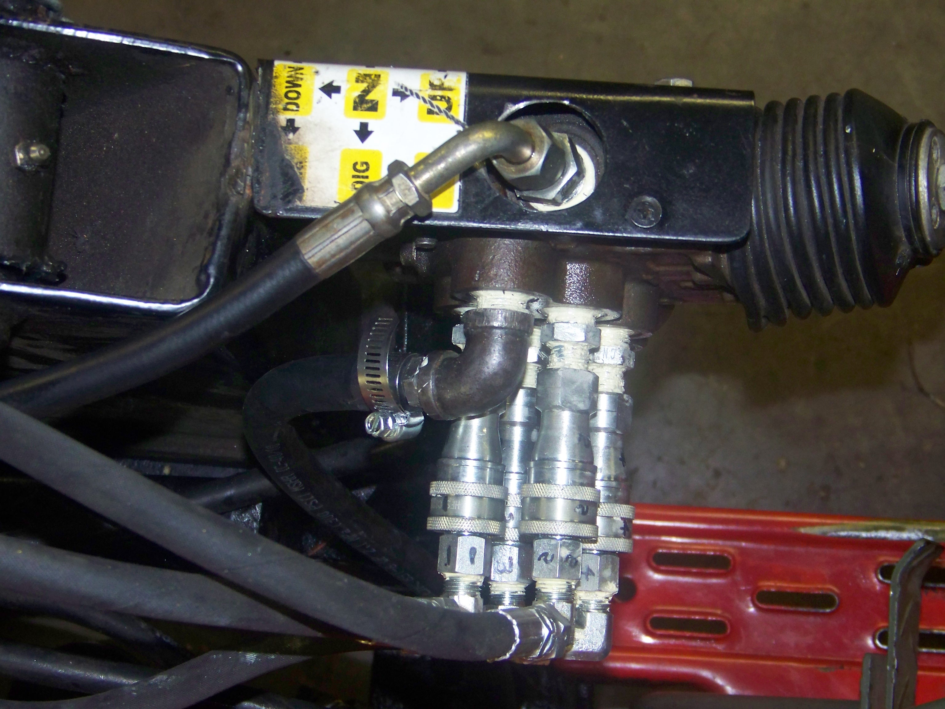

Coy, as I remember he was losing hydraulic fluid every time he turned the tractor over. Also, " I also believe he has 2 hoses from the tractor to the to the loader valve.", that's for each FEL function, lift and curl, so I was thinking he needs a hose for each function. Two hoses.
What you are suggesting removes the loader valve from the hydraulic circuit. That approach means he can not use the valve for any other function until he hooks it up using your QCs to re-attach to the hydraulic circuit. My approach was to allow him to continue troubleshooting without losing more fluid.
If it were me I would put QCs on the loader spools and the lines, and then if the FEL was off the loader valve could still be used for added functions. My MF is so plumbed so that in Winter with the FEL off I can use a 2 function, raise lower and turn, snow plow.

I agree with your thinking. Also, if you leave the loader valve on the tractor with no quick disconnects on the inlet and outlet you do away with the possibility of a deadhead. Using quick disconnects on the inlet and outlet is risky because if one gets snagged loose or something you risk damaging your pump. Do it like this.
To ease your minds the hose with the clamp is just a tank return, it sees no pressure. There is a power beyond hose not shown going back to the 3 point.

As I remember yes he was losing fluid into a bucket when cranking the tractor. But I if I remember it correctly it was from the supply (pressure) line to the loader. That needs to return to the tractor. At present without doing so he runs the risk of dropping his fluid level below his suction screen and sucking air to the pump.
Yes hydraulic hoses should always be routed or placed in a way to prevent there being caught and jerked off. Even the tank lines as you again risk loss of fluid if compromised. For the OP with the tractor not running trip hazard may be a large concern short term, long term they need to be secured in a manner to prevent be hung by anything one could imagine.
