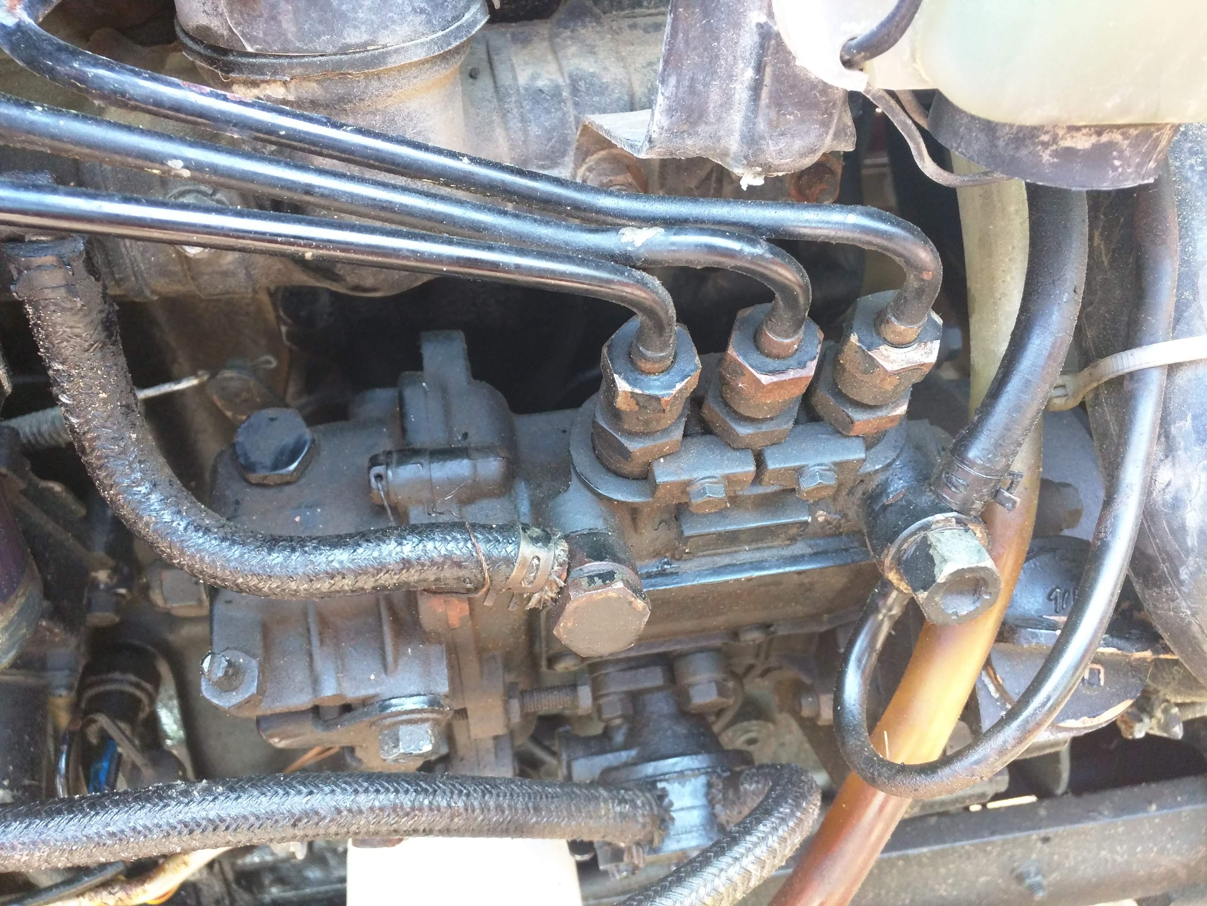

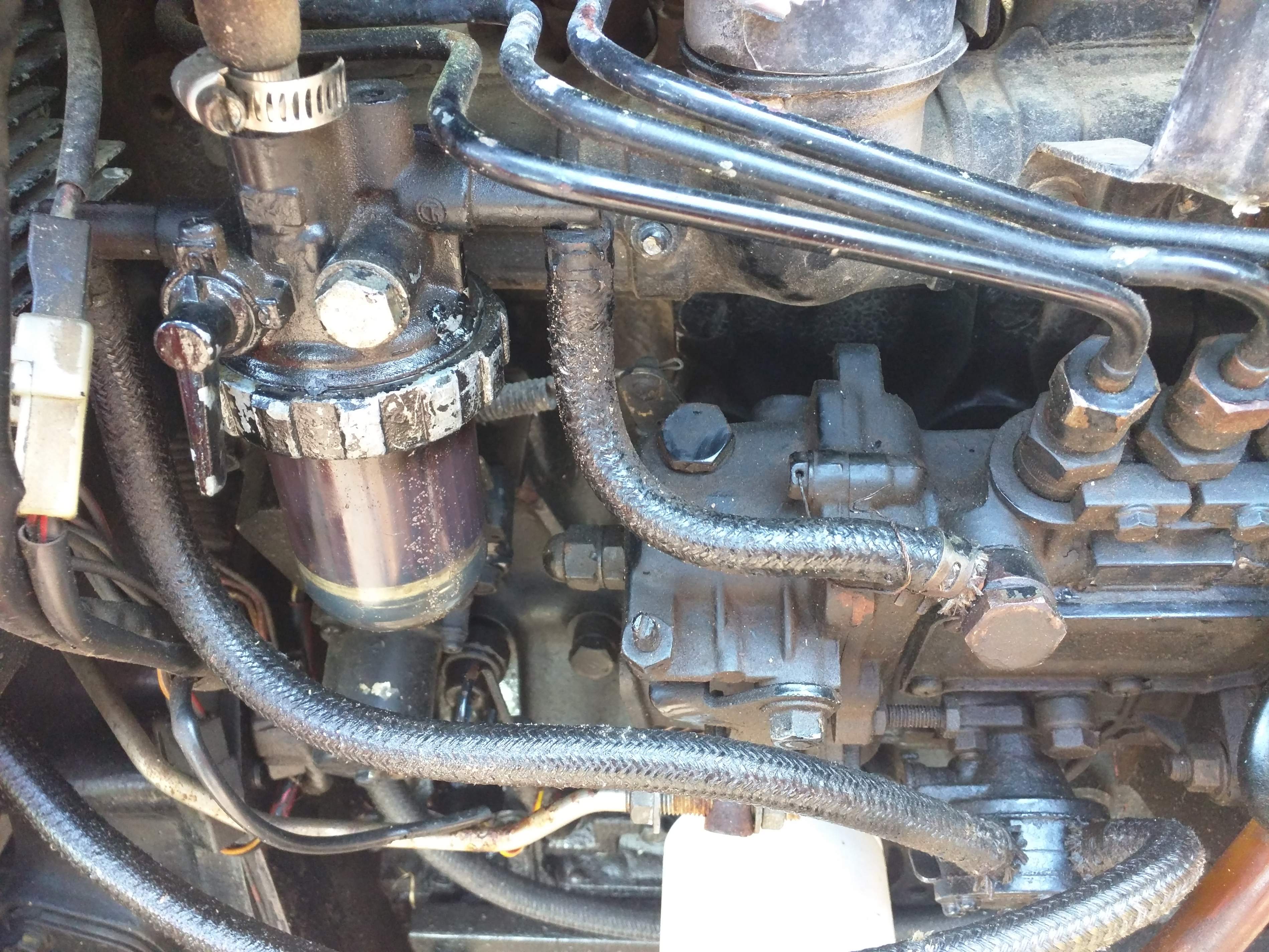

Okay, there's good news and there's bad news. The good news is, I think I've likely identified the culprit as the fuel shutoff solenoid. I don't know what that is or where it's located, but it sure as heck isn't making any noise when the key is turned on.
The bad news is, there isn't really anything on my fuel system that looks like the pictures in the "bleeding the fuel system" links above. I still have no idea where the bleeder screws are. I'm attaching some pictures below - if anyone can point out A) the faulty solenoid and/or 2) the bleeder screws, I'd be very appreciative. Also...can the solenoid be fixed/bumped/knocked back into service, or am I ordering parts and doing surgery?

Picture #1 bleed screw is right above the cutoff valve handle.

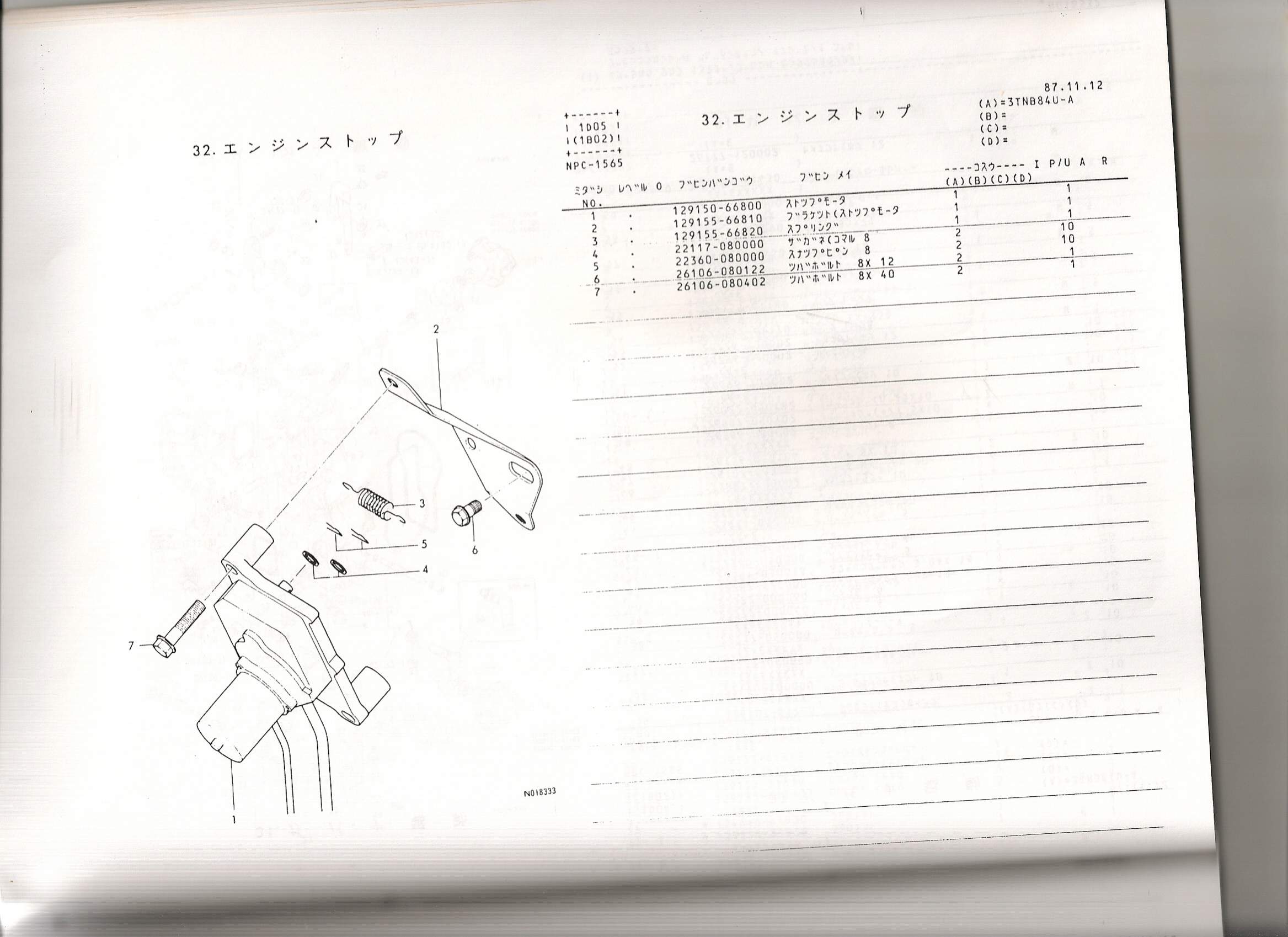

Posting a picture of the cutoff valve. #1 in parts drawing. You should try cleaning it first, if that doesn't work you might consider what others have done in this thread. http://www.tractorbynet.com/forums/yanmar/303927-y17-three-cylinder-not-cranking-2.html
It looks just like the picture Winston posted. Its small black can right below the plastic fuel bowl on your second pic.
Try tapping it with a SMALL hammer while the key is on. If that does not work, try to move the arm on the back of it with your fingers, (while the key is on)
Also, the wires coming out from the side may of worked lose, try unplugging it, cleaning the connector and plug it back together.
Careful with your fingers in case it engages.
