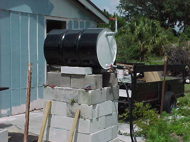

<font color="blue"> I got a 35 gal desiel fuel tank from an old dump truck plumbed in a filter a rubber line on the outlet side an a ball value and air hose quick chuck in old drain plugs.
I use the loader to put it in the trailor or go to the fuel station.
To fill the tractor just hook the air comp to it with 5 to 8 lbs pressure.
</font>
I was talking about doing something similar to this.
Read my post in this thread.
http://www.tractorbynet.com/forums/showflat.php/Cat/0/Board/jdown/Number/781085/page/0/view/sb/sb/5/fpart/2/vc/1/o/all

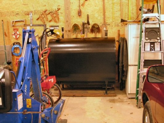

I bought a 275 Gal tank from home depot for under $300, then added the filler gauge, vent, and a drain cock. Total was probably $350. Then I added a 110V Fillrite pump and use it for my Jetta. I think the pump was under $200, but I'm not certain.
At my farm I use a 55gal drum and hand pump for the tractor, and another 30 gal tank for transporting fuel from the filling pump back to my place. The 30 gal drum fits upright in the back of my pathfinder, and can be moved in the loader then lowered to the ground when full. I then pump the fuel from the 30 gal drum to the 55. I'd just use the 55 gal drum if it fit in the car, but it doesn't.
/ Fuel Transfer Strategies #67
Ditto Hayden. I used to use a 30 gal. poly drum and handpump. ...mounted the drum in a pallet and took it to local oil co every couple of months in back of my truck to get off road diesel. Used to take about 10 min to top off the tractor after a day of work (had to keep going to tractor to check on how full it was.)
Then I got lazy, build a setup much like yours w/275 gal oil tank, guage, draincock and electric Fillrite pump w/autonozzle. Design from here courtesy of Pineridge. Now oil co drops 150 gal twice a year (summer and winter diesel) w/out delivery charge and it takes me less than a minute to top off. I use the 30 gal tank for kerosene for the torpedo heater that heats the barn when I am working in it in Winter.
Definitely the way to go. ...no more horsing with 5 gal cans. Using off-road will save enough to pay for the fueling setup inabout 3 years.
