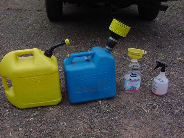

Yellow plastic cans from Lowes @ $6.95
JAZ 60 micron filter funnel from Behrent's Racing @ $32.
Battery powered kerosene pump from Walmart @ $7.
All is good. The little pump is great!
