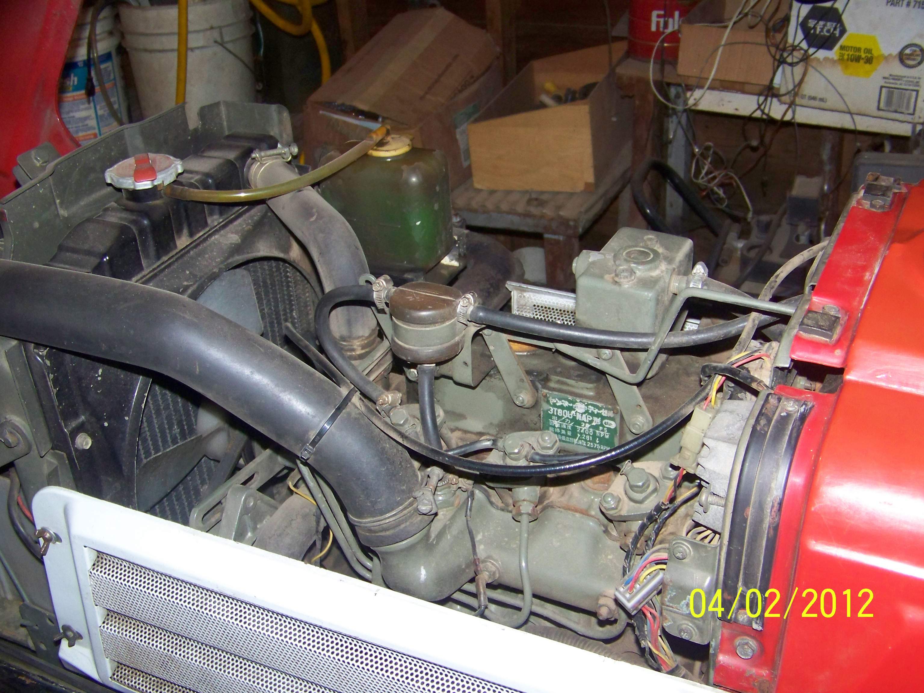

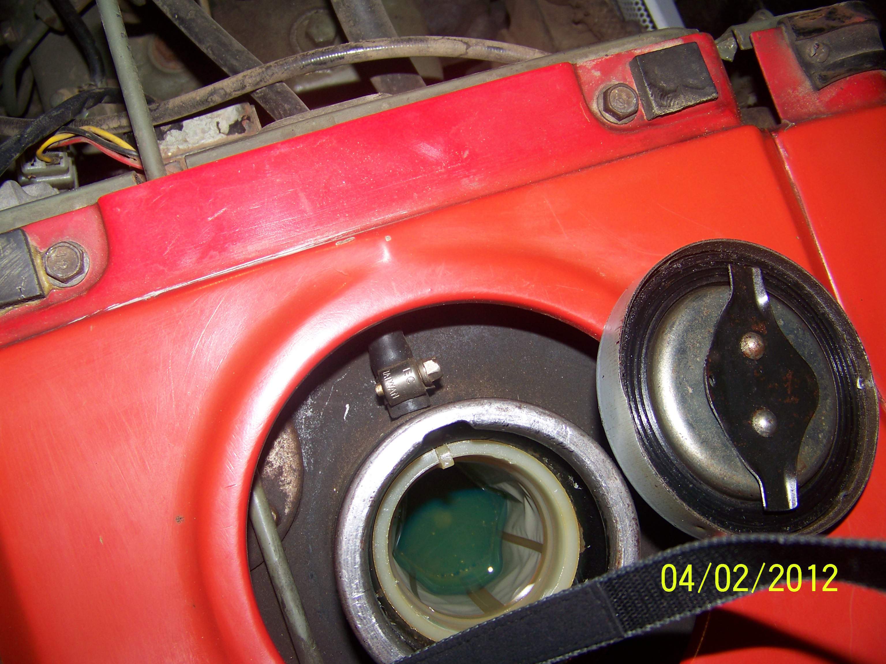

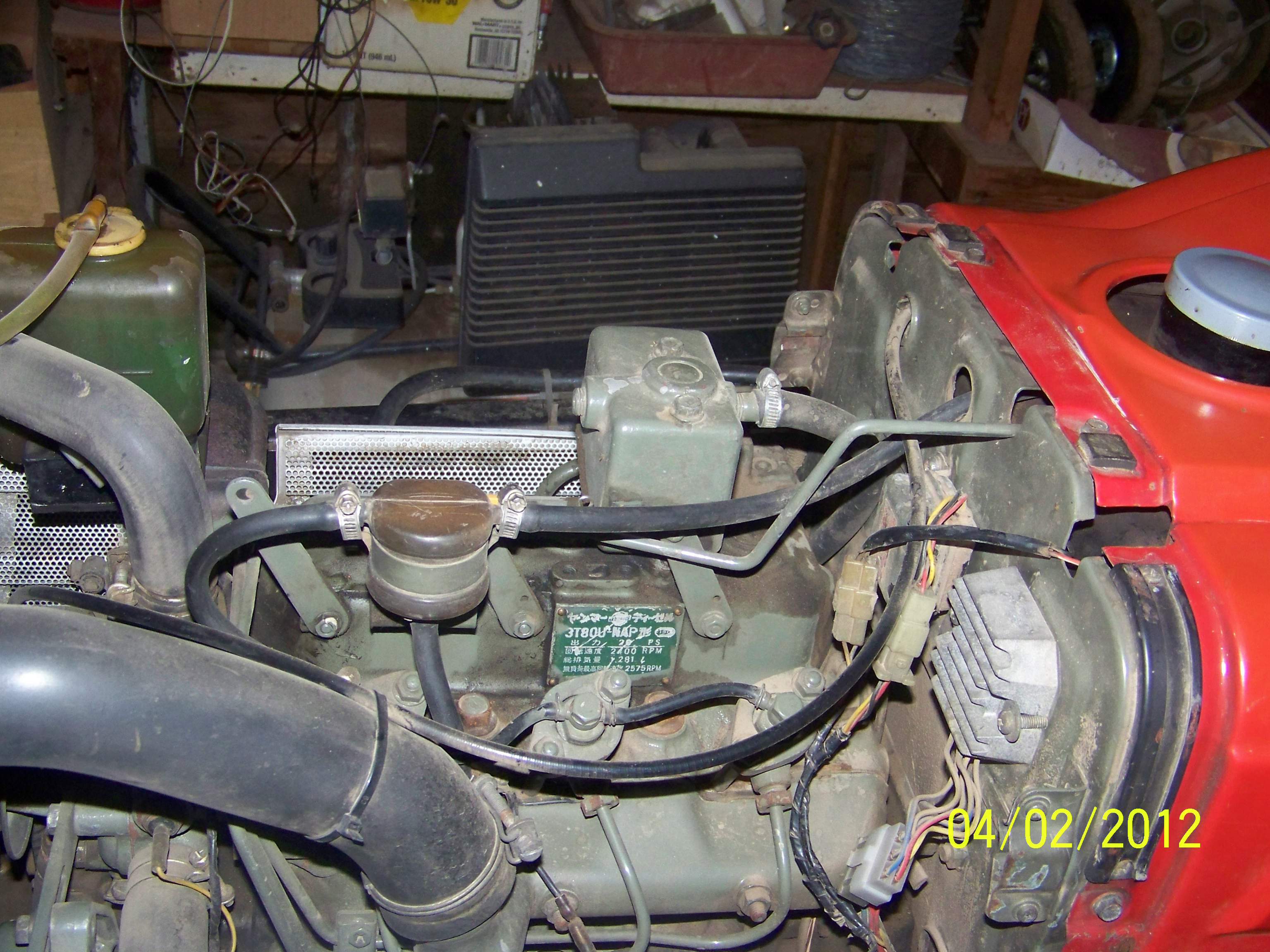

Here is mine.

Thanks, Winston. Looks different than mine, probably because I don't have the thermostart -- wish I did! I have a small (~1/4") diameter host coming off of the second injector. I'll see what Hoye has for me...

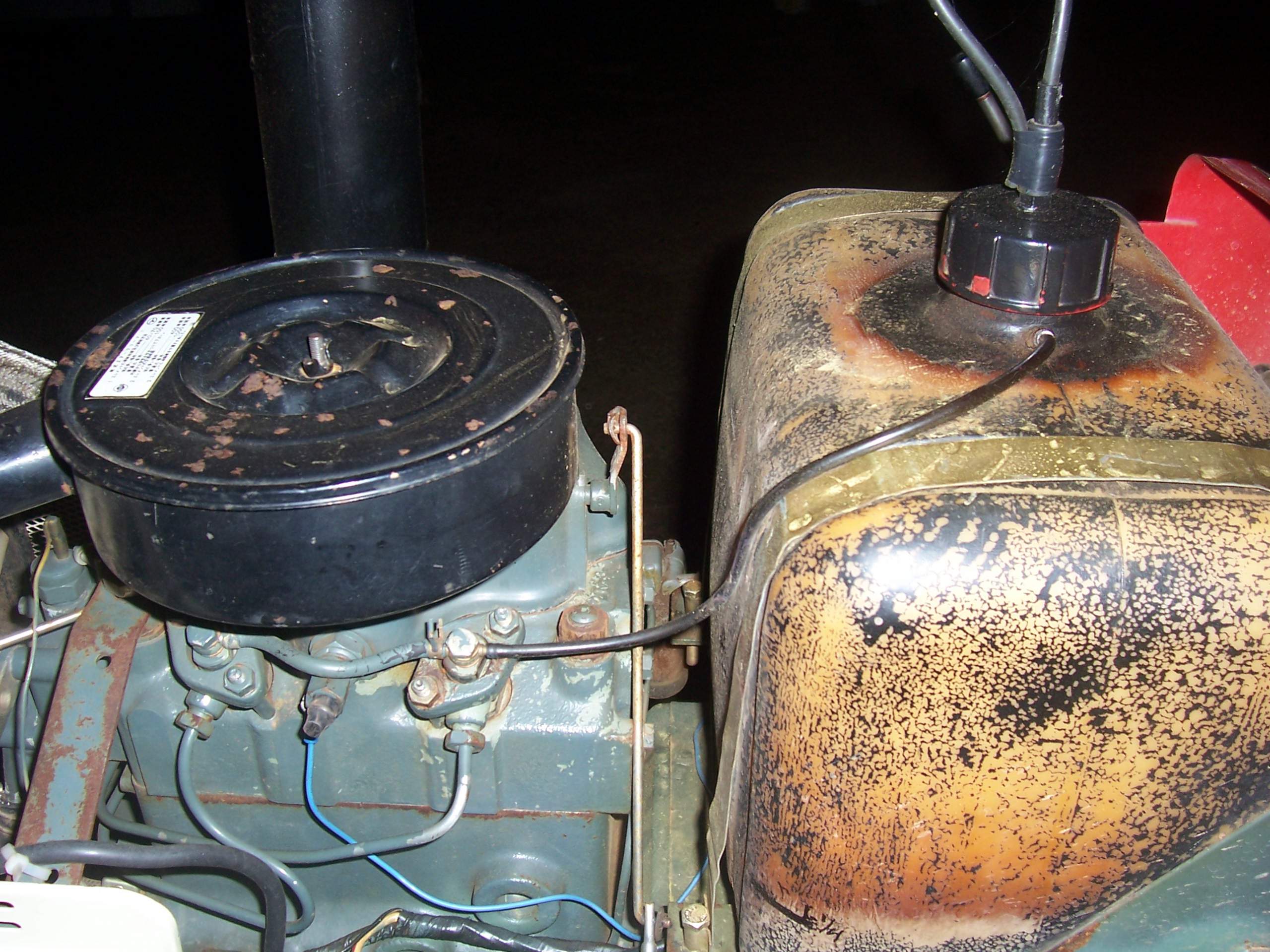

My Tank was getting pressured up and leaking at the Injector Return when it was full or close to full of Fuel. You could actually see the Air Bubbles blowing the fuel out. Didn't like that at all :( I done two things first I used a piece of old Vacume line to seal the return and new if I done that there would be no way for the pressure to escape so the Fuel Cap Ghetto rig. was next. It works great. It's off an old ATV or dirt bike gas tank ;) The Blk. cap on my TS is there just to keep it clean. I Only have to use my TS Rarley and it just takes a secound to add or remove it;)

Carey -- yes, mine looks like the pic you posted. Question for you: What does the fitting on the tank that the hose plugs into look like? Is there a separate fitting or just an opening in the tank?
/ fuel overflow #14
When I bought it was just a hole with the return line Loosely gong into the Tank. All I did was used a piece of vacume hose a Inch or so and Ran the line through it and put it in the hole of the Tank. That plugged it up. You would never know it even looking at the pic. you might now that I told you what to look for ;) Clemsonfor just stated he leaves his cap loose which i new of the Pressure build up problem if the tank is not Vented. Thats why I used the old ATV fitting to prevent that from happening. I actually could see bubbles coming out and then I realised where the Fuel was coming from esp. when it had a full or nearly full tank. I'm From WV. and Ohio and know the Climate and IMHO you need to set up your TS. I can show you my On Cheap setup that works great. One of my Better Ghetto Rigs. Trust me there's some that I not so proud of :laughing: All your expense will be for the Igniter if its not there. If it's not all your have to do is remove the Bolt and screw it in and run power to it which can be done alot of different ways. When I first set mine up I just used a wire straight to the + post on the battery. But when I found out how well it worked you can see I ran it Through my Ign. Switch.

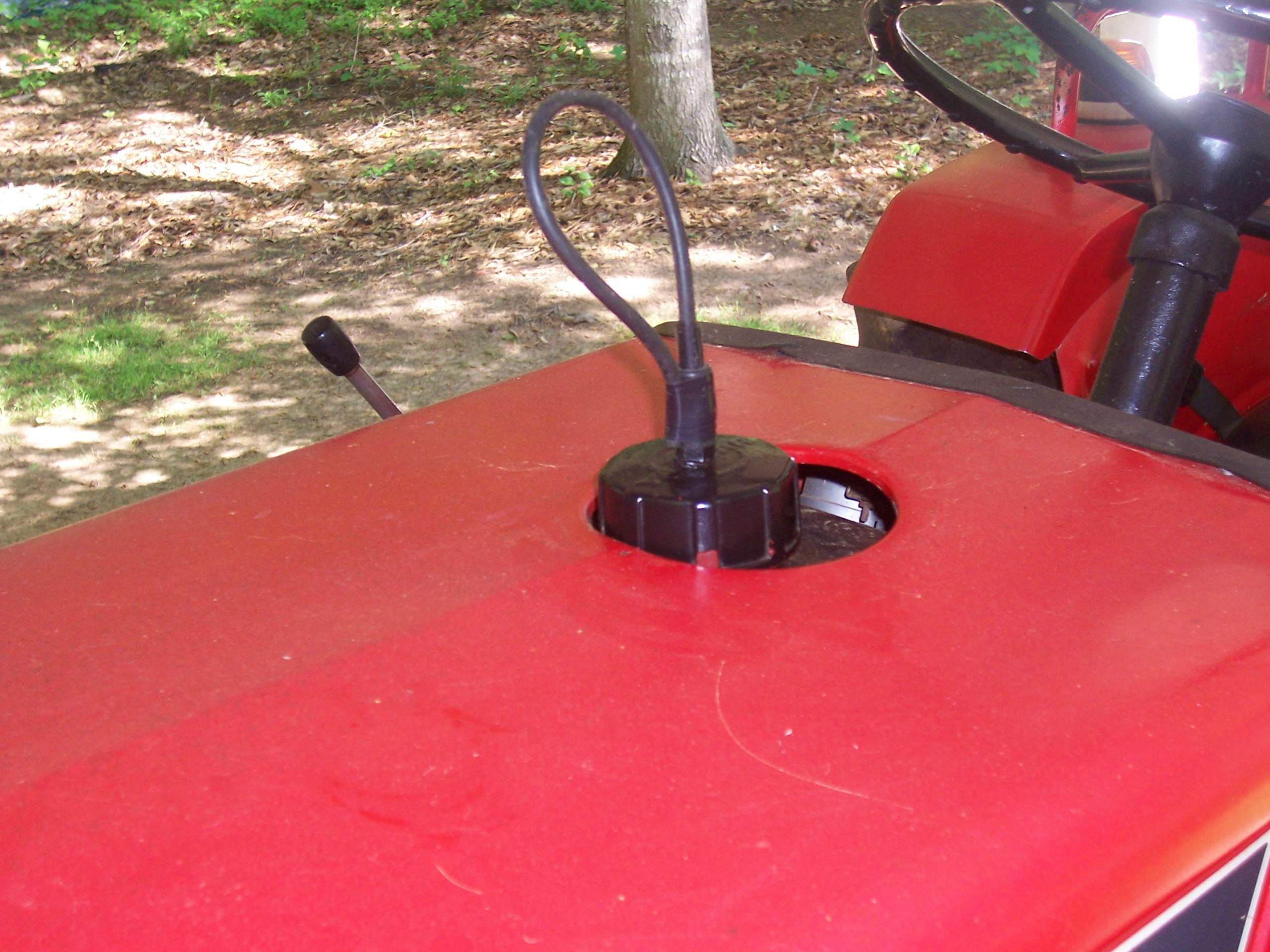

/ fuel overflow #18
Mine was just the opposite it was getting Pressured up. I could actually see the Air bubbles coming from around the return line. Someone else may tighten it up and I didn't want that to happen and added this Vent Tube so it was Quick and easy solution.

Yes, mine is just a hole but had a some random piece of plastic jammed into it. It looked like the plastic piece of a wall anchor that the screw would go into... Anyway, I just pulled that out and fed the overflow tube into that. There's a gap around the tube so no danger of pressurization/depressurization. :)
