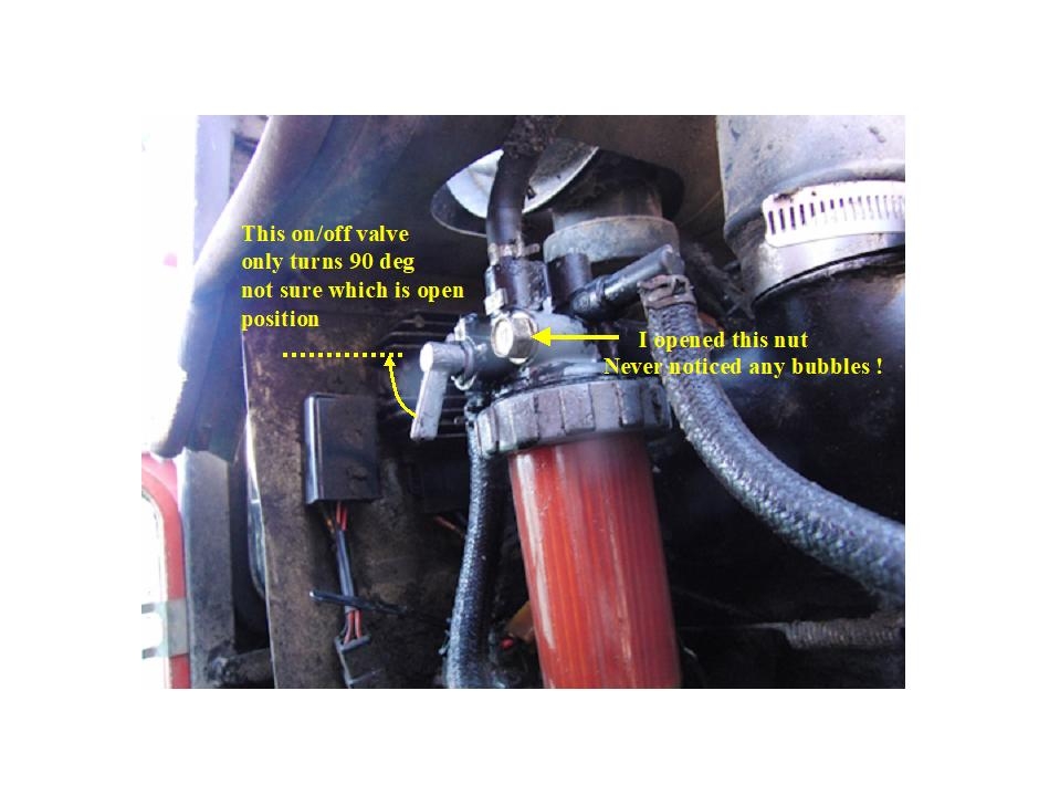

I replaced the fuel filter on my FX28D tractor, and now it doesn't want to start. I've don't the fuel bleeding procedure before, but it has been some time ago and I can't remember much about it.
The pic below shows the filter housing with comments on what I did. The bleed valve may be on the
injector pump - just not sure. I know that the FX series has several different fuel valve housing
configurations, including one with just a small lever to open the fuel line. Does anyone have something similar to the one below ?

I have a YM2310 but the valve you have looks similar to the one on my tractor. Anyway, my son changed the filter, bled everything, and couldn't get the thing to start. I went out and looked at it and the valve handle was UP. So I told him it must be down. He insisted it was UP before he changed the fuel filter. Well, I turned the handle so that it was pointing DOWN and the tractor started right up. So maybe your handle also needs to be pointing down. I hope so, it would make for an easy fix. Good luck.

Pull the line coming out of the valve. Loosen the clamp at the word open in the Pic.. Pull the hose and watch for the fuel to pour out of the filter. If it does then turn it off and bleed the lines. Then you know for sure if your getting fuel to the pump and bleed it again also.
