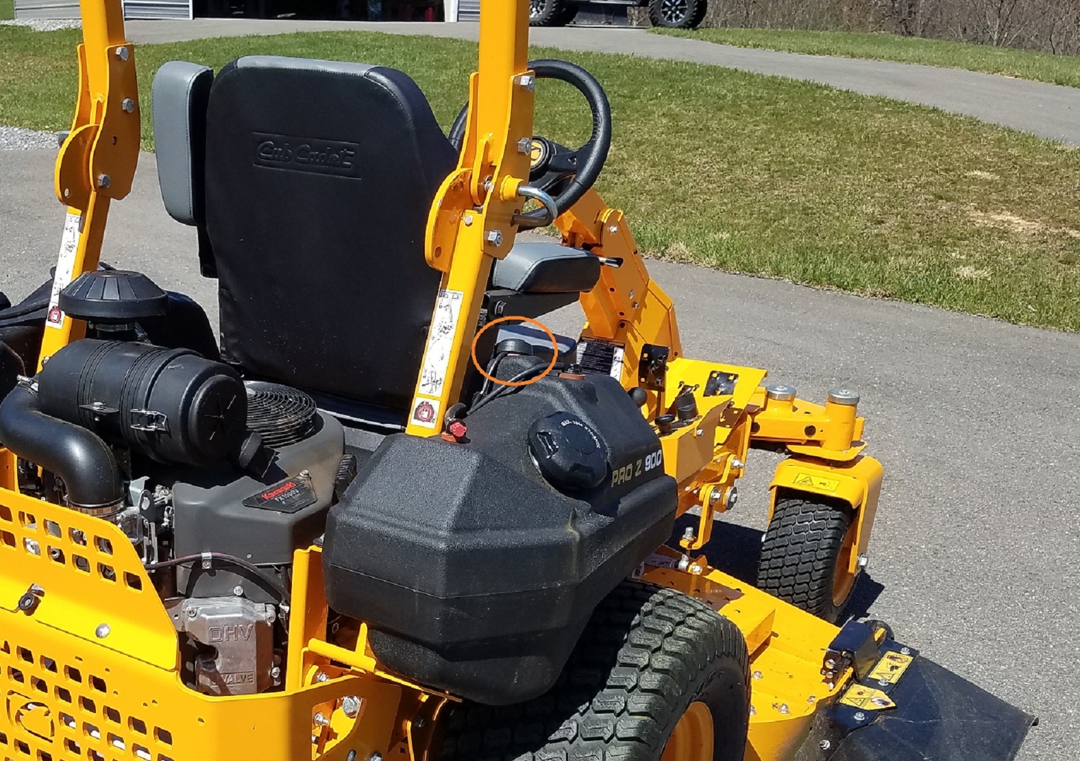

I asked this question on the onlycubcadets forum but I thought I'd check here too.
There is fuel leaking around the circled part which I think is the fuel level sensor. How would I fix this. I can't seem to get it to pry out to check or replace the gasket or grommet. I don't want to pry too hard and break something. I sure could use some advise. 2022 Pro Z 960 S KW.

Could you post a close up photo of the sensor and maybe from several different angles.

Looks like it pries out from grommet part number 735-05171
Item 3
That what I figured but I've pried and pried all around it won't pop loose. I believe the black top is just a plastic cover but it won't pop loose either.
