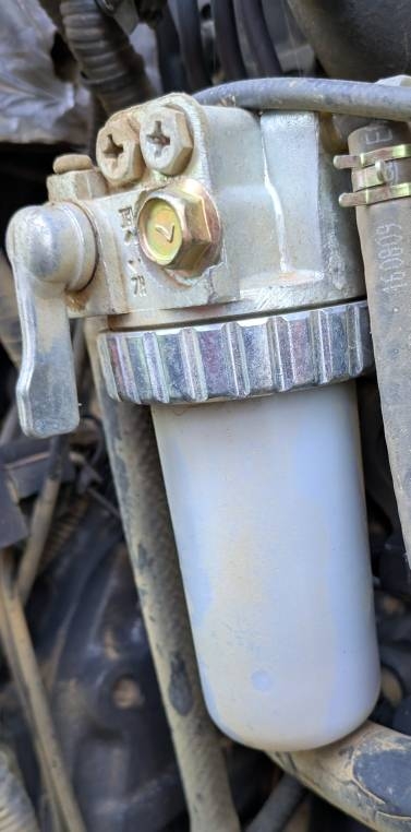

Is there an official "fuel filter wrench"?
Specifically, to fit the Branson 3520h's fuel filter if possible...
/ Fuel filter wrench? #2
In theory, those should come out by hand. In reality, those come super tight from factory.
On mine, which is the same style, I wrapped a rag around the right and used the adjustable pliers to loosening it up. I didn't really wanted to leave any marks on it. Then I just tightened it by hand.
Ok, I've often used channel lock pliers and a glove, I'll give that a go.
Thanks!
It was too snug for my fingers to grab, especially with the poor clearance (I disconnected one fuel hose next to the filter temporarily too), but the pliers broke it free, just needed a hint of movement by the pliers and then I was able to spin it off easily.

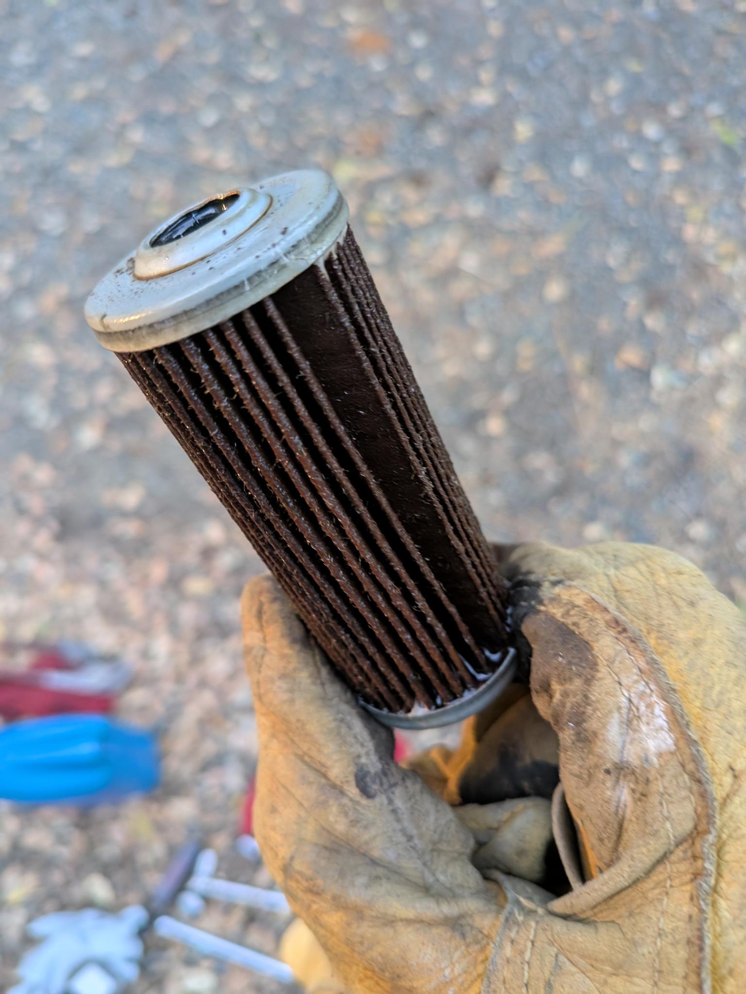

Care to guess how long this filter had been in the tractor? I hadn't noticed any power loss or anything like that, just figured it was a good time to swap it.
/ Fuel filter wrench? #6
I would say not much and honestly, doesn't look too bad. When I did my 250 hours maintenance, I pulled it off to see how it was. Mine looked a bit worse. Almost like it had 800 hours on it or something. The biodiesel residue it leaves in the filter is terrible but not loss in performance at all.
At the time, I just cleared it and blew it with compressed air, like one does with the air filters. I plan on changing it now in the 500 hour service.

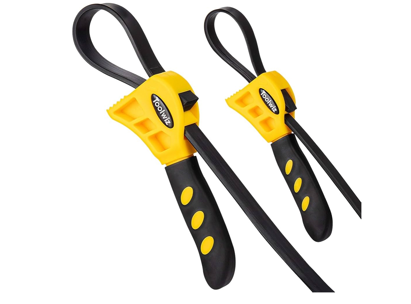

I know you got your filter off, but here is a good tool to have on hand for large things like that:
Looks useful, definitely.
This however is hardly "large", the filter element itself is barely an inch in diameter; the lock ring at the top is probably not quite 3" in diameter.
Still those strap wrenches look nice, I'll look into those.

I'm embarassed to say that while I'd intended to replace the filter a while ago (idk how long I've had the replacement element), this was the first time.
7+ years, 850 hours of operation.

that is what i use strap wrench
