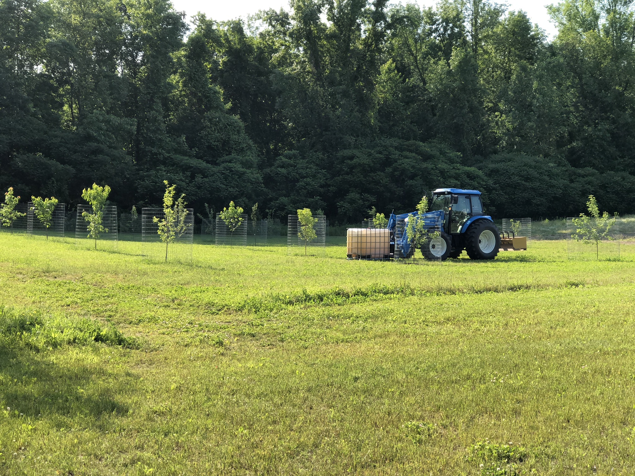

I have used 6 ft no climb horse fence in hoops around trees with success against deer. I had chicken wire and stakes at one property which worked okay for deer but then elk moved in. Elk obliterate the chicken wire wire and chomp trees to the ground. For cattle I use 4 round treated fence posts wrapped in two 2x4s and 4 strands of barb wire. I have some other trees with 8 ft metal fence posts and hot wire around them but that is a pain to maintain.
I use totes for water but with a large tractor to move them full. I fill the totes with two 12V bilge pumps after setting the tote in a creek. I connect the pumps to the tractor battery and the 275 gallon tank is full in 12 minutes.
/ Fruit Trees Planted #24
I use forks to move mine, that could be very exciting full on RTV.....
I put IBC totes cabled on a pallet. Then forks can go much wider for stability. As a side note chain them to the forks as they will slide off very easily being metal on metal if you don't use a pallet as a base. That 4' drop of a full tote devastates them.

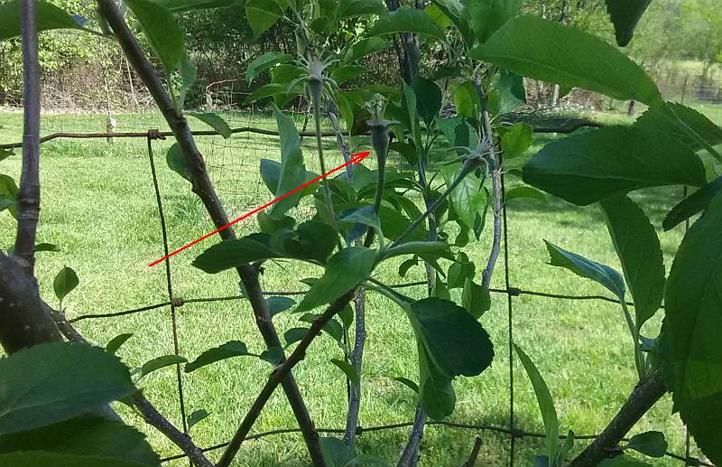

I started my orchard with black drain pipe around the trunks in spite of what the nurseries told me about the heat generated by them but the ants and bugs built nests in there and screwed up the bark something awful. So I I went with 2 loose wraps of the simple 2x4 rectangle square fencing. Green and or galvanized. The bucks leave it alone as many trail cam pics prove and no bugs in the pipes. As the trees grow you never need to change the trunk protection. I have apples, pears, plumbs and crabs. 40 in all. Good Luck with yours. !!
