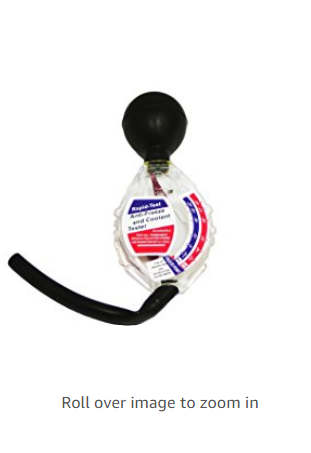

I read that RV antifreeze is supposed to be used full strength, not diluted. But then I never heard of it before either.
The antifreeze we get in Maine is either premixed and you use it full strength or you get it and add water according to the table and how much protection temperature wise you want. 70%antifreeze 30% water is common for cold climates.
I saw this - "Make sure to use an antifreeze hydrometer and not one designed for use with checking the acid content of the fluid in your vehicle's battery. While hydrometers come in a wide variety of styles, the most common have little floating balls within it of varying colors or arrows that point to temperatures on a scale printed directly on the hydrometer that help determine the strength of the coolant solution.
Step 2: Read the hydrometer. To read the hydrometer, check out the number and color of floating balls, or where the arrows point on the freeze point scale printed on the hydrometer."
Collect some of the liquid from the tire in a cup and use the hygrometer to read it - Put the valve 1/2 way from top - press tip of valve needle and collect fluid that comes out.
Amazon.com: ABN Deluxe Antifreeze and Coolant Tester Hydrometer: Automotive

I was looking at these today. They make one for ethylene glycol (regular AF = poison) and one polypropylene glycol (RV AF = nontoxic.).
Note that the one you linked is for the ethylene version. I plan to pick one of the PG versions up today when I go into town.
