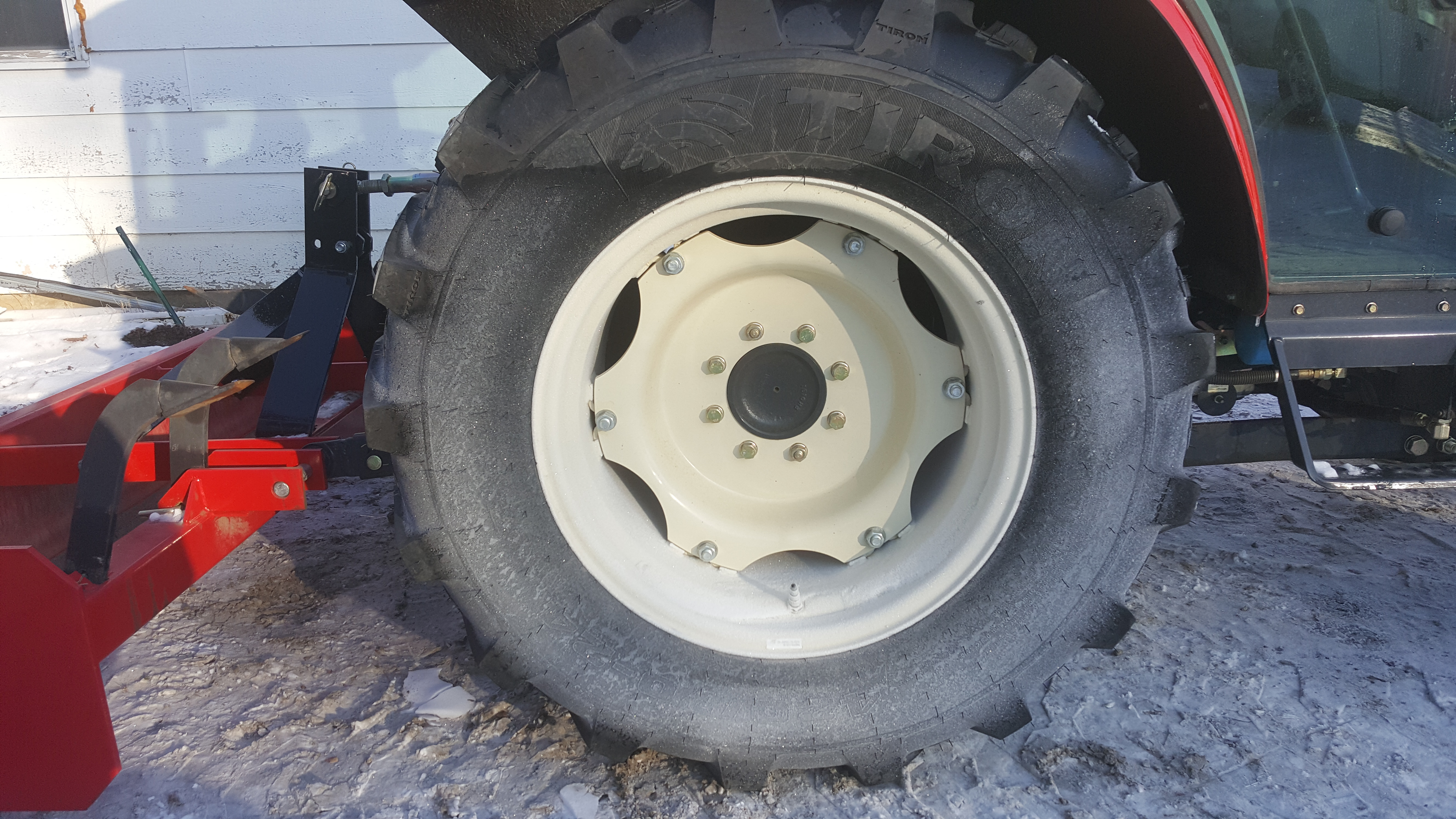

   / Frozen filled tires - how can you tell? #28
Here's a pic I took today about mid day. It's +32 F at the time. You can see the frost line on my tire. These are filled with Rim Guard.
I thought it made an interesting picture.
We're having a freakish warm spell right now, so it's a little bit odd that it was plus 32 today (I think it made it to +36 F, which is unheard of at this time of year).
