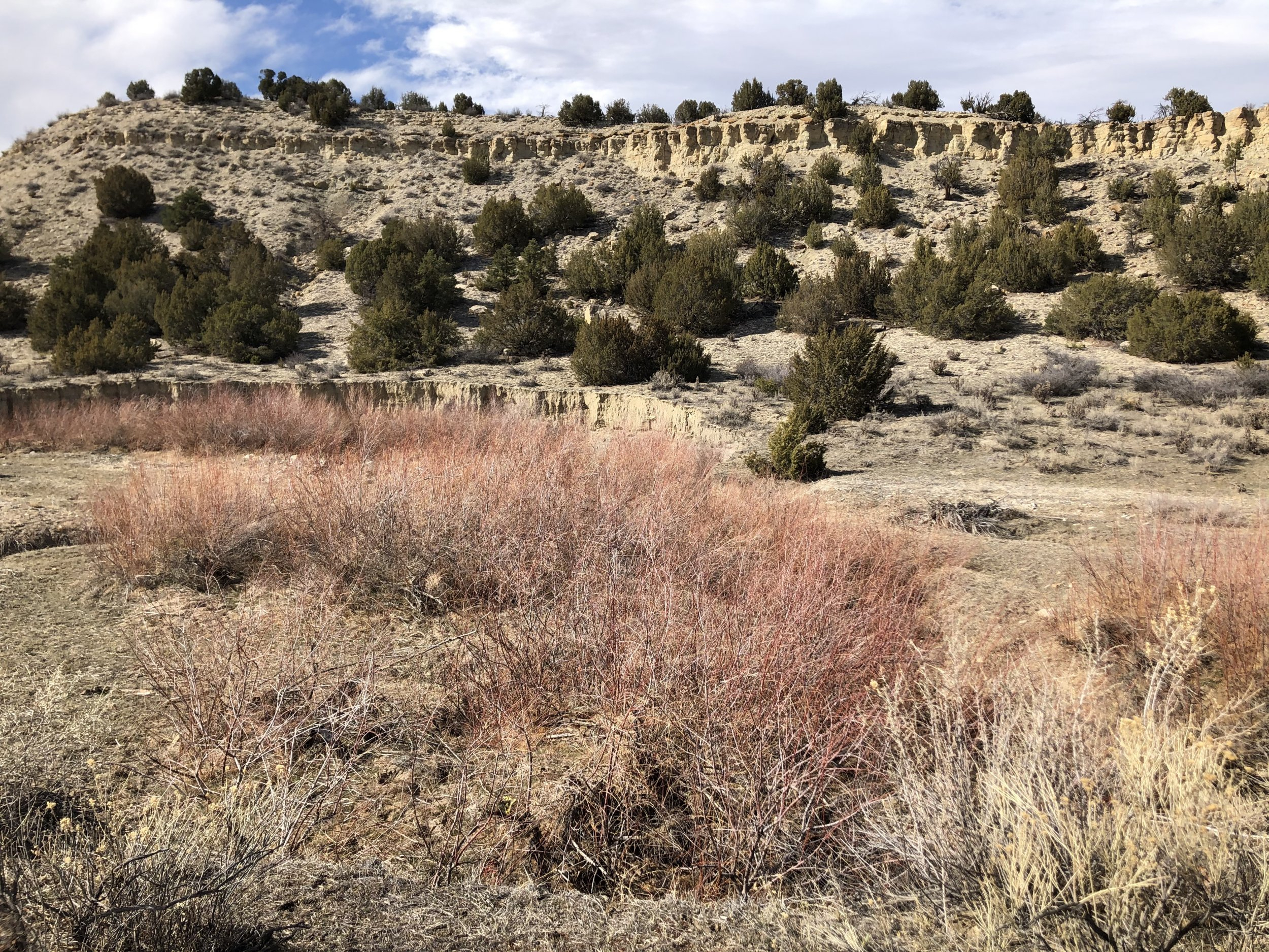

The "ponds" are really depressions that the ravines drain into during heavy rains. They are probably 20-30 feet across at most. The whole place is dry most of the time. I will try to post a picture or two.
It would be great to have a yard full of equipment, but I don't. I am trying to figure out how best to use and take care of the tractor/backhoe I have and do what I can.
This is generally the lay of the land. Junipers, pinion pines and small cactus..

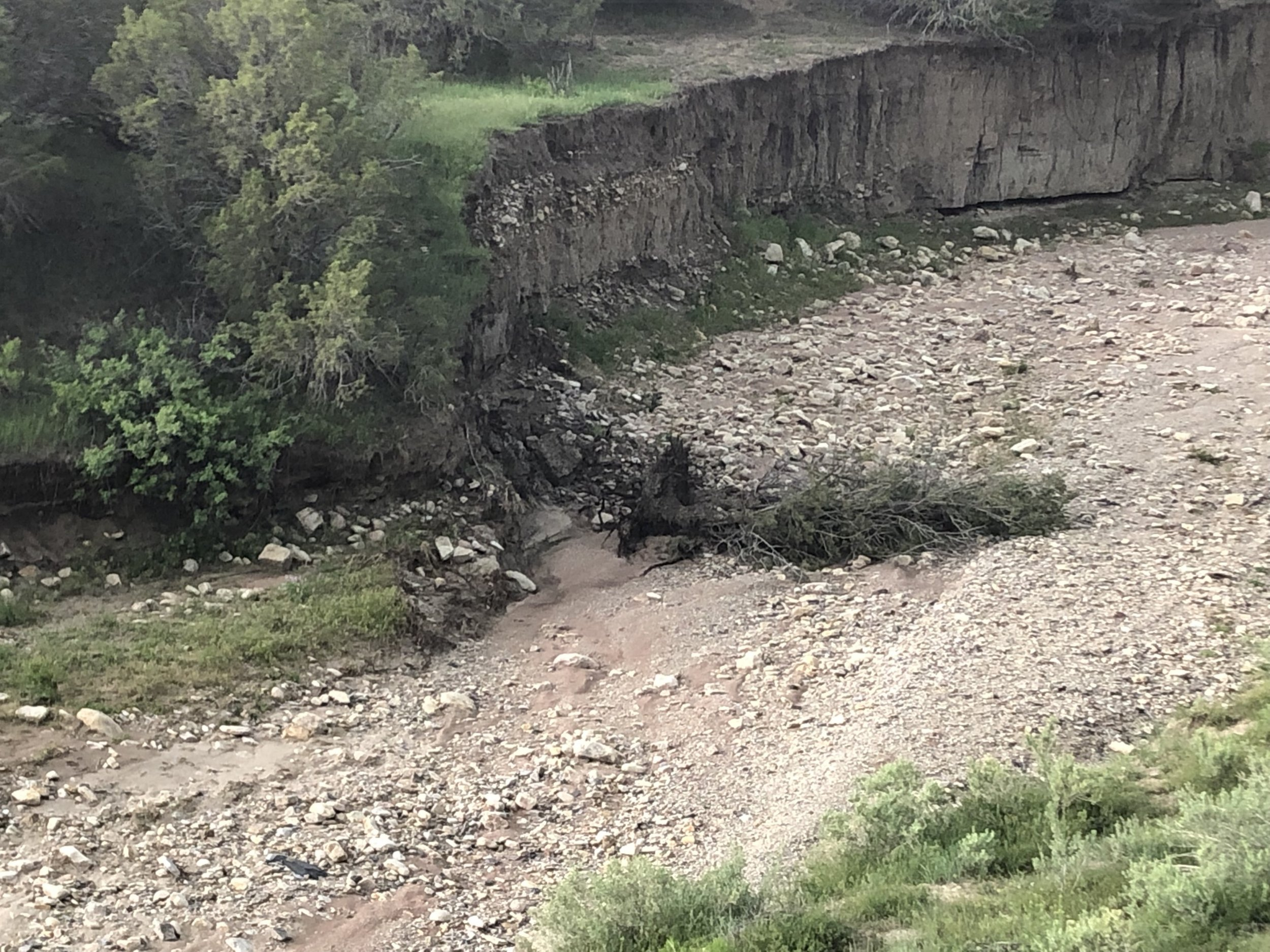

This was after one of the floods and the arroyo had dried back out. The wall of the arroyo is about 25ft tall there.

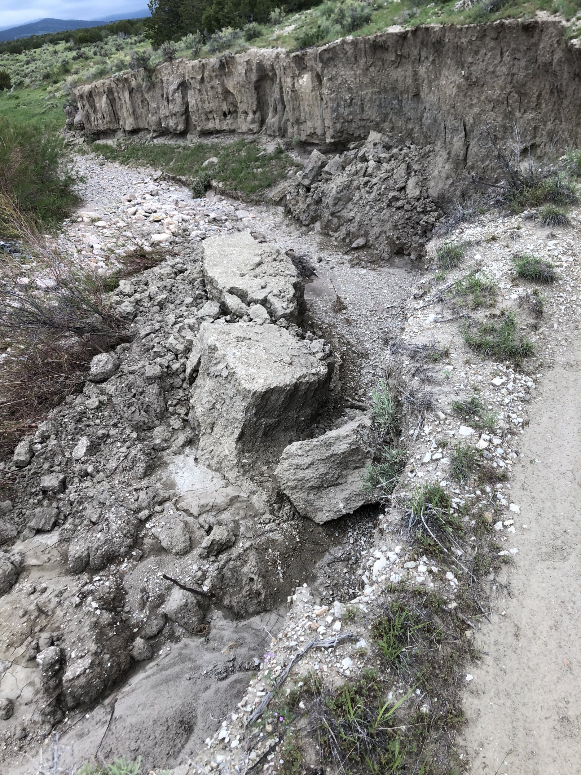

Elsewhere on the property, these 2 chunks of earth are each about the size of my wrangler. They were part of the wall I am standing on prior to the storm. The cow path was across the top of them when they were still attached.
Just including to get some idea of the type of terrain I have. The storms come through a few time a year. Otherwise the place is typically pretty bone dry. More like what you would think of northern NM than what folks picture as Colorado Rockies.
