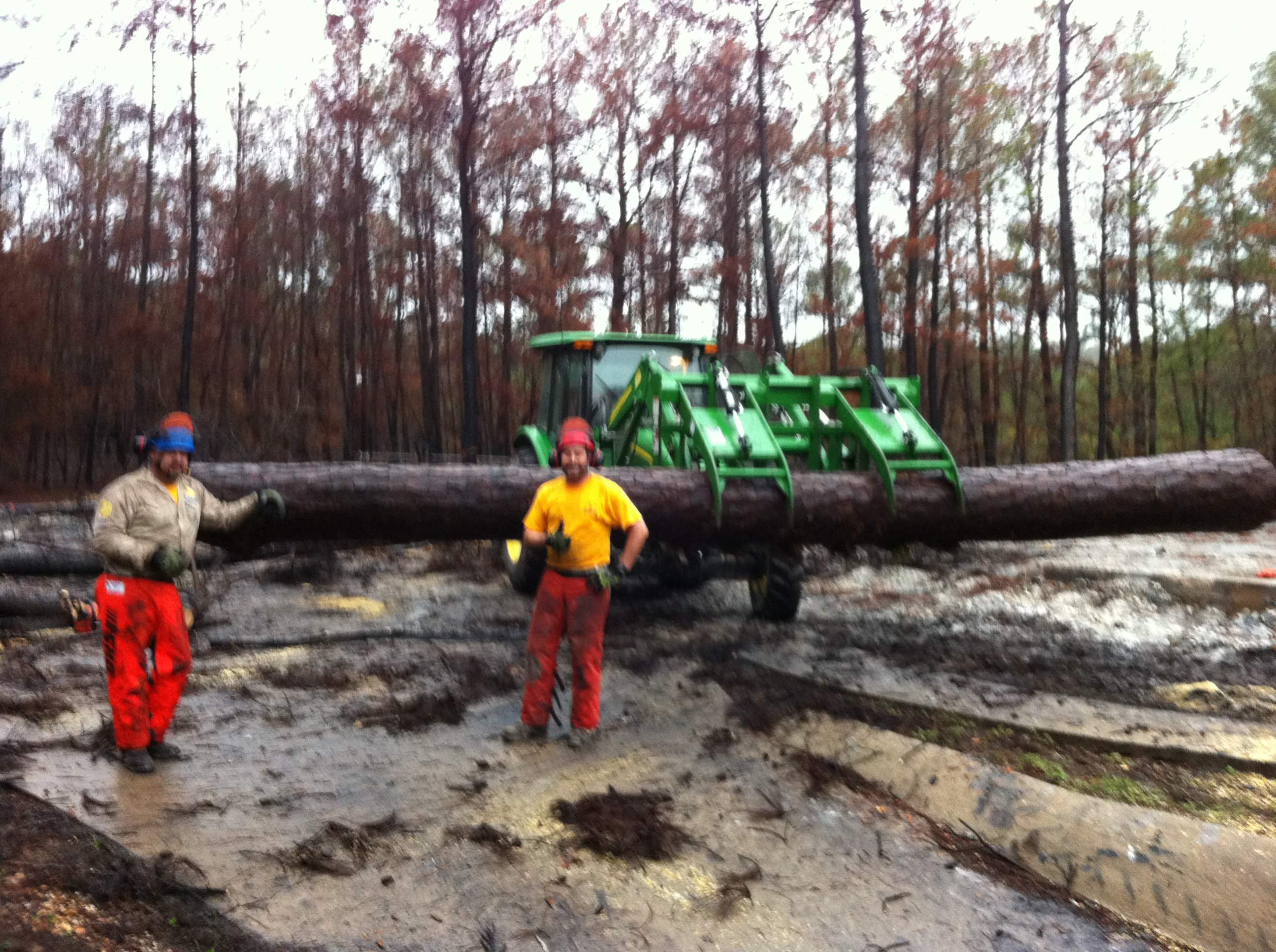

I have the AV20G and also use it with my 10000 lb skidsteer. It is very stout, 950 +/- pounds, and iis till perfectly straight after grubbing out mesquite stumps. The only damage I have done to it is rip off 2 of the replaceable teeth.
