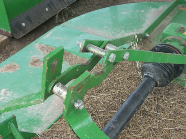

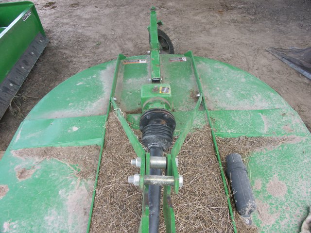

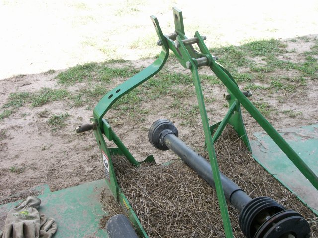

Has anyone out there purchased a RC2072 within the past year - year and a half that they are very happy with the dourability of the 3-point hitch? Since several people have posted that they are very happy with their RC2060s I'm wondering if the RC2072 is the only model impacted by the weak steel shipment... If that is the problem.
Another thought that I had was that if my dealer had virtually all of the RC2072s purchased within the last year and a half come back with bent 3point hitches that they may have assembled them incorrectly and overtorqued the bolts or forgot to install a small bushing, etc so that the top link cannot "float."

That ^^^^^ could be the problem. If it can't "Float", it would twist it when you went on uneven ground. I know my 2060 floats, because I watch it on uneven stuff just to see how that linkage works. :thumbsup:
Hope you get that MX series for Free! :D
Perhaps there is a parts manual that shows the assembly? (would be nice to have an assembly manual)
