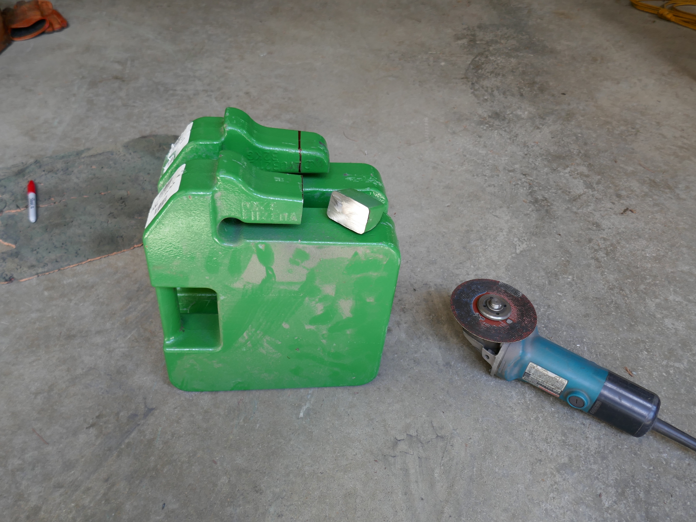

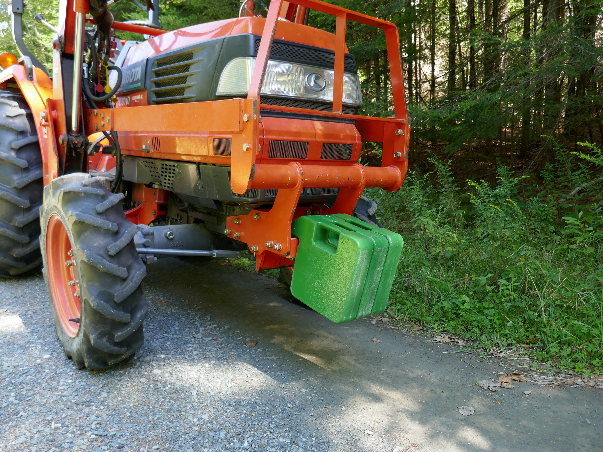

I have a L3010 Kubota I wanted weights for. Kubota dealers near me ( 2 of them with in an Hr drive) were not interested in helping. The JD dealer had 3 sizes in stock - 110 lb, 70 lb, and 42 lb. I wanted about 200 lbs so I bought 3 - 70's. Had to modify slightly to go on the tractor weight rack. They cut like butter with a .040 disc. The local Home Depot also carries the 42's.
Just couldn't stand the green :)
I put 150lbs worth of weights like that on my previous B8200 to keep the front end down when lifting a 3 point mower.
Keeping them JD green would have looked goofy!
