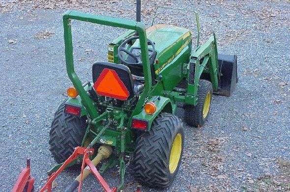

I've got the 770's little brother, the 670. This machine has 19 Gross HP, ~ 16.5@ the PTO.
One tough little tractor!! I'd love to have that 770's dual stage clutch and 20 PTO HP though.
Problem is, these little machines really hold their value!

About a year ago, I looked at a '99 4300 sync shift. Nice tractor!! Now, this was an online love affair, y'know... And, although the price was right ($14.2K) and 480 hours, I just waited too long to make up my mind. It would have been a 6 hour drive to go see it.
Anyway, buddy of mine just traded an 855 (always thought they were bigger then my 670) in on a new 4310 eHydro. So, went to drool over his new machine (although, I'd of gone for the gears)...wow! what would I have done with such a big machine on my 3 acres!!!
But, ...with 8 to 10 acres..and although I love that 770 and 90 series machine...I'd have to look seriously at the 4310 (or, best of both worlds..990!)
