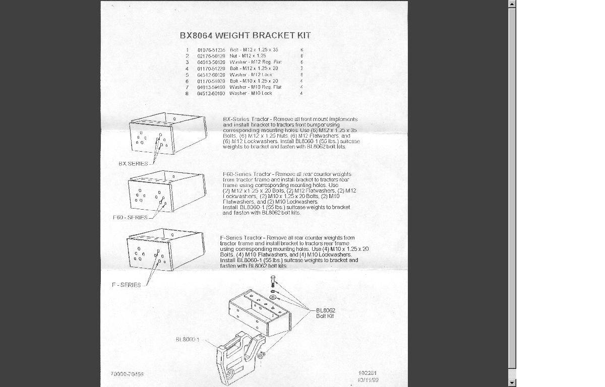

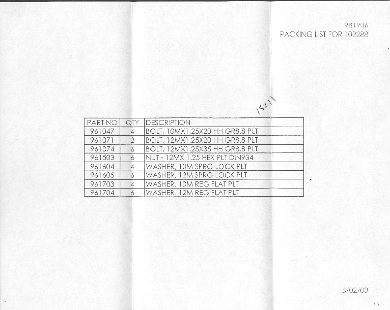

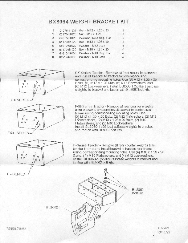

ok, i know i have posted this before but i need a picture of the front weight bracket for the kubota bx2200 and a price
/ front weight bracket #2
I don't have a picture of the bracket, but, I can tell You It is $95.00 plus the bolt kit, Which was priced to me at $6.00 per ($6.00 X 5)weight. The weights were priced at $60.00 each (5 Total)

See If this doesn't answer the question.

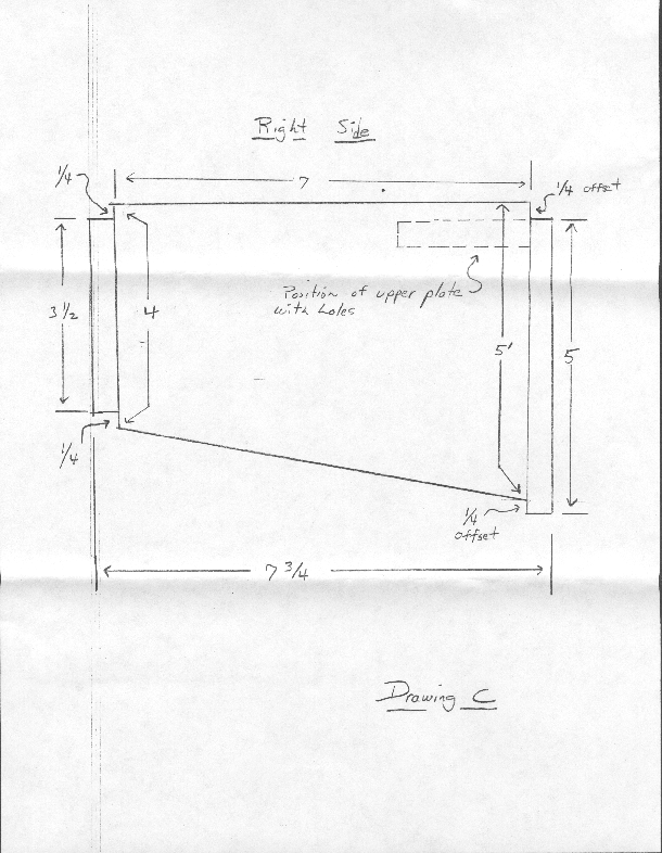

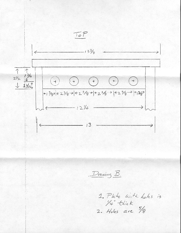

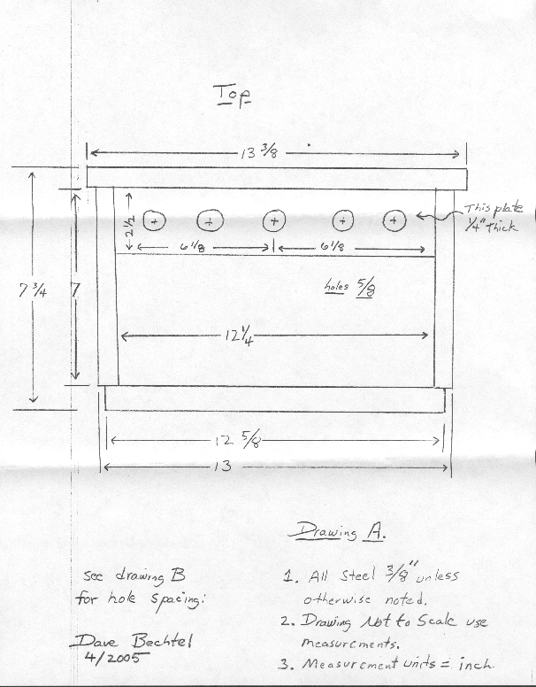

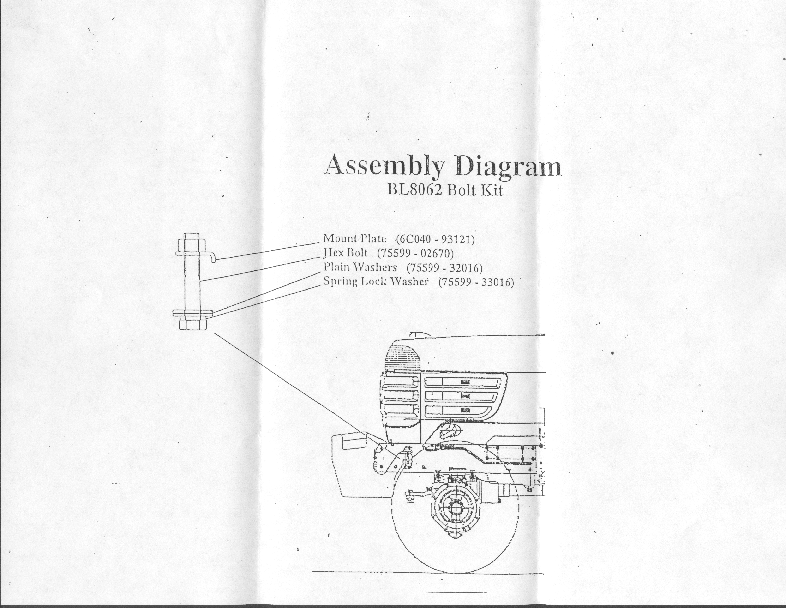

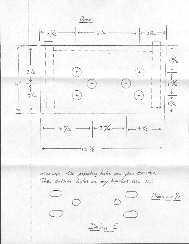

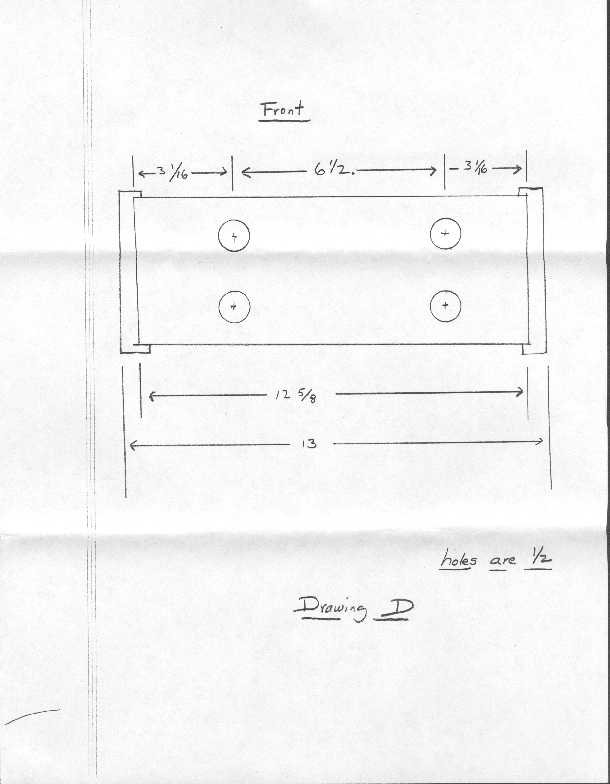

here is a series of pics from RiverV:
#12
thanks for the pictures im sure i can make it im going to go draw it now
/ front weight bracket #13
Very handy to have. I made mine without this knowledge but adapted construction so I can use the Ford skidsteer weights I already have. Will also use kbota weights if I ever find any used.
