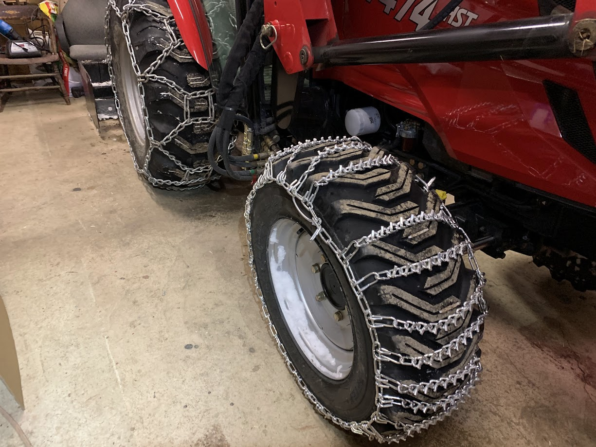

Has anyone put tire chains on front tires only for snow/ice ?

Thanks have rear tires loaded and I was looking for little traction in front thinking of going with inverted blower (rear mounted) without going to spacers for rear tires it does great for having only loaded tires we have alot of ice and snow in maine
/ Front tire chains (tym t474c) #4
I used front only chains on a John Deere 110TLB for close to 20 years. Worked fine.
Use the least aggressive ladder chains you can find. And be GENTLE!!!! The front driveline was not built to do this.The added front traction can damage the tractor.

I am certainly not a fan of front chains only, for several reasons.
Any type of chain is going to effectivly increase the loaded radius of the tire,
this will result in increasing the lead of the front axle and the load of it.
Ladder chains will result in a slip grip situation which amounts to a constant yanking and bouncing
in the front axle.
Ladder chains will also create a rough ride on any hard surface, with a constant rhythmic jaring and thumping.
This hard surface can be frozen ground or even hard ice.
The studded Euro style patterned style chain will smooth out the ride and provide a constant smooth power
flow and ride, they will increase the rolling circumference like any chain and result in more lead from the front end.
I can see the increased tire rolling circumference quite easily on my dirt driveway and the differences in rear only
or front and rear chains
/ Front tire chains (tym t474c) #7
Yes I have double ladder chains for my for my front wheels R4's.
Make sure to put on a good spider as the chains do walk. On my machine the chains come very close to the steering mechanisms.
I studded all four tires last year and left my chains hanging on the wall. Search my posts for pics on the studs. For me studs are the way to go.

I have chains on all four tires since I use a blade on FEL. And have a hilly driveway, I need max trax.
