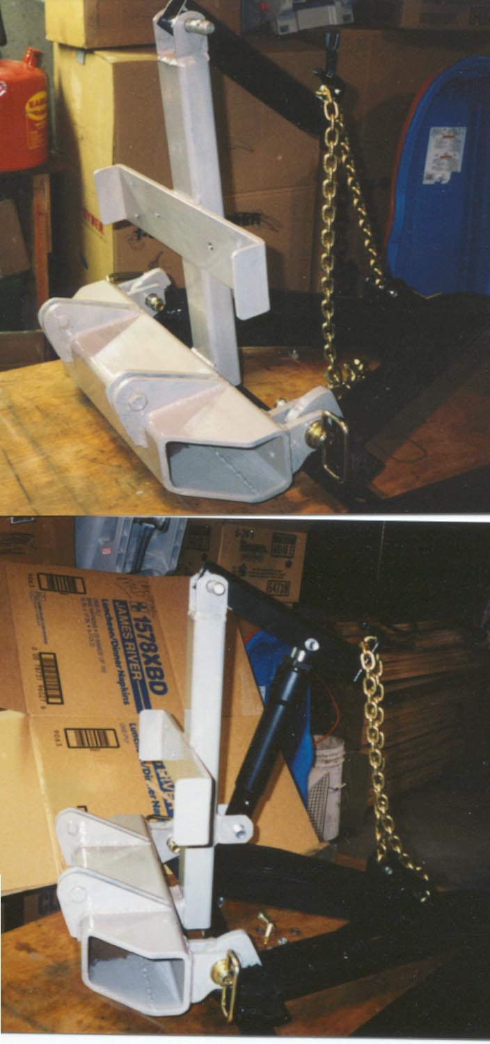

I used a six and a half foot Meyers poly plow in a FEL mount on my TC33D. Had the mount system made by my welder, two pins and back away that equaled about fifteen seconds to unhook and about a minute to hook up. The unit was manual angle. I used this unit to plow 3.5 miles of roadway in my development without any problem to the FEL arms or mounting system. She would roll snow in High range ( low MPH ) with no problem. Cut down on my time by more then half compaired to using seven foot rear blade and bucket. We live in the sticks so we have no curbs to worry about but I would be aware if I had any on our roadways. Good luck. Bigguy ( AKA Scaper)
/ front snowplows #28
Had a pm request for locating this thread showing the pics of the front mount Western plow. To help, I'll post and bring it forward.
