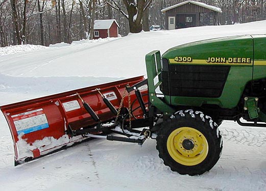

hermit
I have a plow on the front, but not attached to the loader. It quicktach's to the mmm brackets and the weight bracket. Works like a charm, and is quick to remove, for the switch to the FEL if needed to bucket snow or something else.

I had the quicktach hitch fabricated for around $200, and purchased the Western plow parts new. There could be some cost shaving if shopping around for a used blade. I'll attach a pic of the quicktach hitch taken when the primer paint was on, along with some of the plow parts. Its one of several options you have.

Beenthere:
Thanks for the info and the pictures, will have to explore this option some more. Looks like a real slick setup. We've had a dry winter so far here in N.W. Montana but is trying to catch up in the last 2 days.

Beenthere,
Nice looking frontblade! From your picture I can't quite tell...do you have one or two cylinders to angle your blade left to right?
I do see that you have a couple cylinders to adjust front to back tilt of the blade. Do you use that function much?

OkieG
This is a conventional Western plow with two one-way cylinders to angle the blade (one on each side). Also, there are no cylinders to tilt the blade back and forth, as what you see (I had to go back and look at the pick) are actually the springs that are used to let the plow trip. Now your thought that they might be cylinders certainly brings up an interesting option. In years past, if I want to tip the blade a bit (digs into the ice better because the worn edge then digs into the ice) I just put wedges in to do do that.
This blade is not bad for grading dirt, although it is not easy to keep the blade from tripping, unless one would fashion something (like hyd. cylinders or chains) to keep the blade from tilting forward. Keep us posted on how your blade develops.
