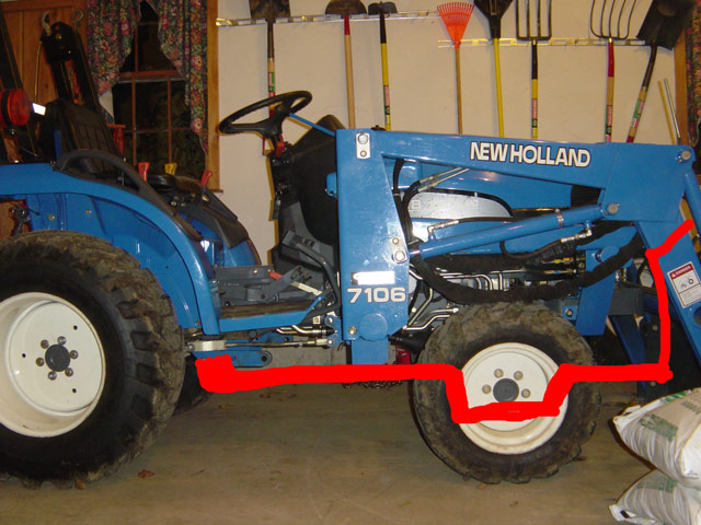

Time to revive this old thread. Yes it is many months later. I cut the steel, but my buddy never got a chance to weld it up.
One thing that has concerned me with my design is stressing the front of the tractor frame. I did a little homework (thanks Jason & Spencer200) and came up with how New Holland Does it.
Attached is the New Holland Parts Diagram for their plow & frame. Item 40 attaches where the MMM bracket is. Item 41 is the bracket. Item 37 interferes with the loader mounst & will be skipped.

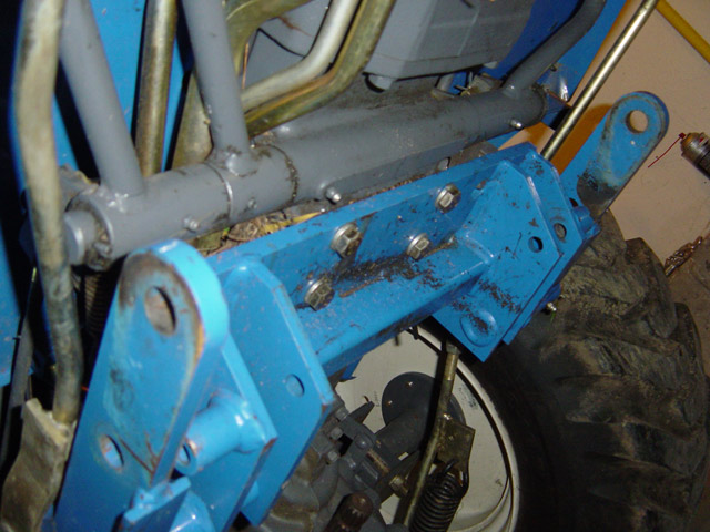

Here is a pic of the MMM bracket. It will be removed for the season.

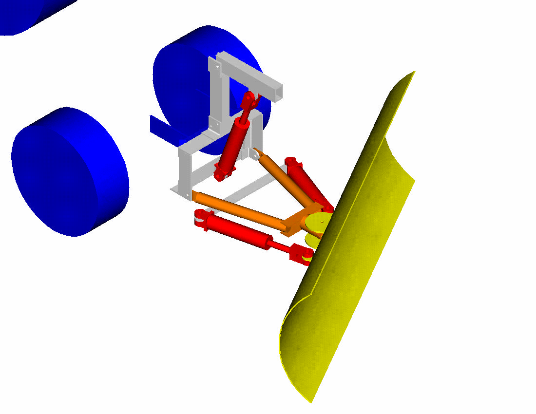

#47
Here is a sketch of the under tractor bracket. Haven't laid it out yet in CAD. But will soon.
/ Front snowplow bracket help
#48
I may have to re-consider my quadrant design. I think I want to be able to take the top part off with a pin, so that it is quick-detach should I want to use the FEL.
