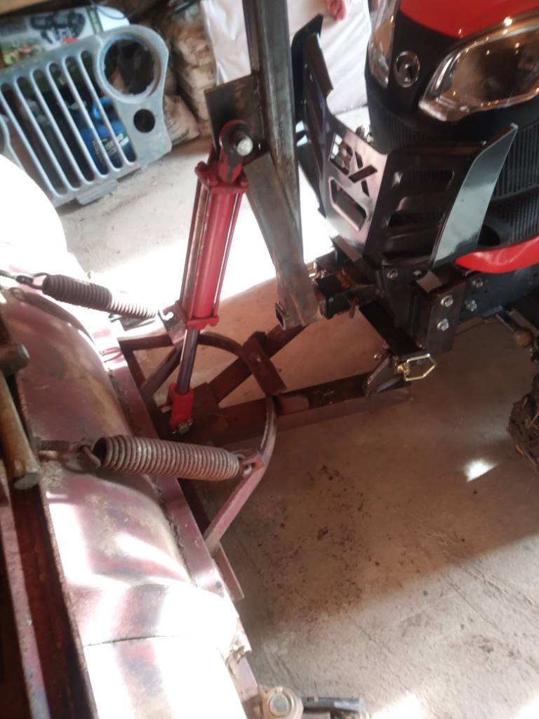

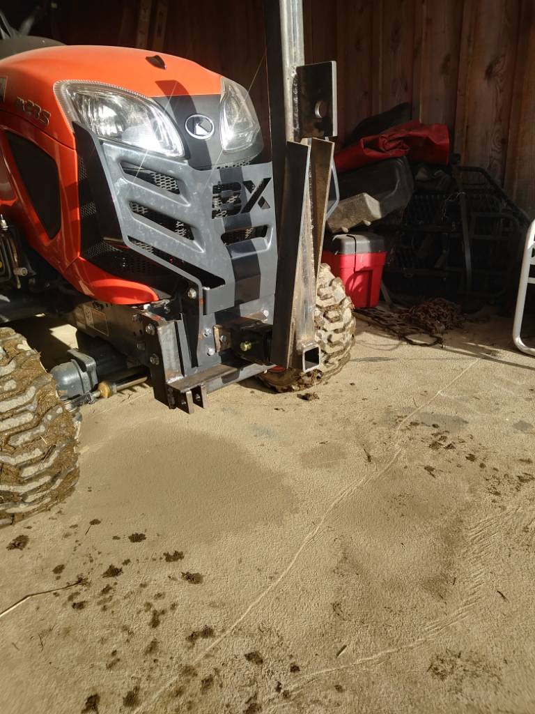

I recently fabricated a mount for my Kubota BX most sub compacts should be similar. I used a 6ft jeep plow and lift Is off the loader hyds. I'm not finished I have to add power angle, and auxiliary lighting . 1219181354_HDR.jpeg1219181355_HDR.jpeg1219181414.jpeg

That kubota is basically the same setup as my Kioti except i made the tractor attachment. I have power angle on mine I actually gave 1200 for my plow new never used and then fab it to the tractor. The dealer wanted me to use the loader arms which would have taken another hyd port and I did not like the over hang out the front. good job on the kubota
   / Front snow blade, worried about tractor damage #45
The mount on the machine is home built and can stay on the machine permanently, I shortened the plow A frame to keep the plow as close to the machine as possible. Before doing all this I mocked up a clamp on blade just to see what that would be like and the first thing I didn't like was the distance it was away from the front axle. My thought was the further out from the axle the more leverage I was giving to the snow to push the machine sideways.

I know what your saying with various clearance issues. I have the A frame out just far enough so there is no contact with the tire and blade at full angle and the lift pole is out just far enough that I can open the grill guard and hood without removal. The setup is not as fancy as Kubota but it works and costs a whole pile less.

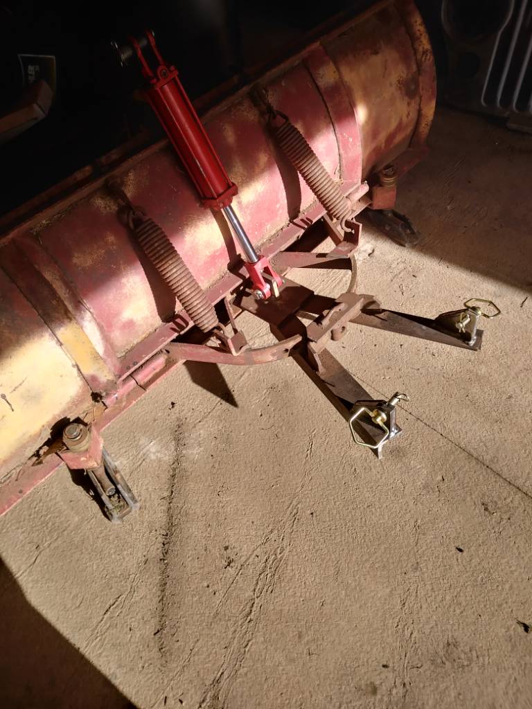

I'm working up one now. Bought an old Massey so I could leave the back hoe on the Kioti, and who doesn't need another tractor??plowframewelding.jpg
   / Front snow blade, worried about tractor damage #49
Looks like a good job, I have a 3 X 8 cylinder which is way bigger than needed, But I used what I had, a 2 inch would have worked and would have been faster
   / Front snow blade, worried about tractor damage #50
With a 3" cylinder you should be able to use it as a hoist in the summer.
