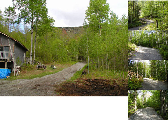

I am looking into buying a snowblower for my Kioti 30HP tractor. I haved searched the forums and there is alot of info on rear PTO blowers but not much on front mounted blowers. I have about 1500' of driveway I will be cleaning and think doing it in reverse will be a tough job. My questions are.... how are the front mount vs the rear PTO type, will a 30HP tractor with a 12GPM pump handle a front mounted unit and has anyone had any experience with the front mounted type? Thanks in advance.

Thanks for the input. I went to Erskine website and liked what I saw. I will contact them after the holidays. I know that I am giving up the FEL with the front mounted blower but I think my driveway is going to be a pain to clear in reverse. I'll have to compare prices and maybe I can find someone with the rear mounted blower that I can try out. Here are a couple of pics to give you an idea of what I'll be clearing.

That is certainly a healthy stretch of driveway. Also, what it appears that you don't have to deal with (but I do) is a cul-de-sac at the end where the town plow piles everything up. After a major storm, the pile of snowplow-compacted snow at the end of my road (and frequently right in front of our driveway) can be 4-8' high.
Although I have sufficient power to just drill into it with the blower I think that damage to the chute would result eventually, so I remove (or push back) everything above about 2 1/2' that has already been compacted, with the FEL before usng the blower on what remains and on everything that has not been compacted.
Since I frequently need to use the FEL, a front-mounted blower wouldn't work for me. Come to think of it, maybe I am just rationalizing not minding backing up. /forums/images/graemlins/wink.gif
