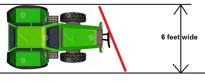

I will just come out with it and state right here that I suck at math... This question is directed toward those with slide rules in their pockets and geometric thought patterns.
I have a Mahindra 4025 4X4 that I want to install a quick attach snow blade with manual angle adjustment.
How wide should the blade be to allow for angle plowing and not have the tractor's front tires climb up on the snow? The tractor is six feet wide so I know that the blade has to be wider than that in order to angle plow. How wide should it be?

whats the max angle of the blade?
/ Front mounted snow blade #3
Taking a big assumption that the blade will angle 30 degrees, you would need an 83.1 inch wide blade. Or about 7 feet wide. Here is how i found that.

From company to company the max angle of a snow blade will be between 25 and 35 degrees. If you go to HLA SNOW and look at their 2000 series snowblades (which would probably be the right weight for your tractor) you'd find that a 84" blade would clear 69" at full angle (35 degrees) and a 90" blade would clear 74". So most likely a 7' - 8' plow would be right for your tractor. I love my 78" series 2000 snow blade on my 37 hp Boomer 37 Cab Hst.

As I recall, my tractor is 78" wide. A 96" wide plow is a good fit as it plows wider than my tires when angled all the way allowing me to windrow snow off to the side of whatever I'm plowing without getting into trees and tree branches with my tractor and cab.

7.5' at such angle should allow back tires not to ride upon snow bank 8' plow would be better tho... I use 7.5' on my Kubota.

Thanks to all for taking the time to reply.
It appears a 7 (or 8 footer) is in my immediate future. Got a bit more snow here last night - which will provide the necessary incentive....

I'd go 8' on a snow blade for that weight tractor, unless you have a narrow door or something to deal with.
