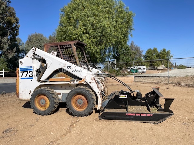

Am I crazy for thinking I'll be fine wearing a motorcycle helmet while using this on the front of my mx 5200?
We have the 6' wide version and a pto hydraulic pump and typically I use it with a cab tractor...
But motorcycle helmet and maybe a heavy chest rig set up and I feel like this would be fine. I'm not hogging gravel piles, just privet.

I use one like that on the open cab skid steer. The only danger is out in front of it.

Motorcycle helmet face shield won’t protect your face and eyes from any significant impact
/ Front mounted brush cutter with open cab #4
If you use the mower on the ground it’s pretty safe. Don’t lift it off the ground to cut overhead limbs. I’ve slammed the skid steer cab pretty hard doing that.

I'd suggest getting a forestry helmet with a face shield. That's what I wear when using a front cutter on an open cab.

Our local Bobcat dealer rents out machines with front bush hogs. I asked how the front glass holds up. His reply, they don't run doors.
I don't know for sure, but would think that practice would end with the first reported injury. That was about a year ago.

I used to think these were great. I launched a rock with mine that took out a cab lower window. I was lucky, my neighbor launched a t-post through the door of his bobcat nicking his right shoulder. I now run a flail mower instead.

Not quite the same, but I gave up using the offset articulating flail on my open station MX5800. Even with helmet, face shield and heavy clothing, I didn't feel safe. I got hit with too much debris that bounced off trees, rocks and the ground.
Even the cab of the L6060 gets pelted. Haven't broken any glass yet though:
