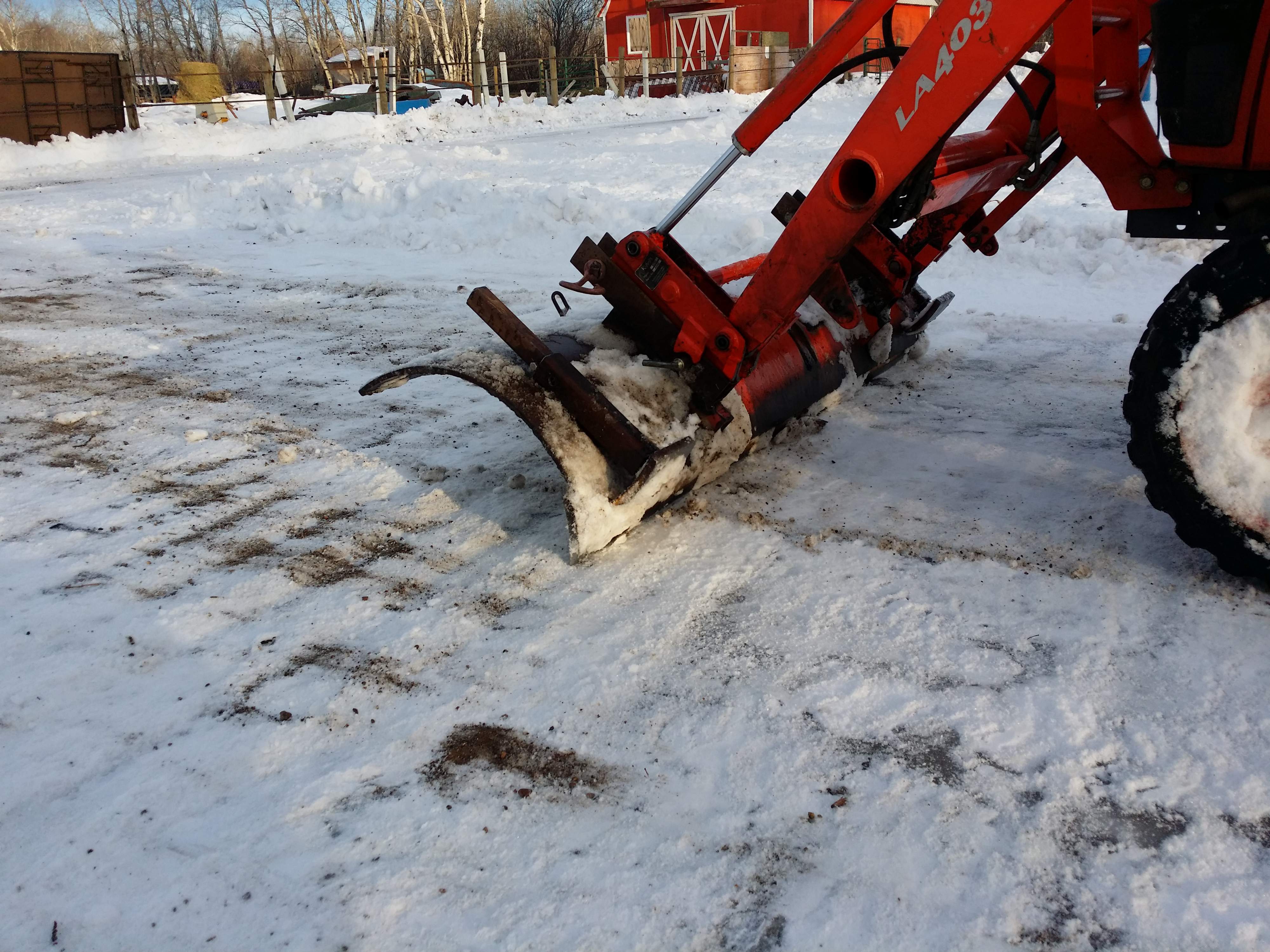

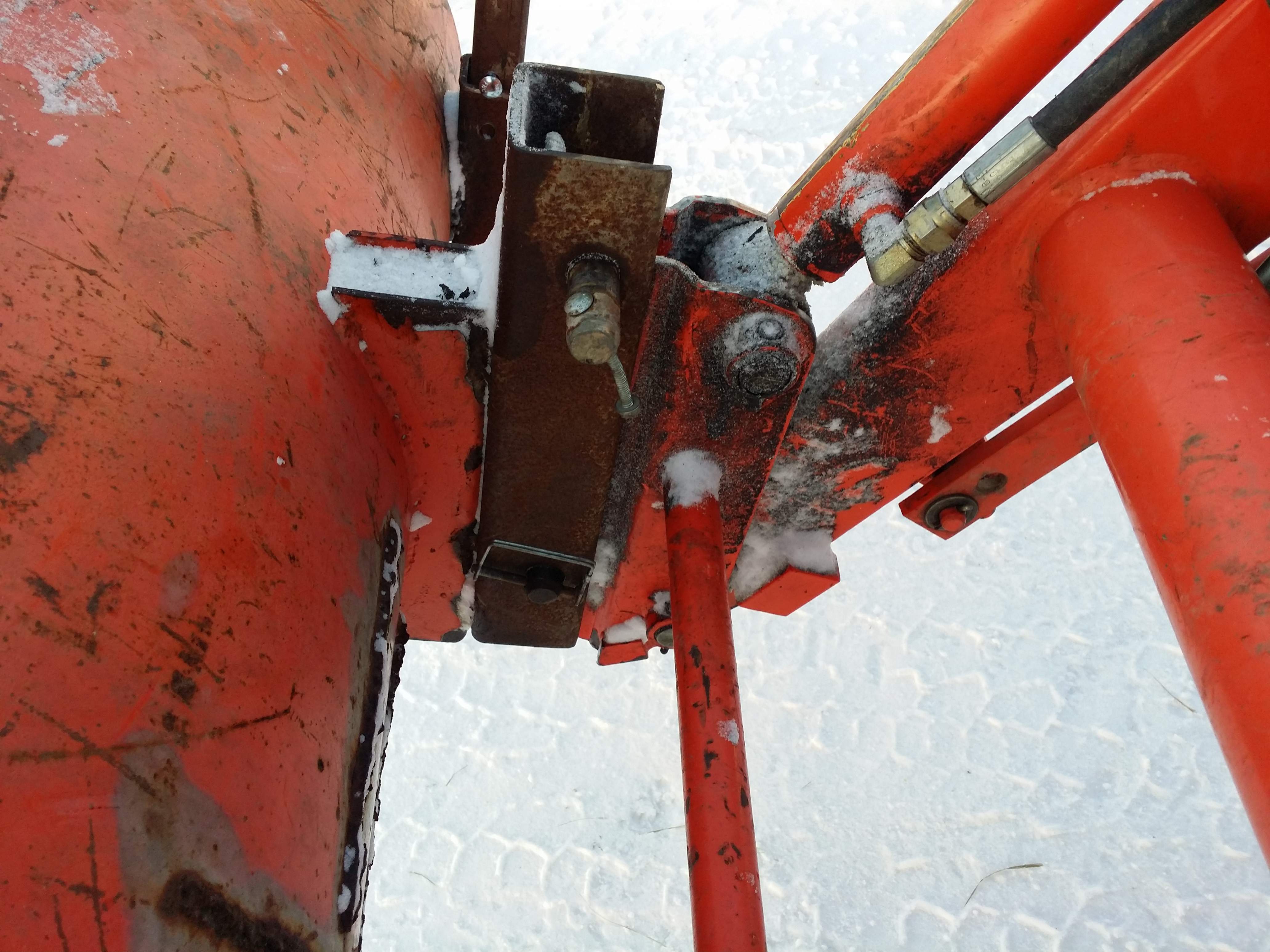

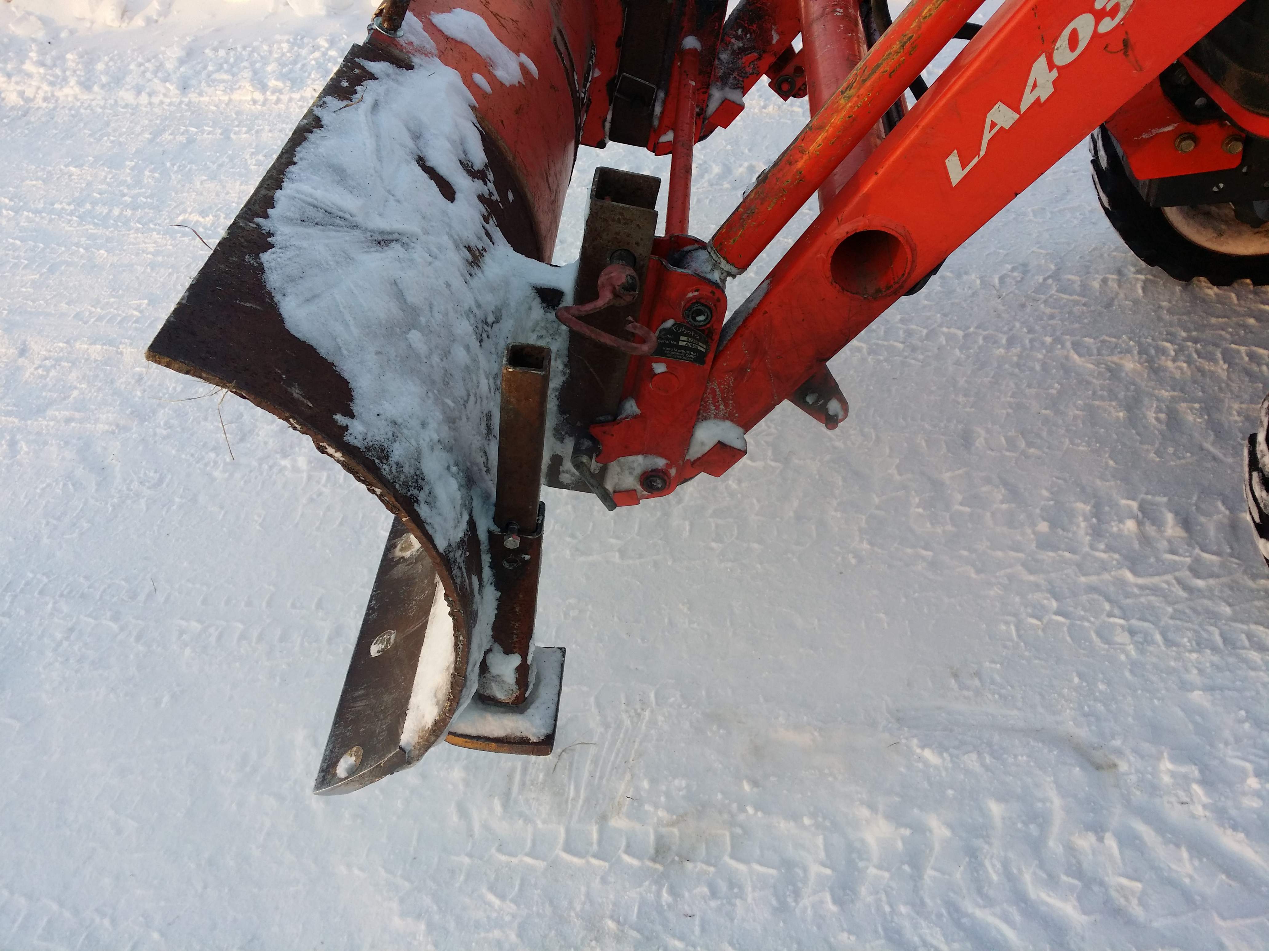

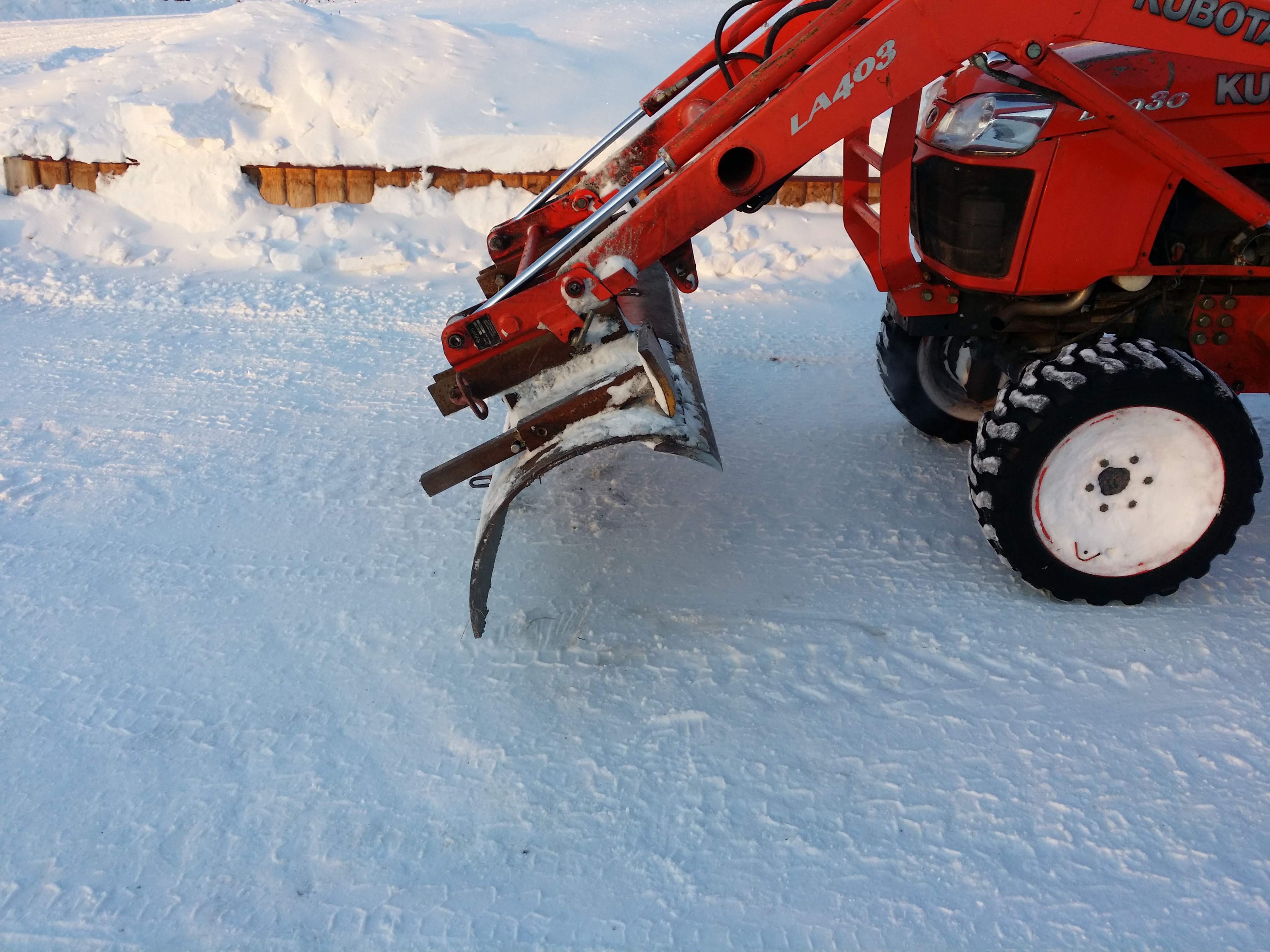

I built this loader blade to move snow more quickly then using the bucket. I was impressed by the fact that it could also drag backwards. It is great for plowing off the ice on the dugout. It only lacks the ability to angle. I plan to add removable end caps to prevent snow from coming off both ends.

No trip springs??? that could be little hard on loader arms when pushing.

I can imagine hitting rocks in Newfoundland, they call it the Rock for a reason. Actually I thought about the spring trip but my acreage is pretty rock free. I would never bend the blade as it is 1/4" thick.

Nice thick blade but I might be concerned for the loader arms, if the blade doesn't give something else will. Nice job and concept being able to back blade. Go slow with caution I'm sure you will be ok. You know your area best.

I am on the Prairie where we grow grain and oil here, both are easy on the blade. So far I'm impressed with it. I even lifted the skids and the blade does not dig in once the snow pack has been established.

That tractor mounted plow of yours is more like a scraper plow. Having the trip edge and angling cylinders would permit more flexibility.
But in any case, if you add "ears" on both sides so not to loose snow off the edges, you will not be able to tilt down your blade anymore, just like you have shown us in your pictures.

I never thought of that tilting issue after I added ears as you call them. Currently I leave a Ridge and then back up Ober it with the rear mount blower. Overall it is quite fast. I rarely use the blade to pull back but it does come in handy sometimes.
