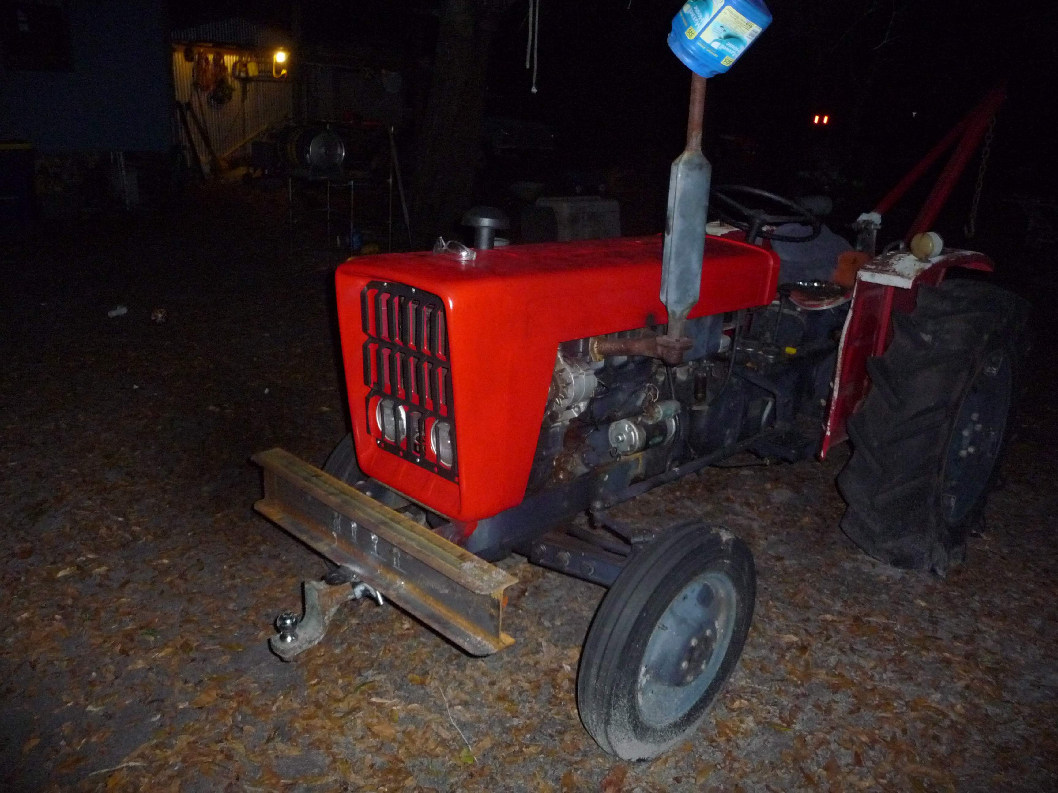

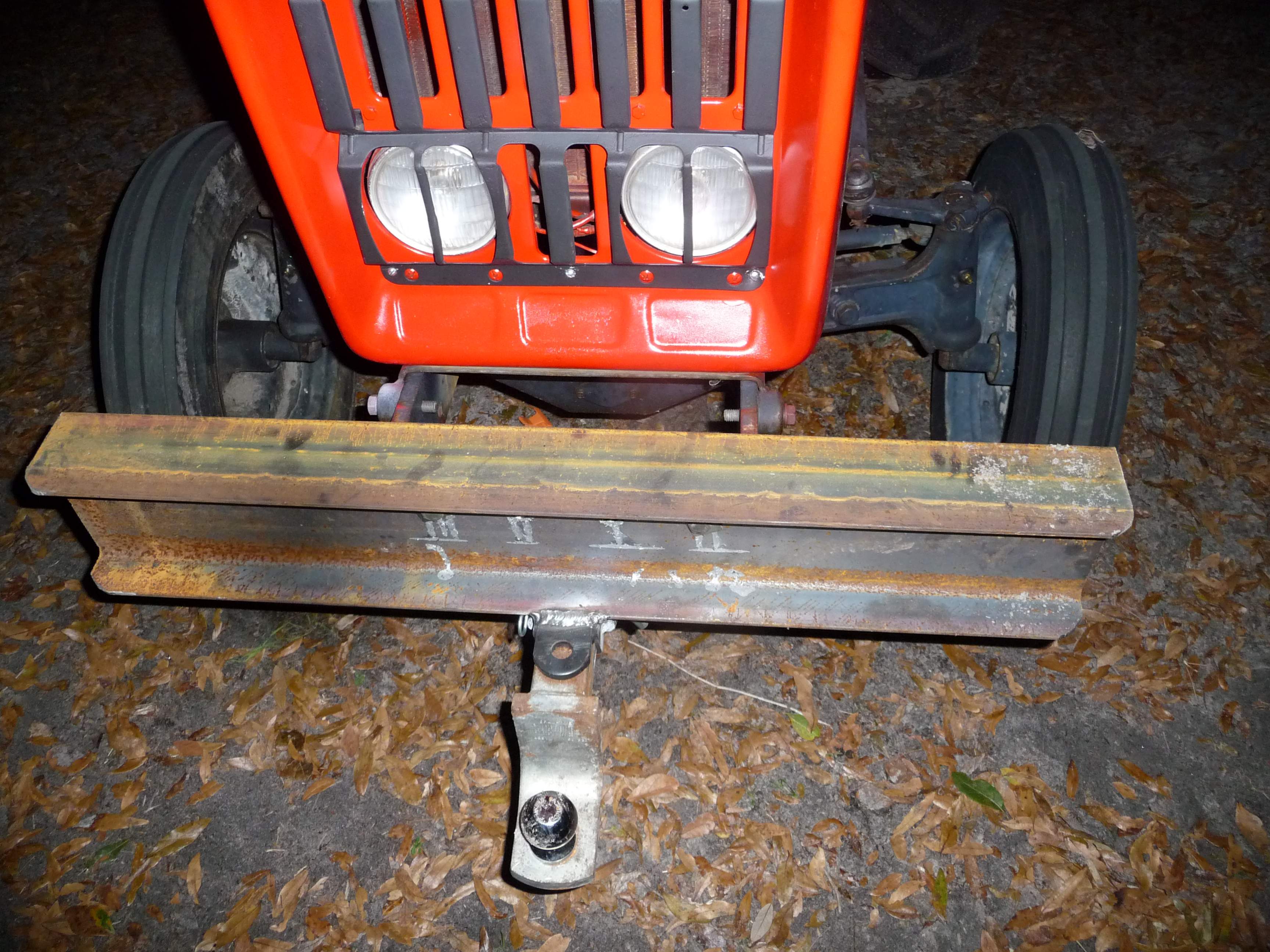

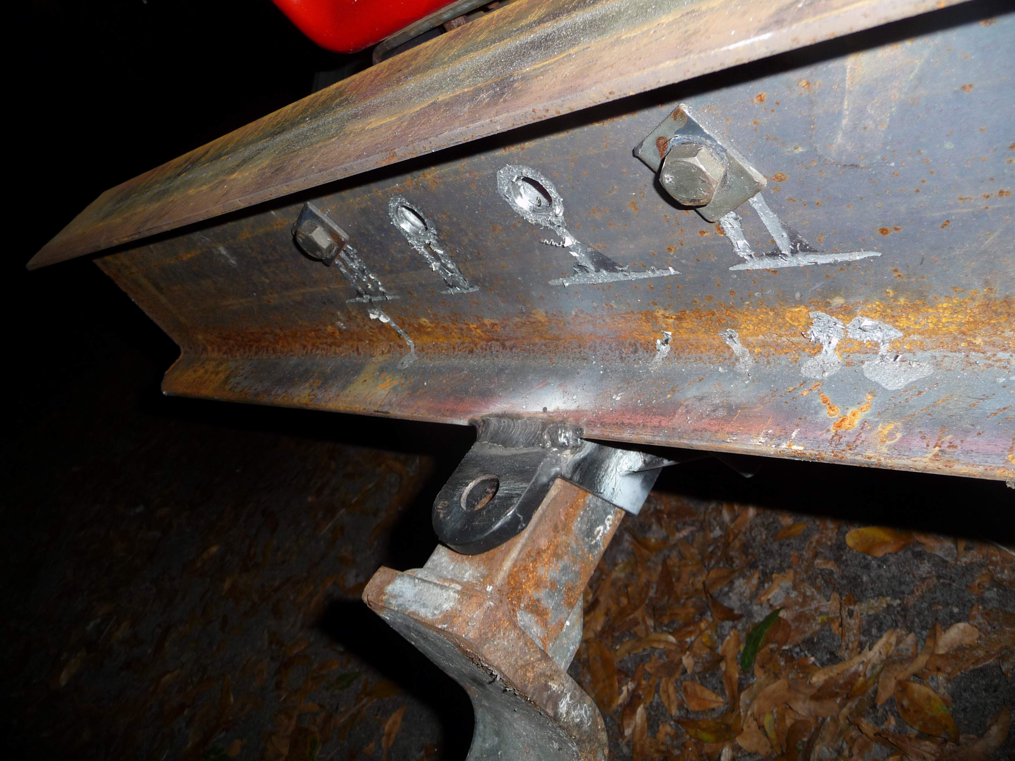

001.jpg001.jpg001.jpg001.jpg001.jpg001.jpg001.jpg001.jpg001.jpg001.jpgThis is my first project I bought an atv reese sleeve that I bought at hf and welded it on backwards to a I beam and bolted it to my tractor the hole that usualy bolts toan atv is forward so I can pull a garden tractor type trailer/or put a ball on it without reese hitch so now I have 260$ in my tractor as I paid 250$ for tractor and 10$ far hitch sleeve.

I accidently posted same pic several times heres some others003.jpg003.jpg003.jpg

Nice job! Looks super heavy duty. You could push down some small trees with this setup.

thanks its not a shiny new tractor but I love it my dad has a kubota but this one is mine and to me its baaaad.

Looks good! You might consider adding receiver tubes to both ends. It would allow you to have a removable carryall. Also I have found it easier & faster to hook up to trailers if I can see the hitch & tongue. Which side of the front end you would hook the trailer to would depend on the direction you need to steer the trailer to keep from running a tire into the tongue.

thanks Im gonna make a carry all next.
