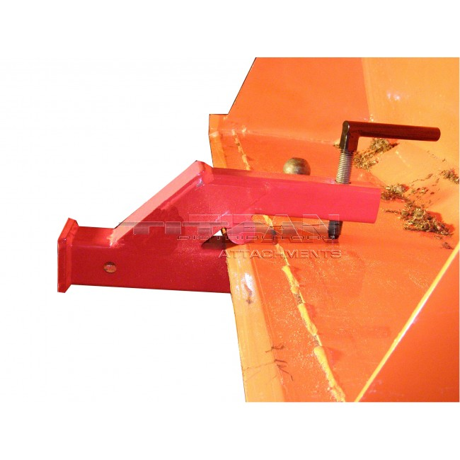

instead of just welding a ball hitch on and/or a couple nuts in place so you can screw a ball into for different size balls. i would say if ya going to take some extra time, might as well go with a receiving hitch. like back of trucks, so you can change out to different things if wanted. from lower drop hitch, to a straight hitch, to possibly some sort of "mini rack" that folks can buy to hold a couple bicycles or some coolers for camping trip. and just slide that right into the receiver on the front. some folks have went extra step of getting a 12v electrical winch that slides into a receiving hitch.

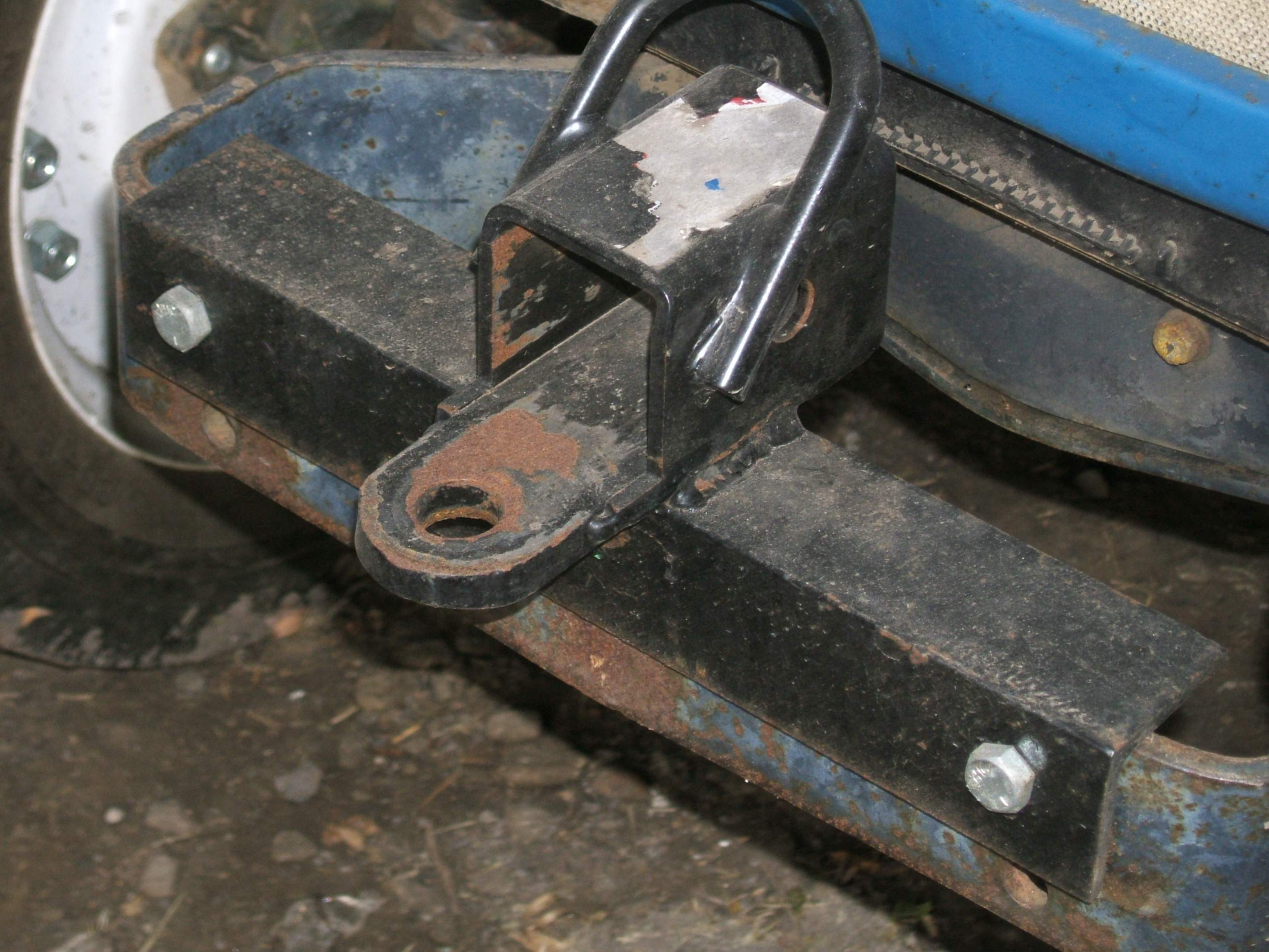

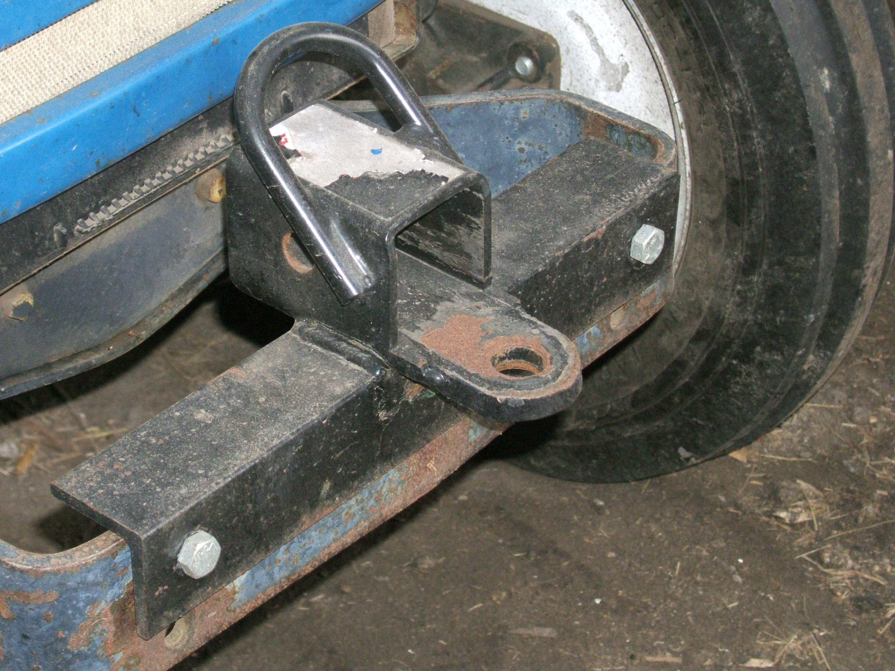

I remember now how I made mine,Atv hitch adapter harbor freight #65961 $14.99 Then welded it to a piece of 2 inch. angle iron and bolted it to the bumper. Works good for mine and is almost flush with the bumper, without the male receiver.
