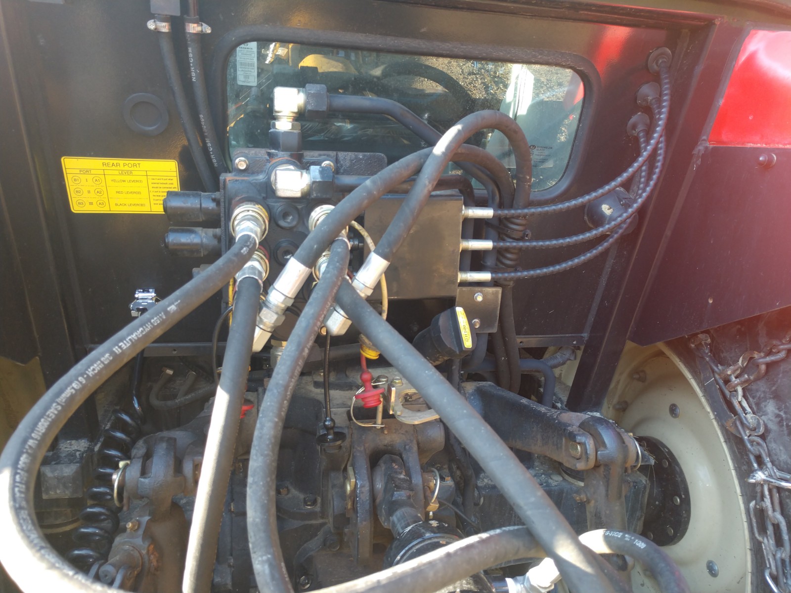

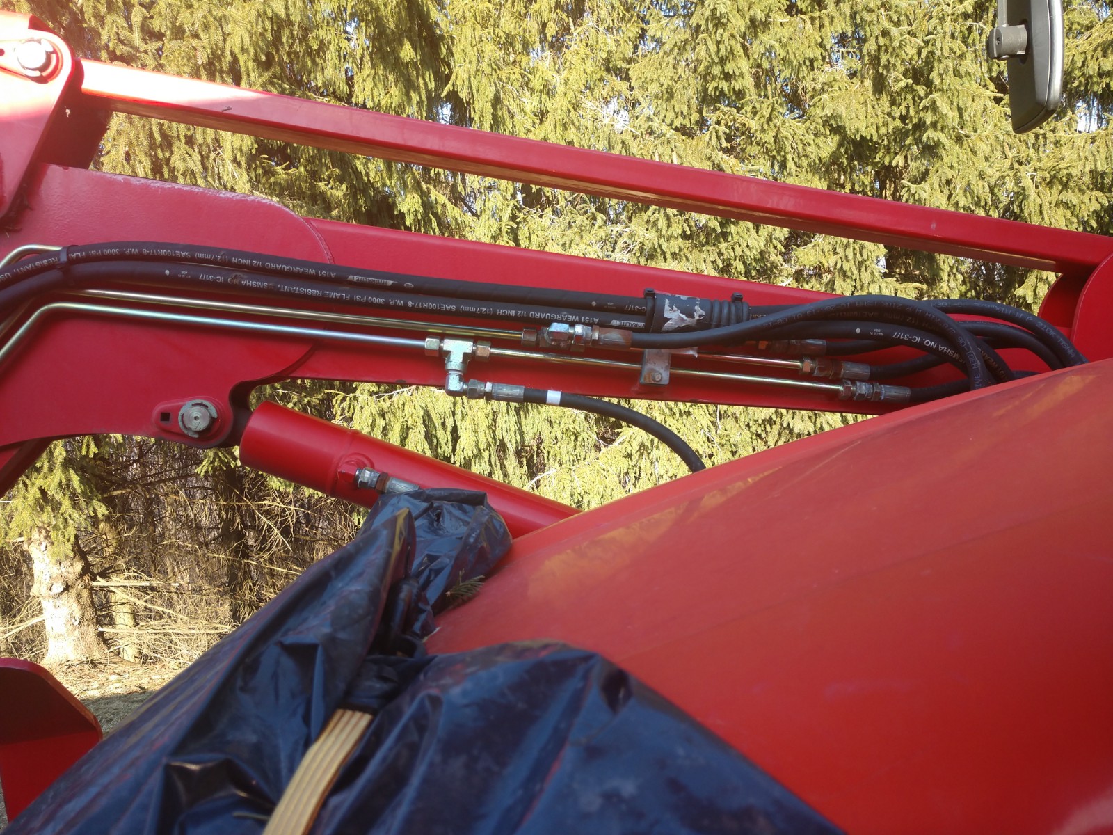

Am thinking of adding a front function on my tractor i have a 7 foot plow that can be angle , so id need function in the front . I look in to it whit the dealer it cost close to 1500.00$ that a bit more then id like to pay so am going to use one of my back remote i have 3 of them .Now is 3/8 hose and fitting a good size .Maybe down the line am going to get a grapple and a tree puller.
/ Front function #2
I ran 3/8"from my rear remotes to the front for my blade or grapple they both will move quite rapidly.

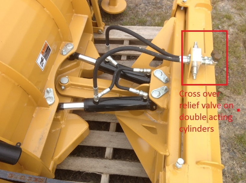

So I have a similar setup however I am having an issue where I am blowing the O Ring on the rear remotes. I hit a chuck of ice and I'm guessing the pressure of the hit blew the ORing.
How can I add a something to relieve the pressure instead of blowing the O ring
/ Front function #5
Cross over relief valve. It will dump excess pressure on one side hydraulic into the opposite side thus avoiding pressure spikes.

If am going to add a plow in front whit angel . will i need Cross over relief valve to run thiis plow or am ok whit just the function from the back.
/ Front function #7
Won't hurt could save a valve
/ Front function #8
I would also highly recommend a crossover relief valve. I'm generally very conservative while plowing, but while pushing back piles of snow this past winter I hit the relief valve several times.

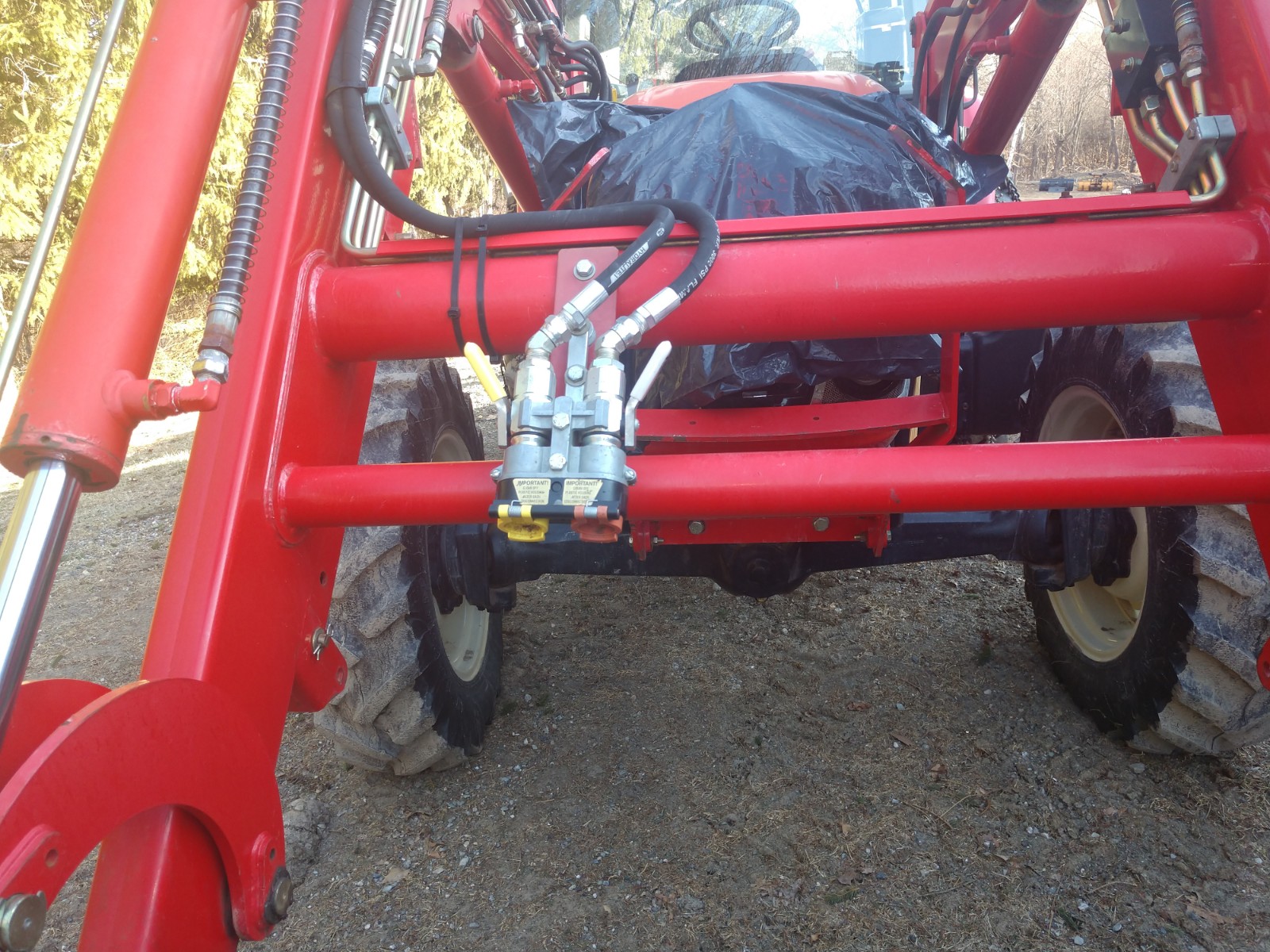

Well final got my cross over valve but not sure how to install i havent played whit hydraulic much here the installation paper on what side does the hose from the tractor goes
ASSEMBLY & INSTALLATION 1. Connect the hoses from the directional control valve to Ports V1 and V2 of the relief valve. 2. Connect the hoses from the hydraulic cylinder/motor to Ports C1 and C2 of the relief valve. 3. Set the relief valve to approx. 300 PSI over the maximum pressure desired by turning the adjustment screw. 3.1 Turning inward increases pressure, while turning outward decreases pressure. 3.2 One full turn will increase/decrease pressure by approx. 800 PSI.
/ Front function #13
Your lines from the rear remotes go into V! and V2 your cylinder into C1 and C2.

Here a few pic of my cross over valve . had to make a small bracket to move it over a bit but now it fit good .Now do i have to blead the hose and my tree puller or just plug it in and play whit the joy stick good to go .

Thanks Dave that was what i was thinking how it was done but better be sure .
