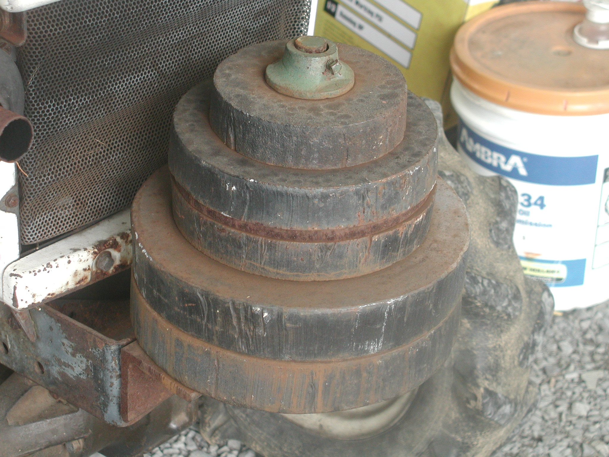

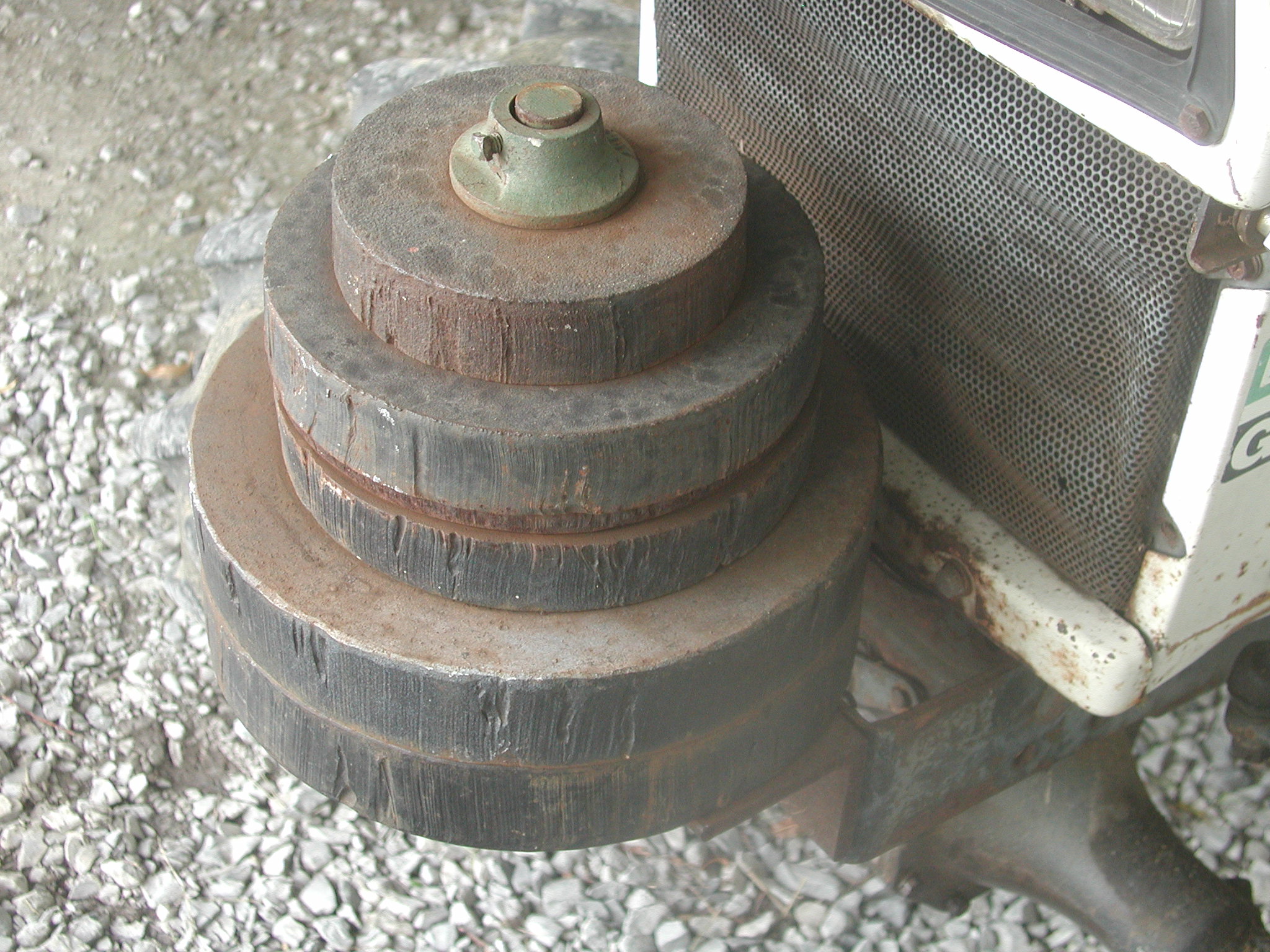

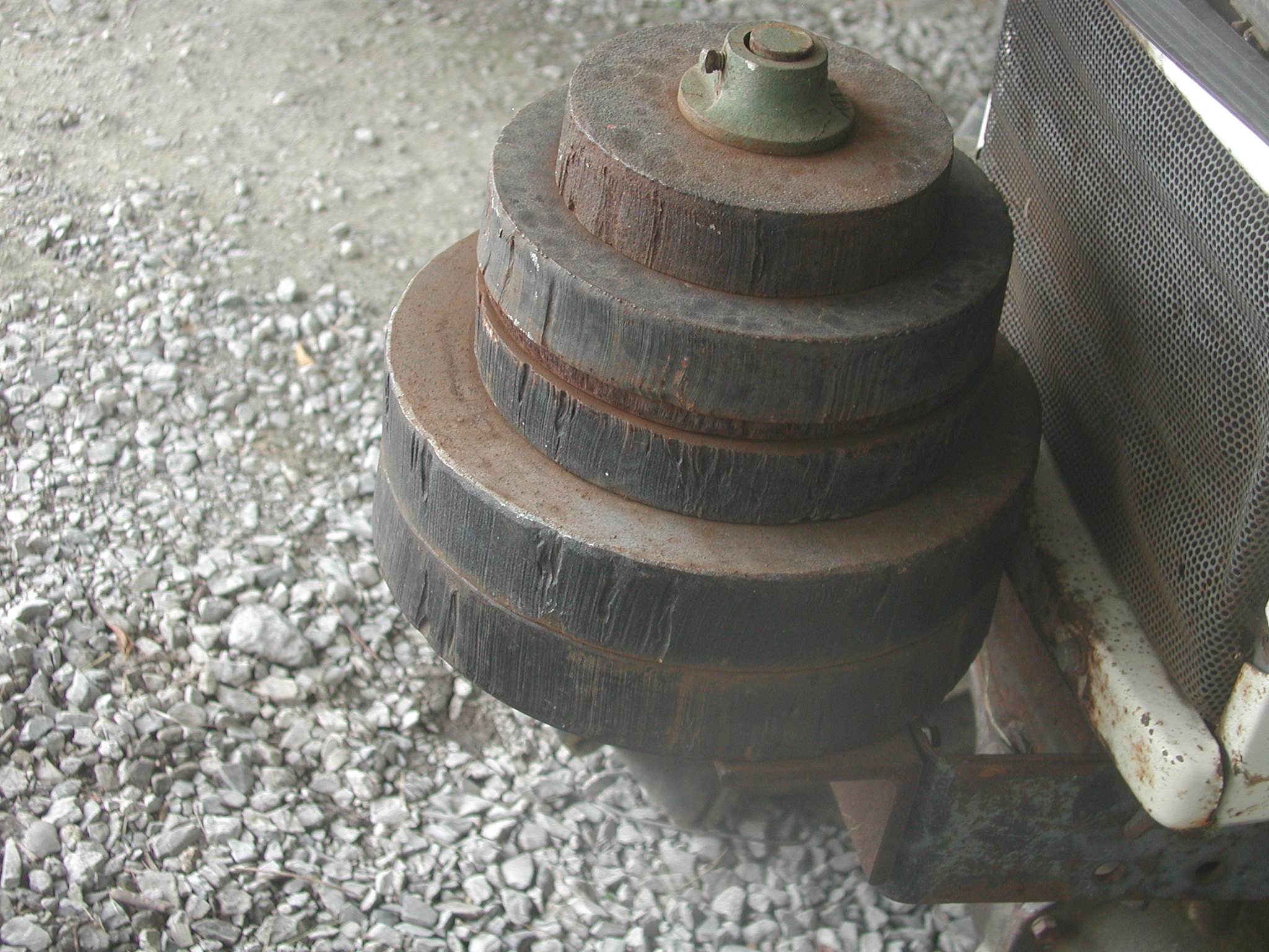

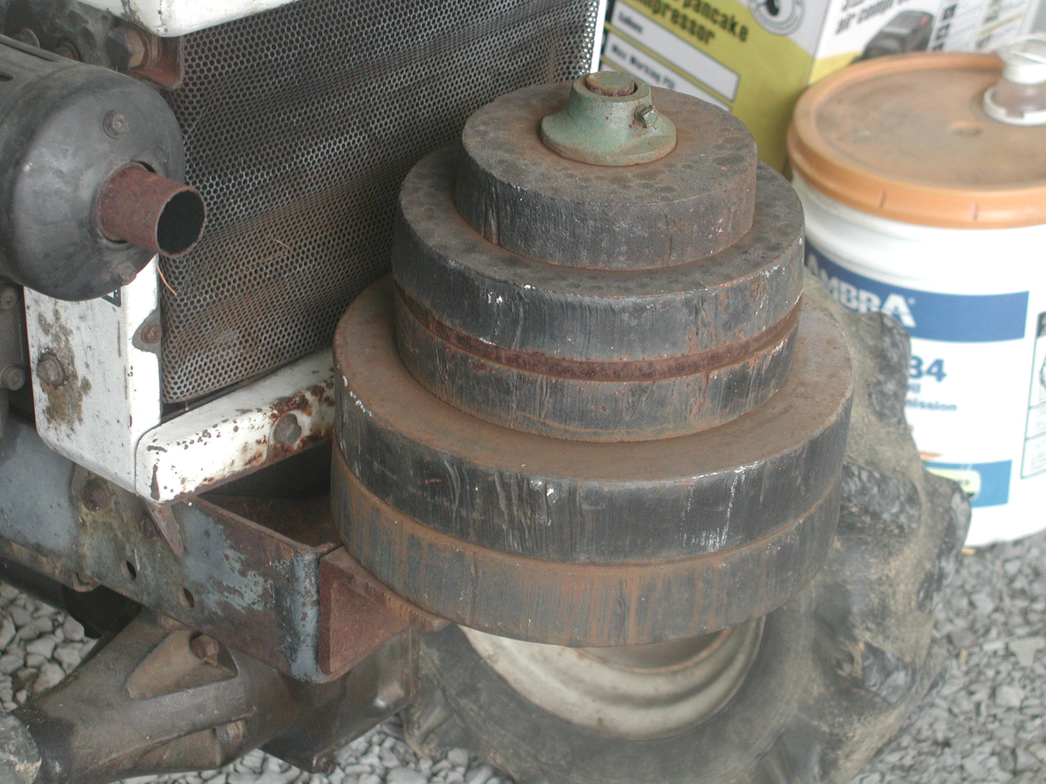

/ Front End Weights #9
Here are mine, made by previous owner, suitcase weights hang off of the front of our tractors just fine.

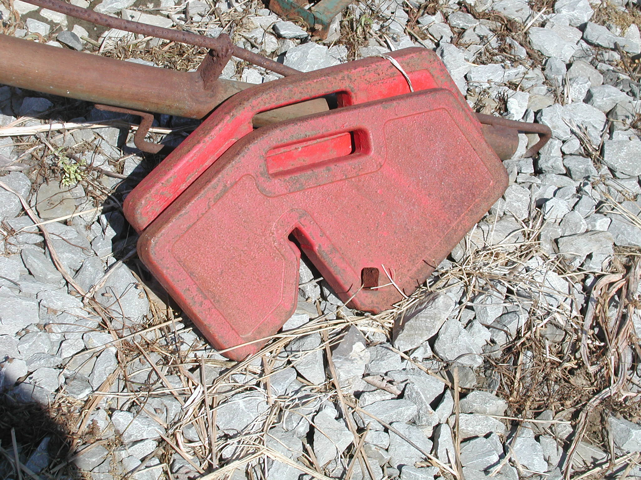

/ Front End Weights #10
This style of IH weights will hang on the front most tractors, look for them at local auctions for $10.00 to $70.00 each.
These are 60 pounds each, smaller ones might be needed for ours, however I did fit these on a IH 234 front "bumper"
