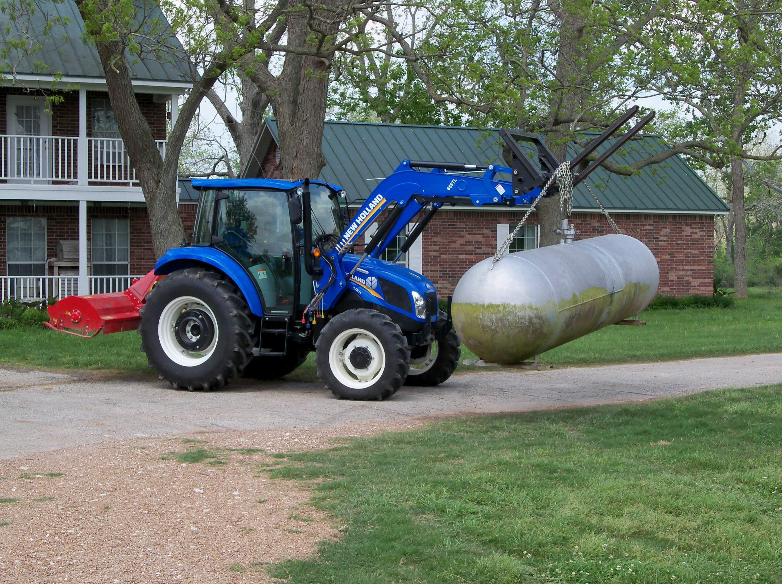

As someone mentioned, the curl function has a lot of power at the bucket edge. You had the center of the load out too far.
I would have moved it like you did. My odds of dying from a tree falling on me while cutting wood in the timber are far, far, far greater than blowing myself up while moving a propane tank.

The Bucket attached to my loader has radius sides - this radius matched perfectly to the radius of the tank. I agree that the tank was way to large for the bucket. Bucket level and driven up to the tank - Sides of bucket did not meet the side of the tank. Tried to curl bucket to (roll the tank back) unsuccessful. What I ultimately did; Dropped bucket to the ground and rolled the bucket without a load to displace the dirt underneath the tank - fit like, "O.J.s glove" well... close enough. Then ratchet strapped the heck out of it, all this knowing not to touch the lever for the curl. ////////////////// I knew I would catch some flack about this but, "He who hasn't done something stupid may cast the first stone" Police? Safety was a concern, however I took precautions I.E. (went super slow). and made sure the lid was secure that covered the tank valves. I am not sure how much liquid was in there but I agree there was "some" there. I survived the experience but recommend to others - don't try this at home. I was shocked none the less that it would not curl the tank but lift it only. Zebrafive I did lift off of the back of the bucket initially but the tank 'swayed' and my bucket was high off the ground which scared the heck out of me on uneven and un-level ground. this made me rethink the whole operation.

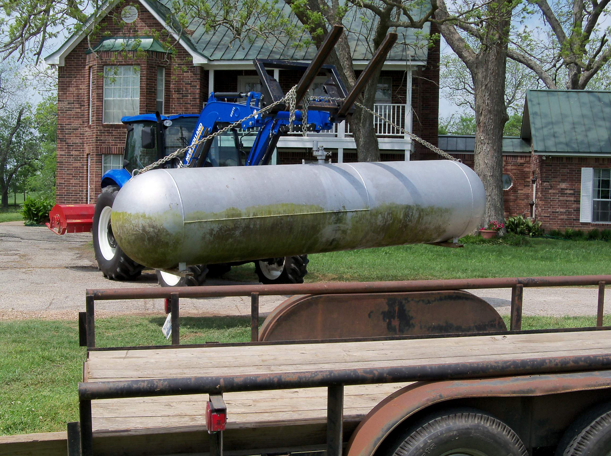

I have moved several propane tanks with my tractor and a 1000 gallon with a case backhoe. All were as empty as they could be. I pick them up and set them on a trailer usually if there is distance involved for sure. What amazes me about the safety police is they always assume something is. I wouldn't have thought that you would have tried to move a full tank, you didn't say that anywhere in your post. So why assume people? Good job on the move. Many of us on here, including myself, do things on our own. We wouldn't own a tractor if we didn't. I buy my stuff to use. Regardless on how much it cost. And before someone says anything, I am not condoning any unsafe acts. I use my judgement and take full responsibility for anything I do. That's what it's all about. I will say this, most of the people you call out to pay to do something don't have enough sense to get out of the rain. LUTT

I was wanting to switch propane suppliers. New company wanted to come install, but old tank was still in the backyard. It had <5% in it. I put the pallet forks on, ratchet strapped it to the forks and moved out front by the road. I couldn't roll it back, but I could pick it up. Went slow, and nothing happened. New LP company came and installed new tank. The old tank sat in my front yard for 6 weeks before it was removed. That ticked me off....

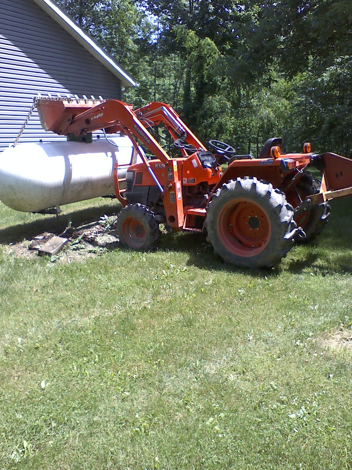

Maybe you could use a lifting strap like this? Just something shorter. I was thinking the same thing you were when I read that. If the fellar or gal welding up the tank was proficient enough to pass the inspections on the tank. Assuming for fun that they used a 7018 rod , that's a rating of 70,000 pounds per square inch. Depending on steel, I know there are other variables . So those straps have several inches of weld. Pretty sure they would hold. But no manufacture in there right mind would promote that. LOL LUTT

If I had to move a tank any distance at all, I'd have done it just as you describe. Chained solid to the bucket.
I had to move my 500 gallon tank just a few feet closer to the house so the copper line would reach. The standard 20' length of copper I bought was just a tad too short. The tank still had about 15% in it to. My best guess is 1400-1500# I wouldn't
The hooks are for empty only. With only 15% in the tank I wasnt worried. But wouldnt have dine it with any more in the tank.
The tank size was a 250 gallon "I think" - hard to tell the difference. I do know it is smaller than the one at my house #1. I just set it off down by the barn, maybe I will move up; to gas heat in the barn,,,one day.

I have 6" teeth on my bucket and if I had to do the same move I would put wood across the teeth and then up both sides of the bucket and go in from the bottom and strap the tank to the bucket and move. Steel won't spark against wood.
I too have the tooth bar installed, wood was not needed as those ratchet straps were so tight that the tank would have ripped the bucket from the loader before it moved/wiggled while attached to bucket.

Rather than using the FEL, strapping the tank to a carryall on the 3pt probably would have been safer, and easier on the machine. You can get a pretty big tank strapped to a carryall if you have the ability to secure it really well. Add some boards to the carryall, and it won't even scratch the tank. Depending on the exact situation, it might take a couple of boards to make a ramp, and either someone to push the tank, a come-a-long, or something similar to get the tank on the carryall, but it shouldn't be that difficult....worst case, dig down six inches so the top of the carryall is even with the bottom of the tank, then pull it on with straps/chains and binders.
