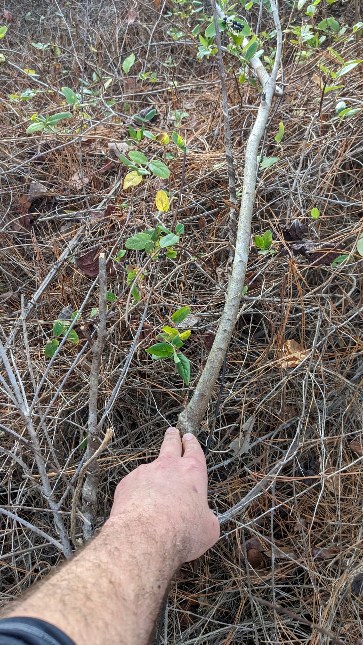

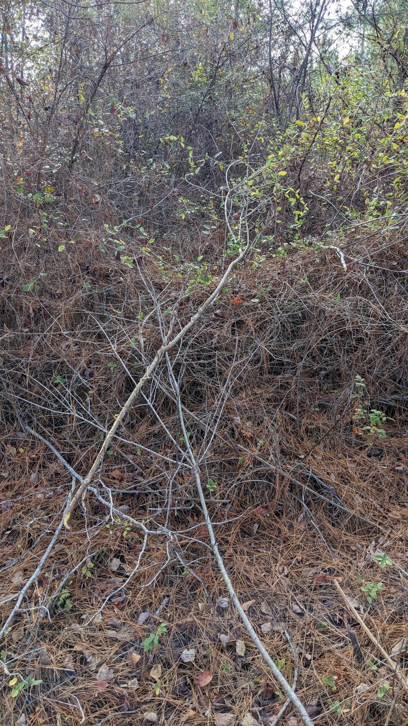

1. How easy is it to bend a 3pt connection or PTO? I've got some really thick briars mixed in with very small saplings. Typically, I need to back into these areas to cut them because there are larger trees on the other side that I can't really run over. I'm just slightly concerned that I am or could do damage by forcefully backing into this stuff. It's small stuff. it's just REALLY thick. I'll attach a picture but these things don't necessarily translate very well.
2. I've got the remotes and plan to install top and tilt cylinders. I can't really picture how much it will "top" or "tilt" (and I haven't really adjusted the manual bars since tractor was delivered a month or so ago) but I'm curious if PTO based implements could be an issue with top and tilt? In particular, can the angle get weird and screw up the shaft or is that basically not possible?
3. If I bend my loader will I know? How? I haven't experienced any issues but I feel like I've done a couple of possibly stupid things. carried a box blade up a hill with the weight unbalanced and kind of on one arm. forgot to lift bucket a couple of times and scraped ground a little. had some violent actions when I was trying to figure out float. like tractor being lifted up. etc. nothing INSANE.. and I typically vastly overestimate what is damaging to something new until I'm completely familiar with it.

Depends if you have a 20 hp tractor trying to pull a 6' mower with a 40 hp gear box or if you have a 90 hp tractor that your mower has a 30 hp gear box. Tiny tractors break a lot easier than a 60+ hp tractor and loader.

It is possible to bend a PTO shaft by lifting it too high or if the inner/outer sections somehow get bound up when they should slide freely.
There are differences in the strength of light duty brush cutters vs heavy duty cutters insofar as how large a sapling you can cut without damaging the cutter.
/ A few (probably) dumb questions. #6
pto shaft is SUPER easy to bend if you get it in a bind. Run mower level and go slow, should be ok. Dont crowd things!!

I do a lot of backing into thick brush with a rotary cutter. To avoid damage, first go slow. If you back it into something solid like a stump you don't want a lot of momentum. I have a hand on the 3pt lift control so I can lift the mower away from anything bad like a large rock that the mower's pulled out of the ground. Ideally you will have examined the area for obstacles before mowing it but that's not always possible.

Things to watch for on your first attempt at brush cutting
any unusual sounds or violent shaking of the mower as you work the implement
any unknown objects that are hidden in the thick brush, rocks, old fence posts, stumps, etc
any deep holes that your wheel could sink into and cause mayhem
other than that, and if you follow the good advice already given here, you should make short work of that mess

I mowed my neighbors vineyard which got overgrown with 1” elm saplings and a bunch of brush. Medium duty 5’ brush hog was fine as long as I kept it in 1 st gear. Made 2 passes at different heights
Did have trouble at the end of a couple of the rows where the end turnaround was too tight up against a rocky bank. Got it stuck on a boulder at 0 mph and sheared off a hitch pin in the stabilizer for the 3pt linkage before anything else broke. Replaced 2 stabilizer hitch pins with low strength ones a size down. Thought was they would act like shear bolts and protect the 3 point. They did. And you could hear it snap cause the mower wasn’t running
