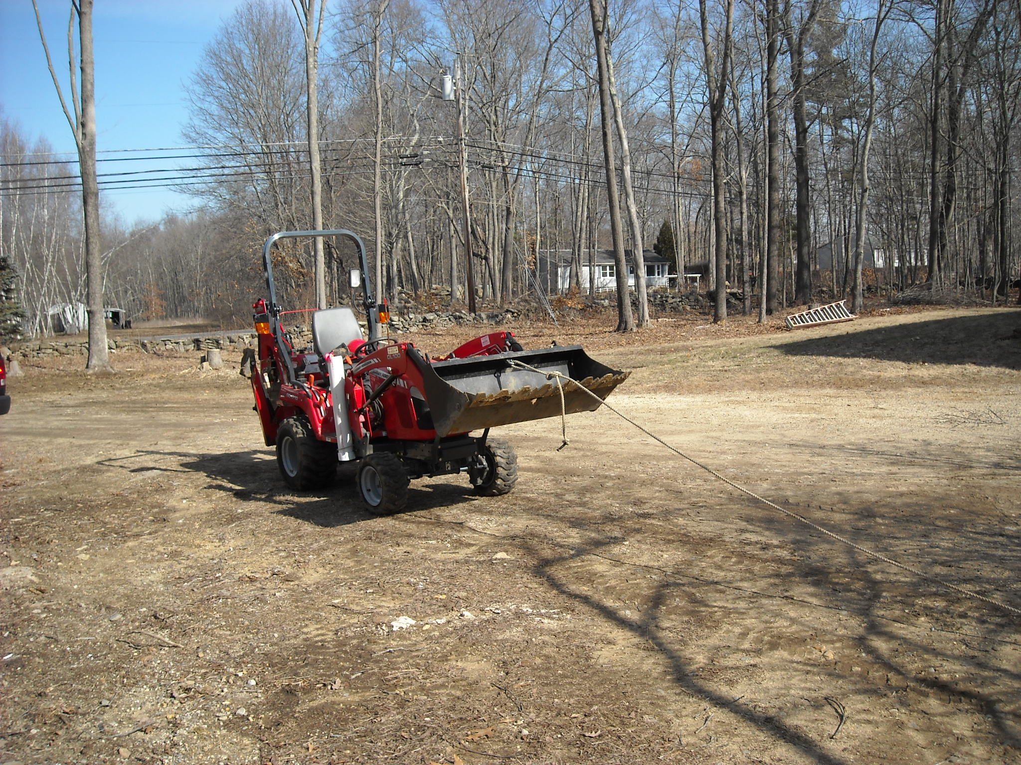

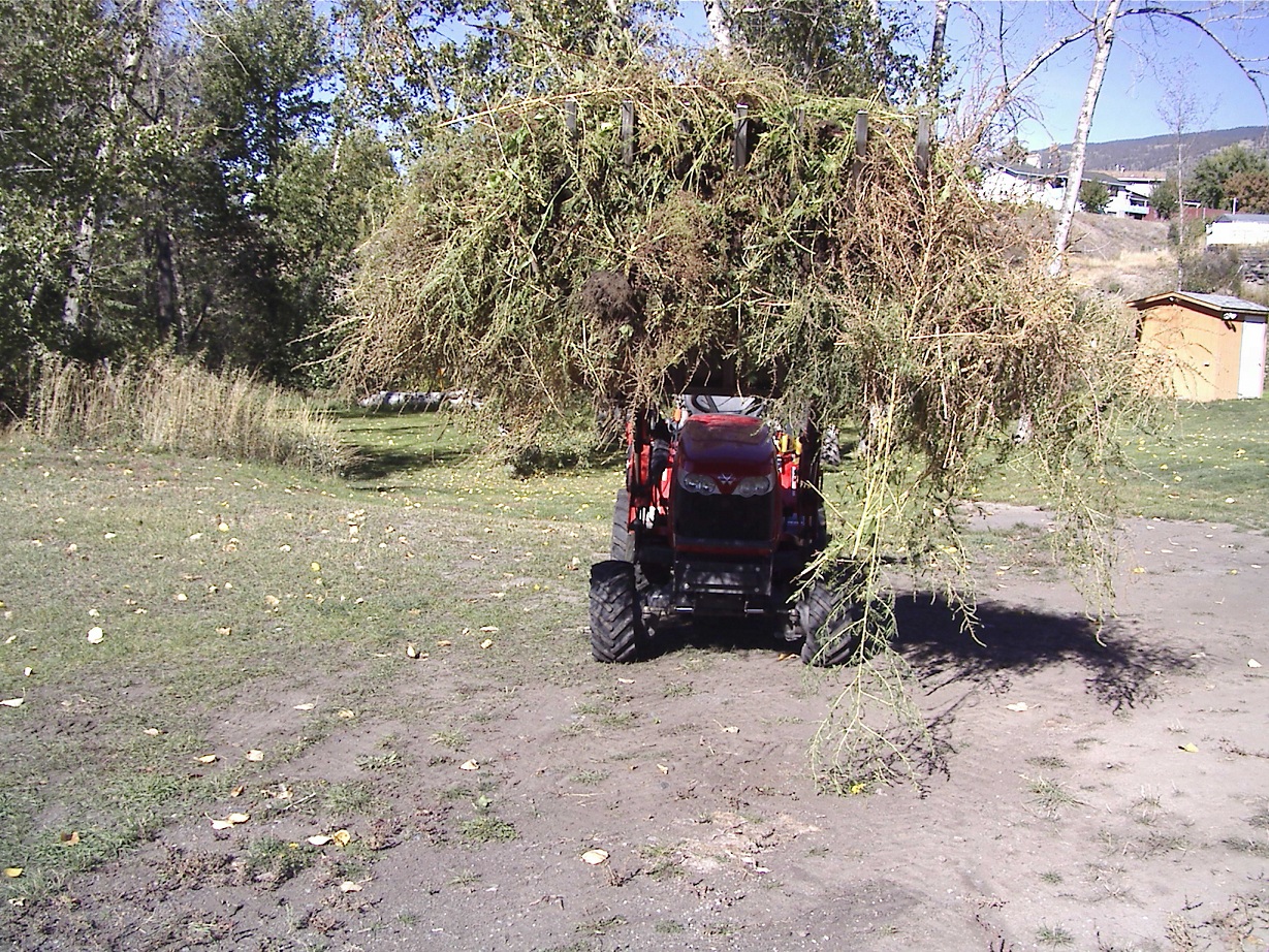

Now that I have a grapple and pallet forks I don't use the hooks very much. Before that I used the hooks quite a bit. A bare bucket is darn near useless for anything besides moving dirt. Try moving a stump or large firewood rounds without some hooks. I plan on welding hooks on Grandpas tractor bucket soon. I have needed them several times for pulling post and moving implements. That's his tractor in the picture, but I was using my bucket. I also have a hook on the boxblade. image-3935840779.jpg

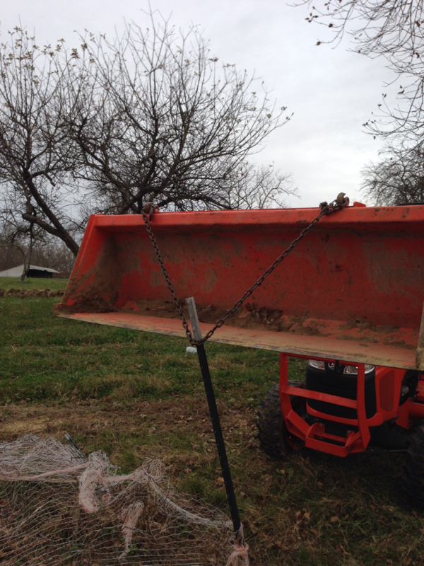

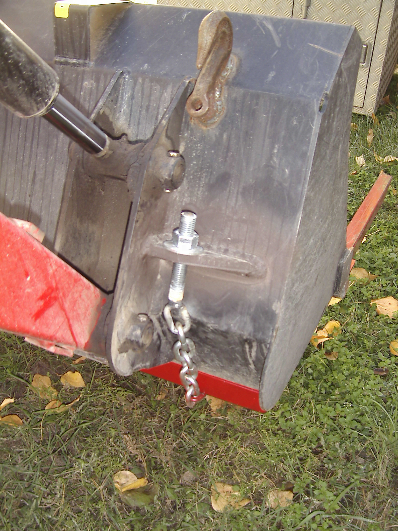

Rjmack . . The picture you attached of your bucket showing the chain fastened lower side was perfect. Now that to me really explains how chains can be used . . thanks.
/ Front bucket hooks gc series #28
sorry, I don't understand. the chain you see holds the forks on. the design has been slightly modified to hold the ready rod parallel to the bucket.
there is a hook welded on each side and a trailer ball welded to a repad in between them. no issues to date. :)

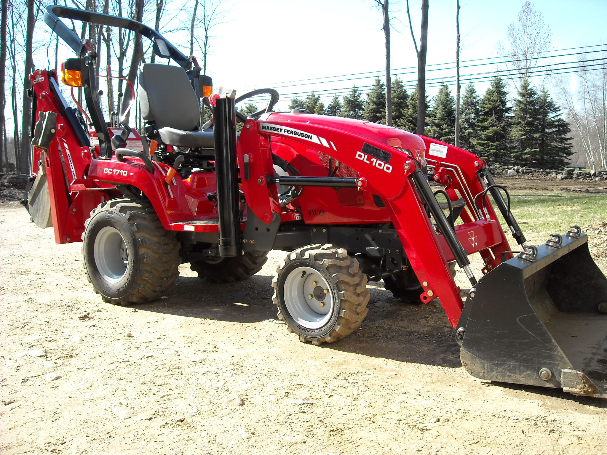

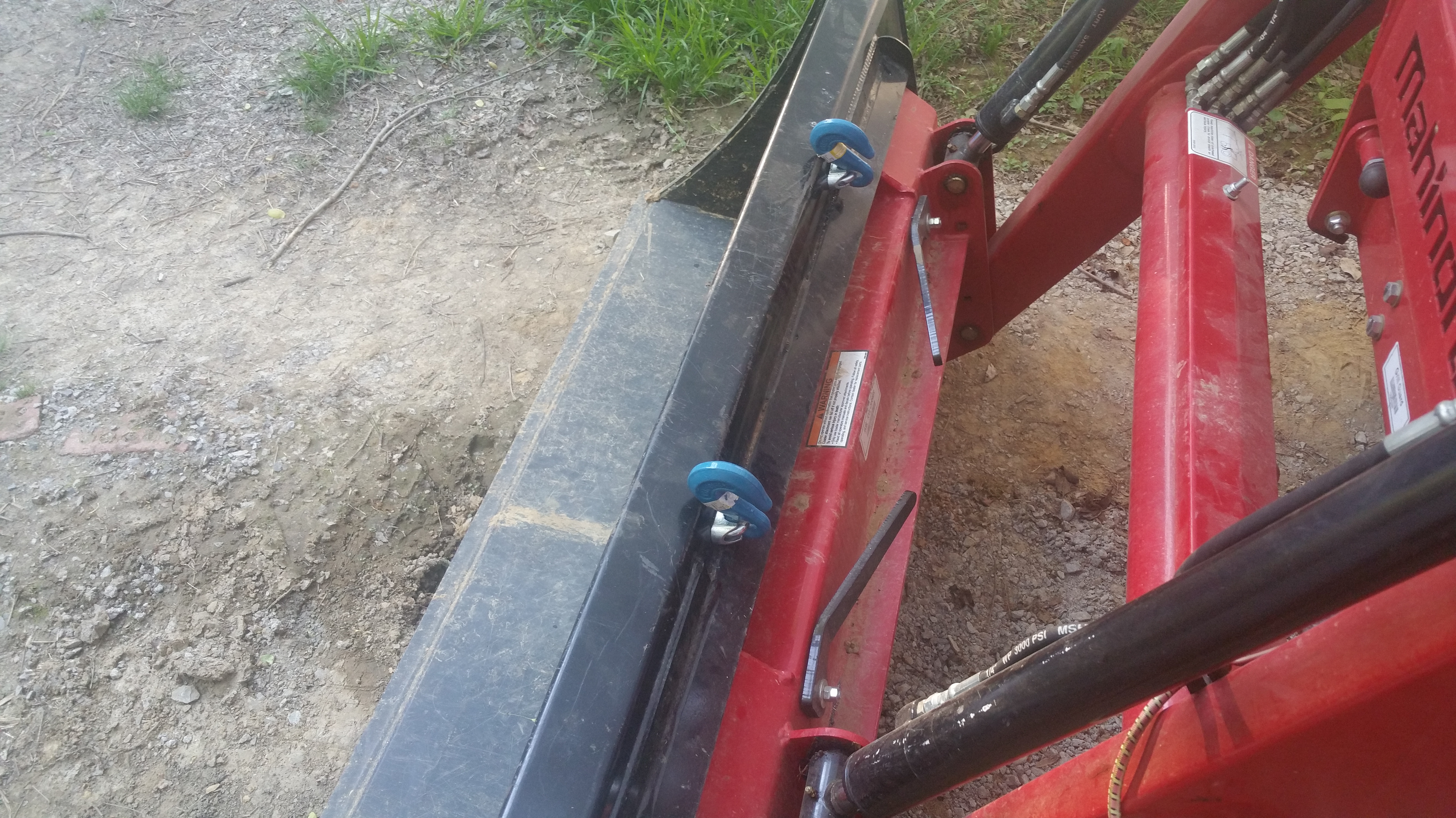

I have a gc 1710. There was some plugs on the front end loader I replaces with some hooks ( see photos). What has everyone put there? I put some removal eye hooks that are often used for trailers I got a rural king. They unscrew when not in use. Anyone see a problem with these? I have yet to use them.
Hey Bevis, I read through all of the replies and saw no replies to your original question. I also asked several dealers before purchasing my GC1723 and none of them could answer the question. I'm thinking of installing hooks similar to the ones you installed but will not be using them to pull or lift heavy loads. I'll most likely only use them to lift lighter stuff or for straps where the bucks it handling the load and all the strap is doing is helping to keep it from tipping out of the bucket.

What I was saying with my reply was that all the replies to this thread are about using bolt on hooks (like you have), but the original poster was asking about use of the two factors holes in bucket. The two holes are spaced about 24" apart, so you couldn't use a regular bolt on hook for two reasons. One, you need 2 holes spaced together and 2 the location of the factory holes is not in the location on the upper lip of the bucket where you could normally see bolt on or welded on hooks.
