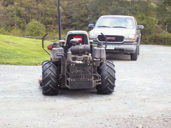

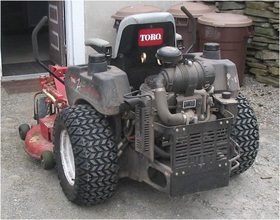

I must have pretty steep hills.
Bought this mower in 2002
Took off the originals put these on...
Then went to these...
/ Front brakes on a Zero turn!! #12
My Woods front mount came with the tires you show in photo two. My problems going down hill are not sliding as long as I can control the hydraulics. I really should add the ROPES bar and seat belt. My problem is bracing myself so I do not slide forward and pushing on the sticks.
I break traction all the time with those tires going uphill. If my mower deck was wide enough I would add a dual kit.

I've got a couple spots on my property with a pretty good grade change although they're only a few feet in length. No danger but my Carlisle Turf Savers can break traction going in either direction. I found that any significant change to one of the drive wheels is when I see greatest loss of traction. It is better in my case to just pick a slow speed and hold that through the slope.

My last property had much steeper hills than the one I have now. I complicated my situation by adding a Swisher 66" pull behind. Towing or not, once I spin, the Carlisle's load up and then I need to back up. Not so good when I have slid up against the fence.
I may try loading the tires or adding some wheel weights before I invest in different tires.

Good point. I have been pondering the lug type tires shown in the first photo posted by Gizmo2 since as I said, the one's in photo two do not work well for me. Perhaps the mower makes the difference? A friend went from the latter to the former and his mower works much better with the lugs. I have also thought about going to duals in a narrower tire to increase the amount of ground contact without going past my mower deck.
