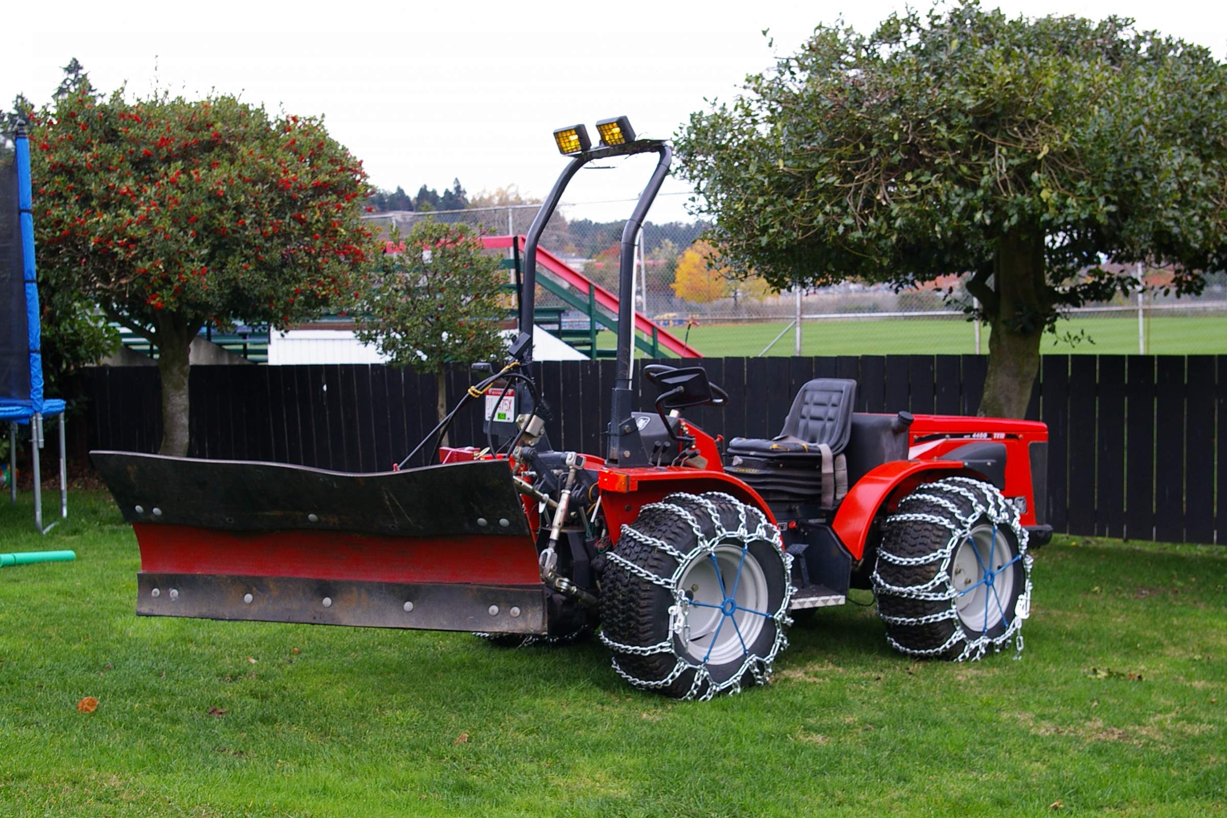

I bought a 6 1/2' plow, Western blade with a Kubota subframe mount for a hundred. The plow is like new. I adapted it to my 4110 and it works rather well. i have since built a loader and don't use the plow. I may readapt it to the 94 Jeep Wrangler I'm working on. I was surprised the 4110 handled it very well and the hydroturn made it very efficient.
   / FRONT BLADE ? #12
Looks like a snow plow to me. With the springs to give some release if you hit something hard and the shoes at the corners.
Nice score.

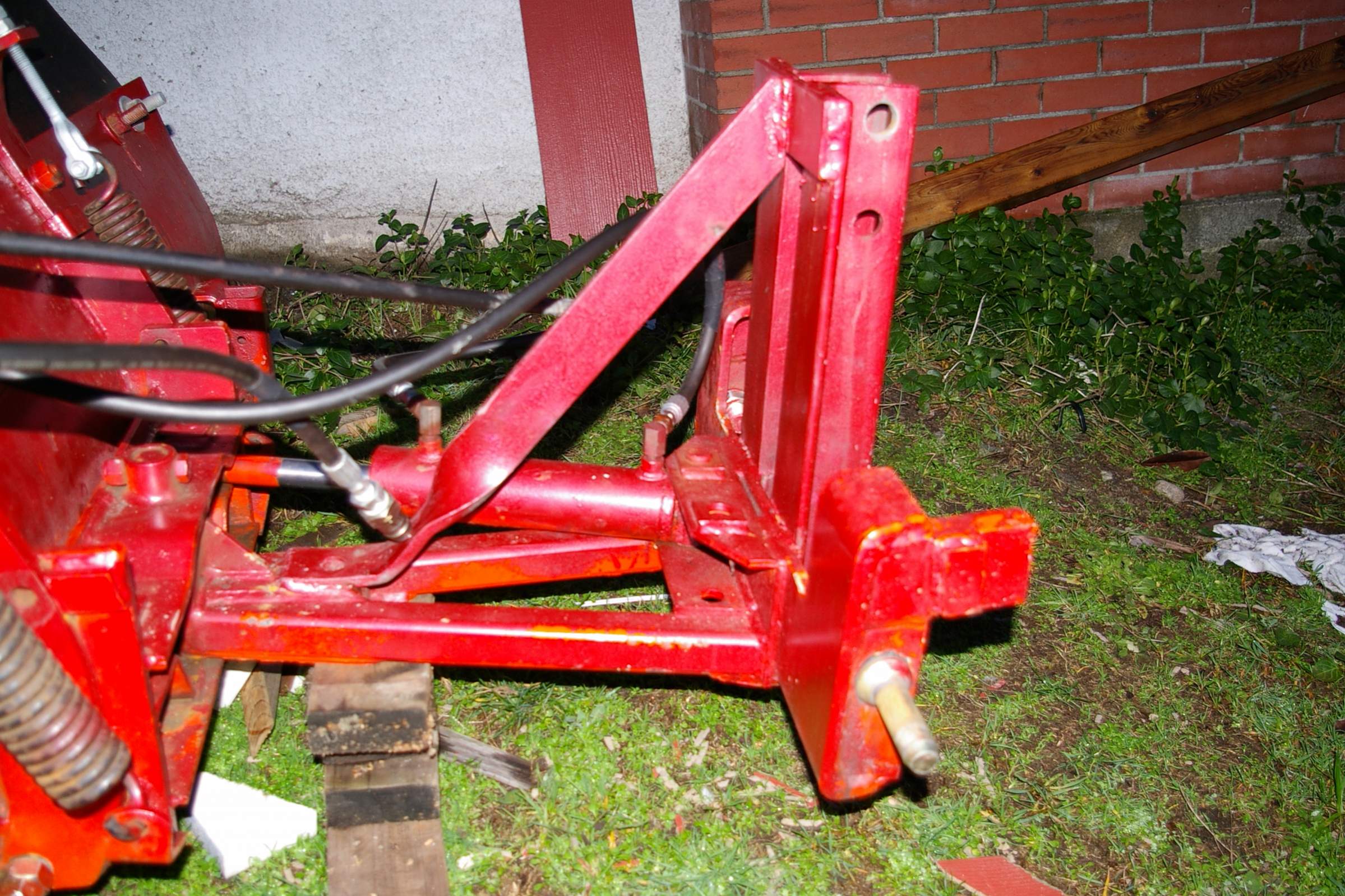

   / FRONT BLADE ? #13
looks like a simular blade that i picked up a while ago. I converted mine to a 3pt hookup as my tractor is revesable. Great deal at 150. the holes are for rubber to make it safe or mine had metal ware blades on it

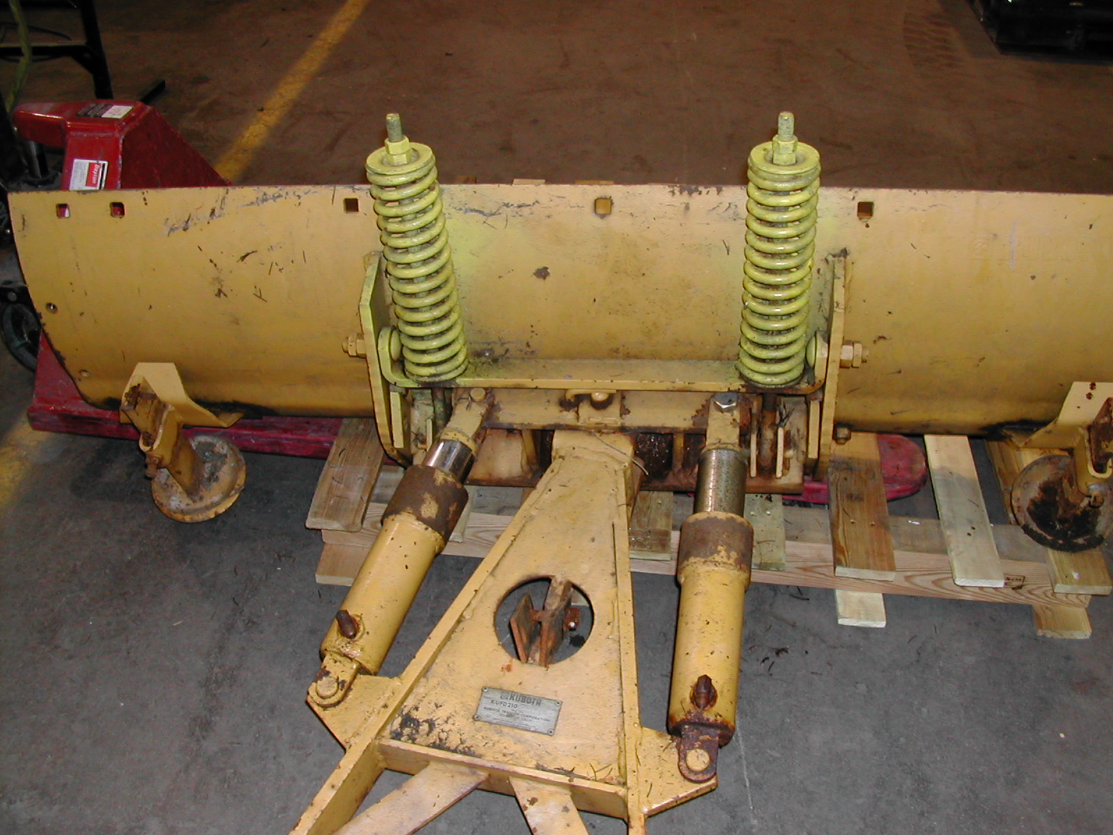

Just to update this.
A couple better pictures.
There were a couple vertical bars added to try to mount it to a different tractor.
I'll have to come up with something for tying it into the frame in the rear of the tractor
I'll have to get a cylinder for lifting.
There are alot of like "scratch" marks on one of the cylinders.They aren't pits so hopefully it can be dealt with.
Can you use steel wool to clean them up?
I think the mod is going to be a little more involved than first thought. If I try to do something like a 380 mod, I'm thinking the solid "A" will remain,but after that,the separate bars might have to go,and I'm going to need a kind member to offer his time to give me some critical dimensions.
The other course would be to just try to make something like the Kubota mount shown in the pic.
Comments or suggestions please
Greg

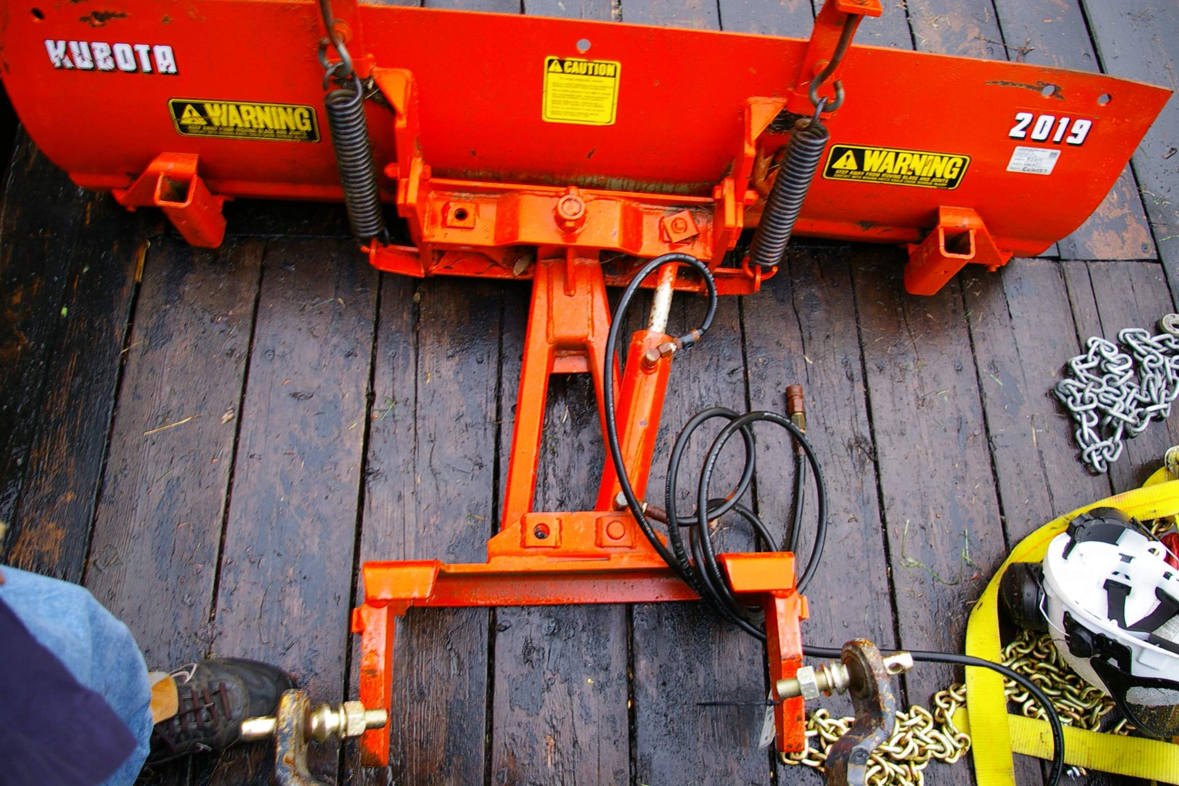

I found a pic of what it looks like mounted
KUBOTA L185DT Less than 40 HP For Sale At TractorHouse.com
