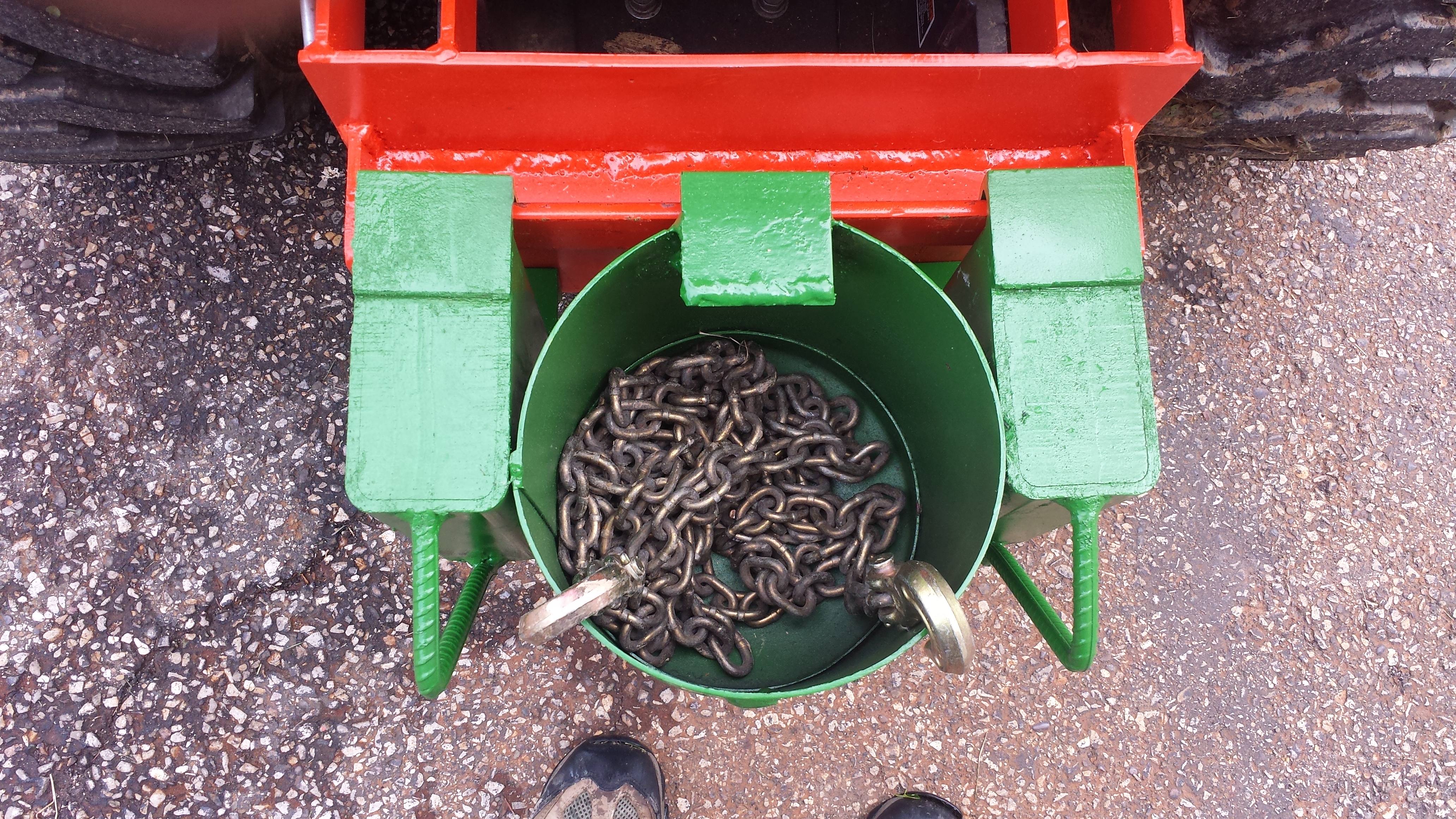

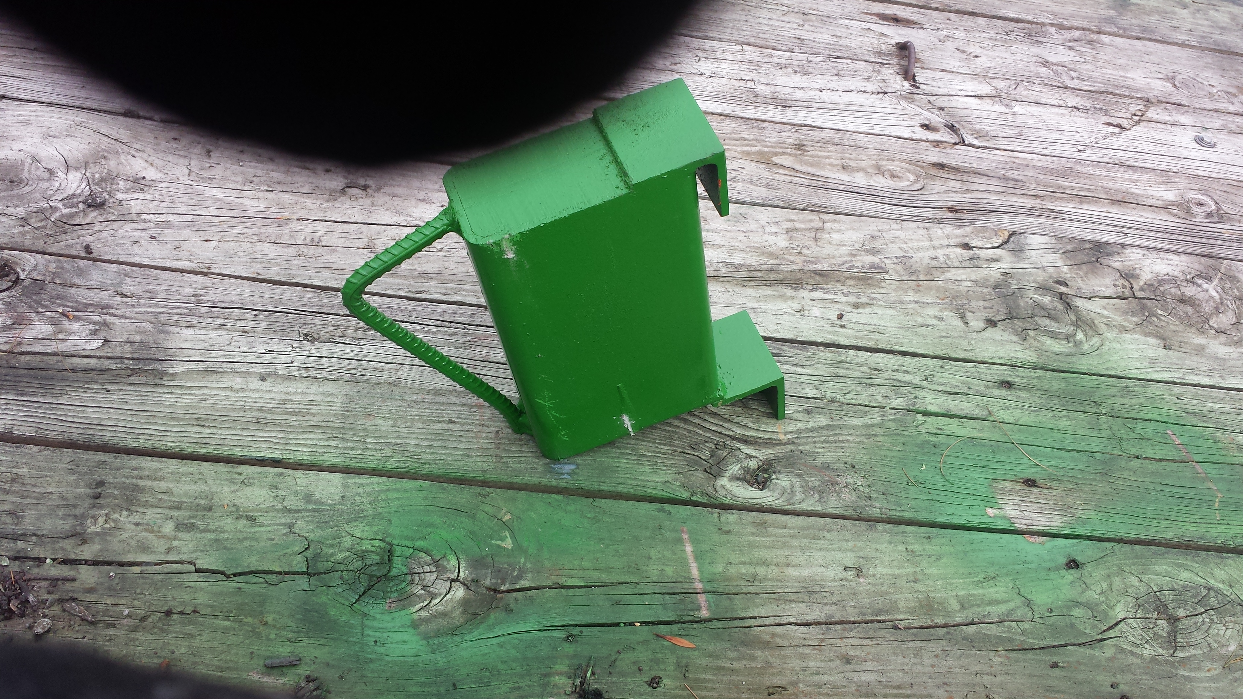

I went to the scrap yard and got 6"x2" 1 foot lengths of square tubing.
Then to the local tire shop and got left over weights.
Welded some angle on the bottom and part of the top and filled it up.
Weighs in about 75 lbs. Finished with hydraulic cement on top and was done. Had green paint left over.
I use them on the rear of my BX 25 in loader operation.
Cost about 25$ and a case of beer for five weights and lightened the scrap pile a bit.

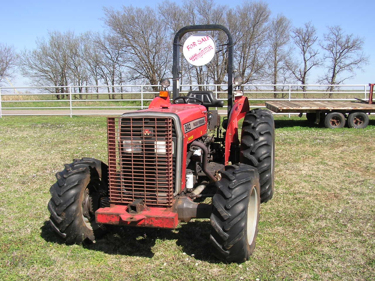

This front weight and brush guard was on the tractor when I bought it 16 years ago. It was bolted onto the frame at the sides.
I welded on a receiver hitch:
