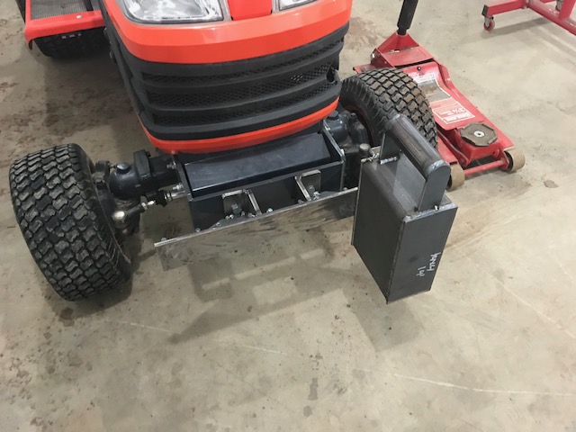

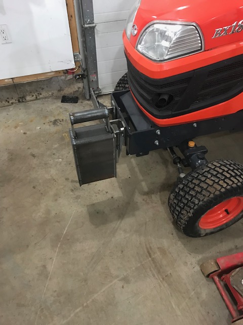

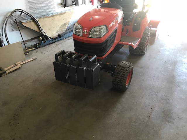

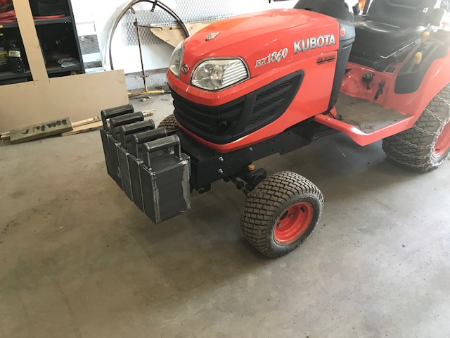

Here is my front weights for my BX1860. Weights seemed to be about $1 per pound in Canada.
I bought some steel tubing, plate and pipe for about $55. I acquired a few pales of wheel weights from a few shops around town. I then melted down the weights on an outdoor propane burner. Placing the weights in I could only get about 1/3 the weight as melting them down. Total cost was under $100 and the weights are about 55lb a piece. Made 5 of them for box blade work for landscaping around the house.

I bought some steel tubing, plate and pipe for about $55. I acquired a few pails of wheel weights from a few shops around town. I then melted down the weights on an outdoor propane burner. Placing the weights in I could only get about 1/3 the weight as melting them down. Total cost was under $100 and the weights are about 55 lb a piece. Made 5 of them for box blade work for landscaping around the house.
Just be careful melting lead. The fumes if you get it too hot are kind of hard on your health. I don't know all the details but I would do some research before I tackled this.

I should have mentioned I wore a respirator and when pouring the lead also used full leather gloves and a full face shield.
These front weights and chains on my turf tires turned this little tractor into a beast for dirt work compared to without the weights and chains. I was second guessing my purchase of such a big machine to only mow with once the landscaping was done. I figured I would buy a tractor instead of paying someone else to do it. I'm glad I did tho as I watched the neighbors get stuck on the steep backyard slope with their ride on mower with no 4x4.
