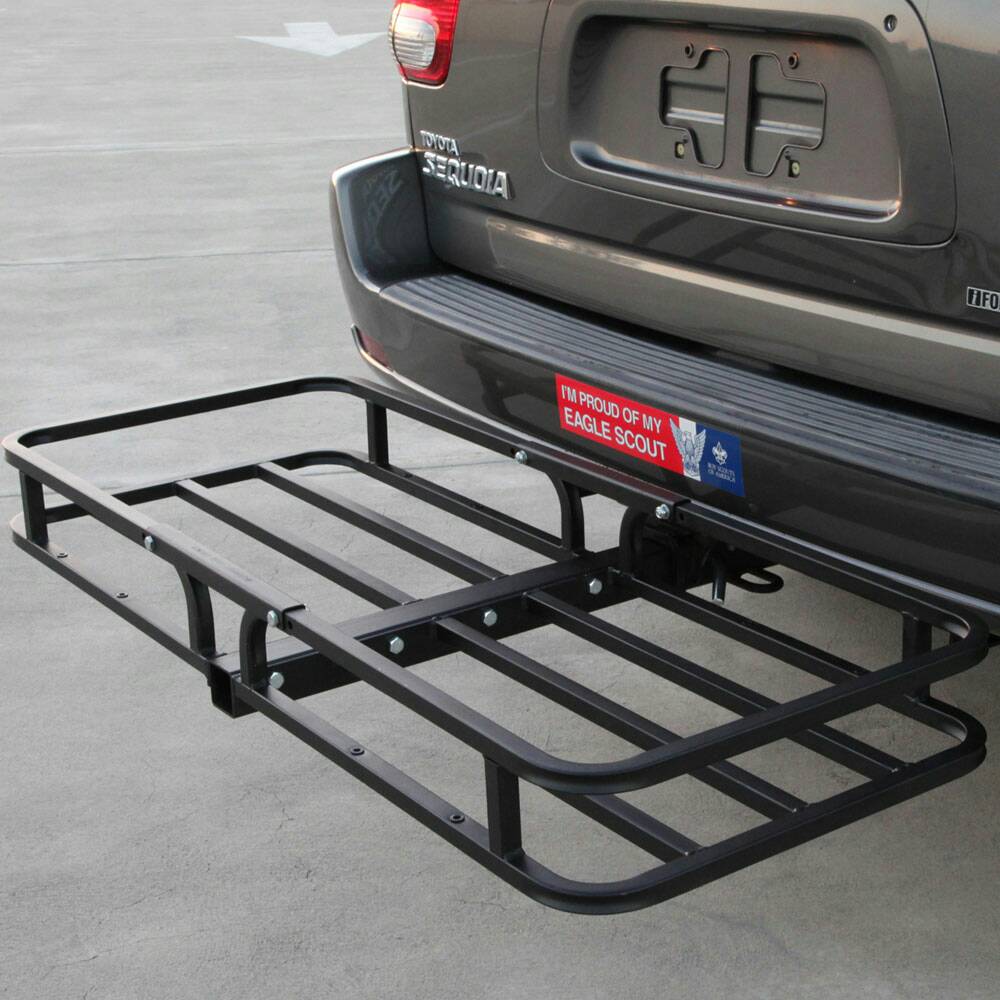

Been thinking of adding 2 in receiver and one of these to front of mine and just use it as a carry all ? image001%20(1).jpeg
