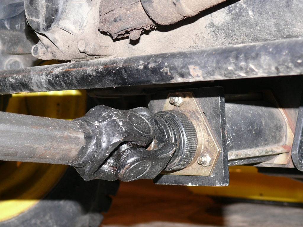

The original Deere front mount has the front pto shaft attached to it also, this will be a problem for you if your "other" implements require it. The current Deere's front attachment kit is more along the lines of a 3 point setup.
Also, with the "old" style mount, it has to be removed for the mid-mount mower.

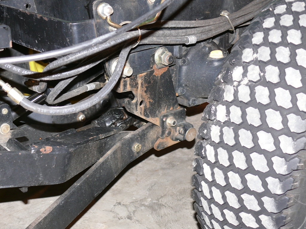

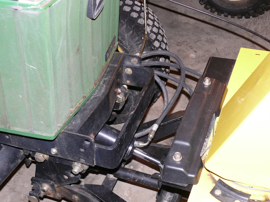

Tom, I'll dig up the manual for my front mount kit, it'll have the part number on it.
Ed
/ Front 3-point linkage for a JD 855 #13
Here you are: BM16492 is the front attachment kit, BM16494 is the front pto mount kit.
I took a few pics of it for you....hope it helps.
Ed

that's not a front 3pt setup.... that is the front Quick Attach setup.
/ Front 3-point linkage for a JD 855 #15
You are correct, he asked what was available, to my knowledge that's it......
Ed
Ed
Thanks for the pics Ed. Yeah, that's the part number I have been looking at. As Mechanos points out it is more of a quick attach than a 3 point linkage per se. I'm looking around to see what others may have done to cater for a top linkage, as I assume at this stage the bottom points would be catered for by the QA mechanism.
Thanks again- Much appreciated. Not easy here in Ireland to get info on these great machines..
