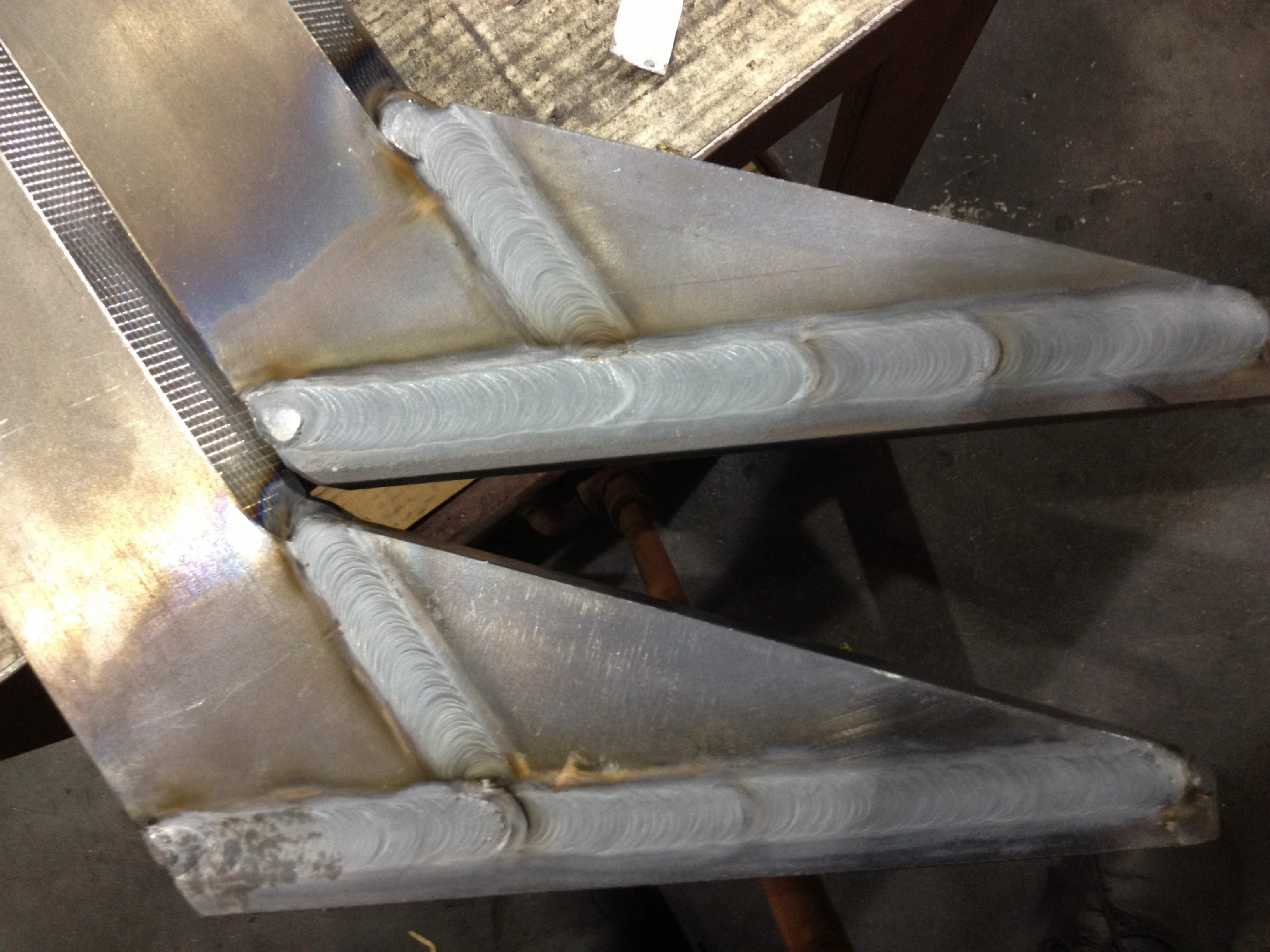

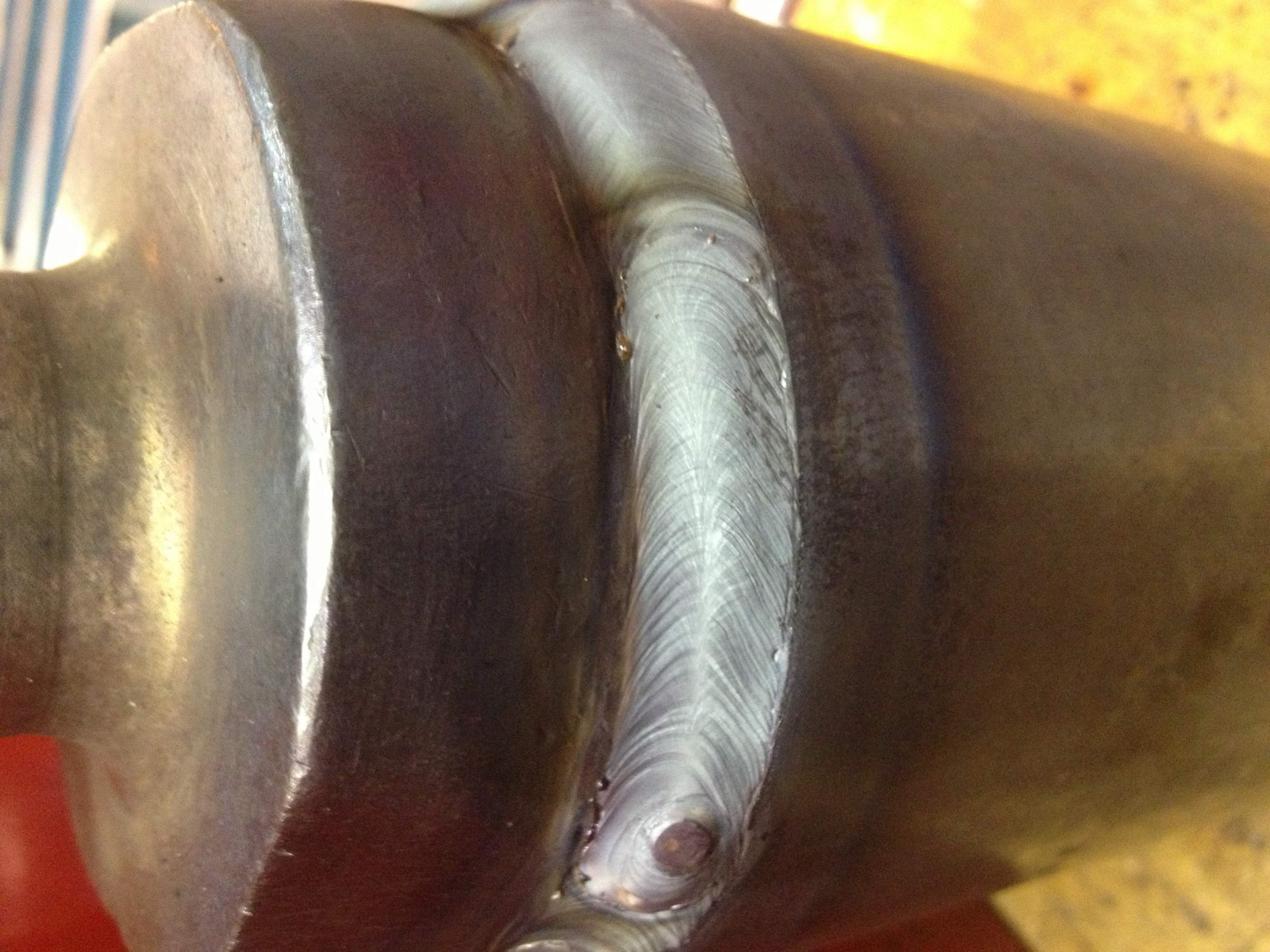

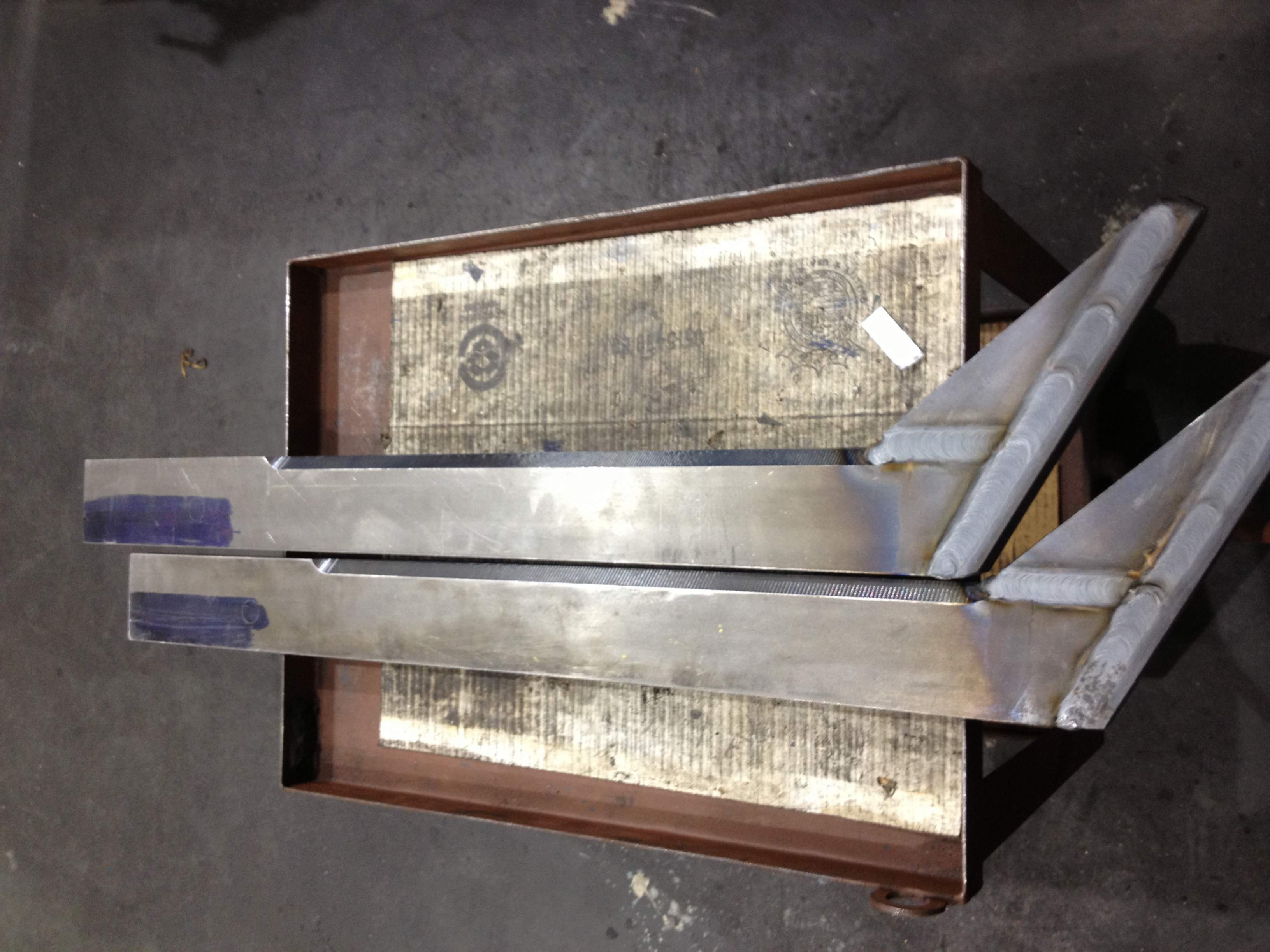

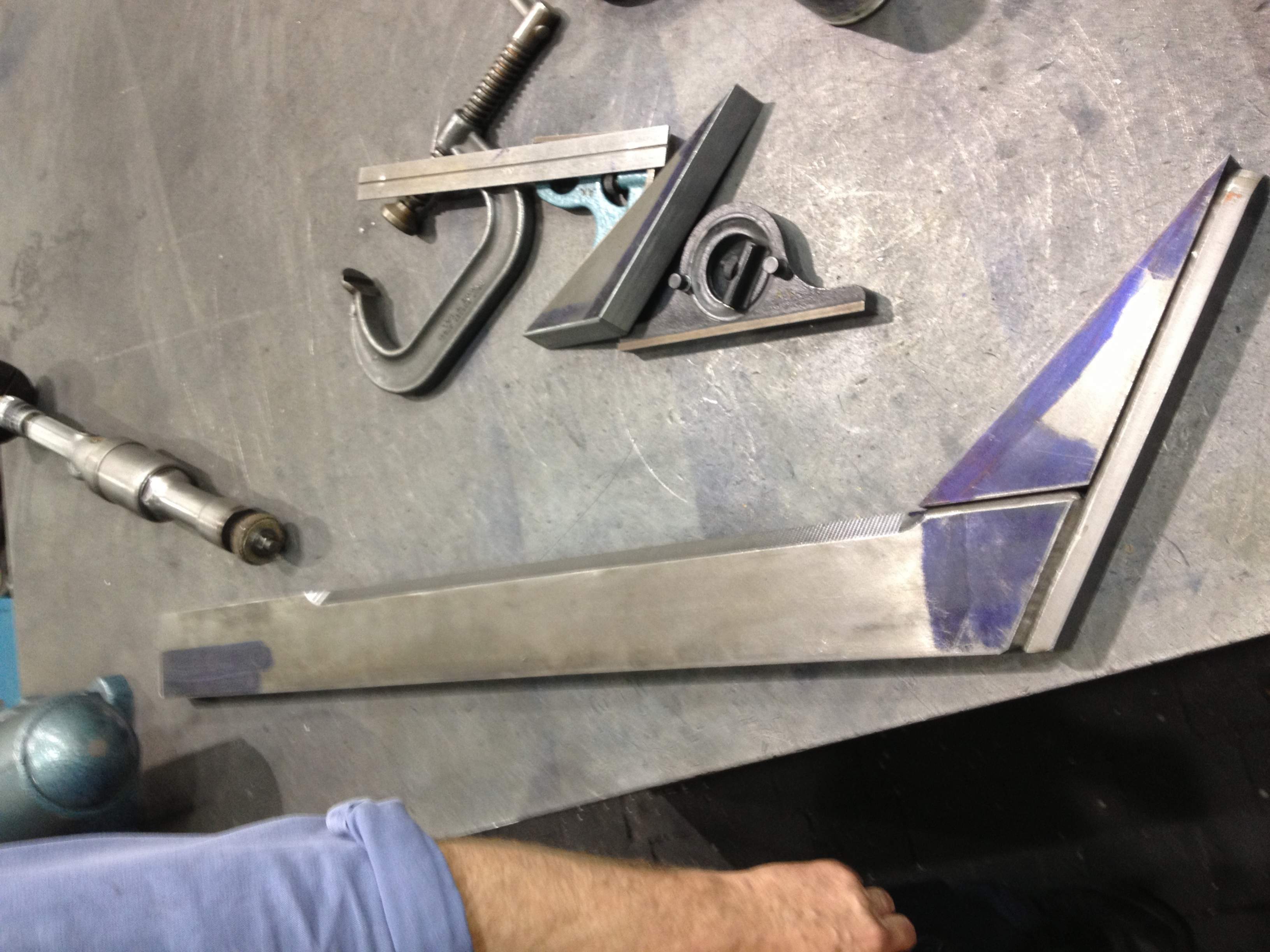

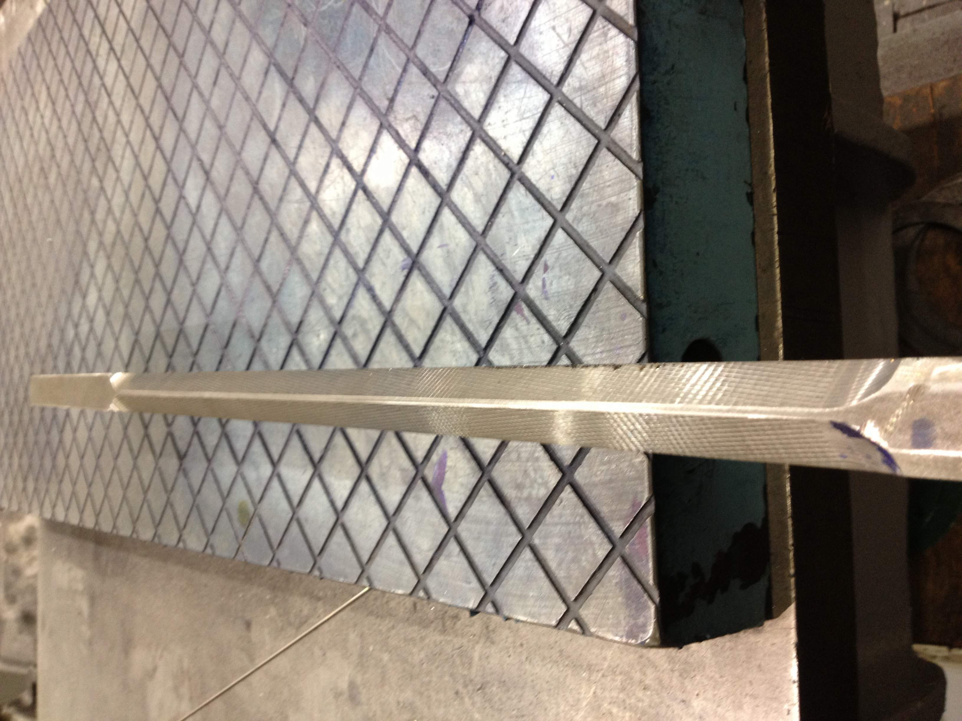

I removed the (2) plows from the frame and made a couple of subsoilers. I still have to drill and tap a few holes for an attachable pipe to install water lines, wire and a mole. What do you think, can anyone come up with some ideas/improvements to it before I paint it all up? I'm thinking its plenty strong, its 1"x3"x33-1/2" and the plow frame has a shear bolt for safety. The subsoilers will go 24" in the ground before hitting the frame of the plow.

Those are some nice welds!!

I don't think you really have questions. You just wanted to show off the beautiful work you did and I don't blame you. ;) GREAT JOB!

I think you will need to put a wear point on the sub-soiler and maybe some hard surfacing rod along the cutting edge as a minimum expecially if you have sandy soils. You could likely use a replaceable point like is used on back hoe or FEL teeth.
Nice welds by the way.

Thanks for the kind words everyone. That's a good idea about putting a bucket tooth over the point, I didn't think of that. I was going to hit it with some hard weld and grind it back in if it wears to much. When everything dries up around here I'll report back let everyone know how it works, good or bad. I can't take credit for all the welding, I started welding it up and my buddy told me "let me clean those up" and finished them for me. I'll never argue with a guy who can run a bead like that. He's probably one of the best I've ever seen, even better with aluminum. I got the idea of using the plow frame from TBN so I guess the only thing I've done was cut/machine some steel to make them. I hope the old 3000 has enough HP to pull them. It pulls the (2) bottom plow really easy so we shall see.

Rio Grande, I would think 3/4 would be thick enough as long as you have some trips. Just in case you hit something. I used 1" because that's what my entire plow frame is made of and that's the thickness where the plows get bolted to.

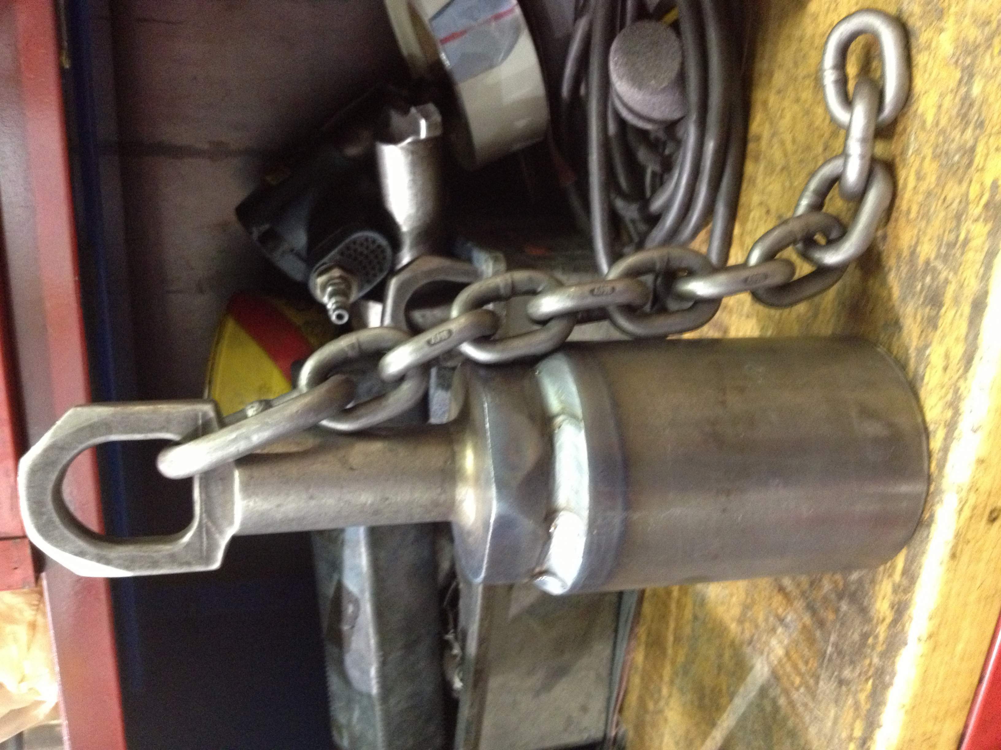

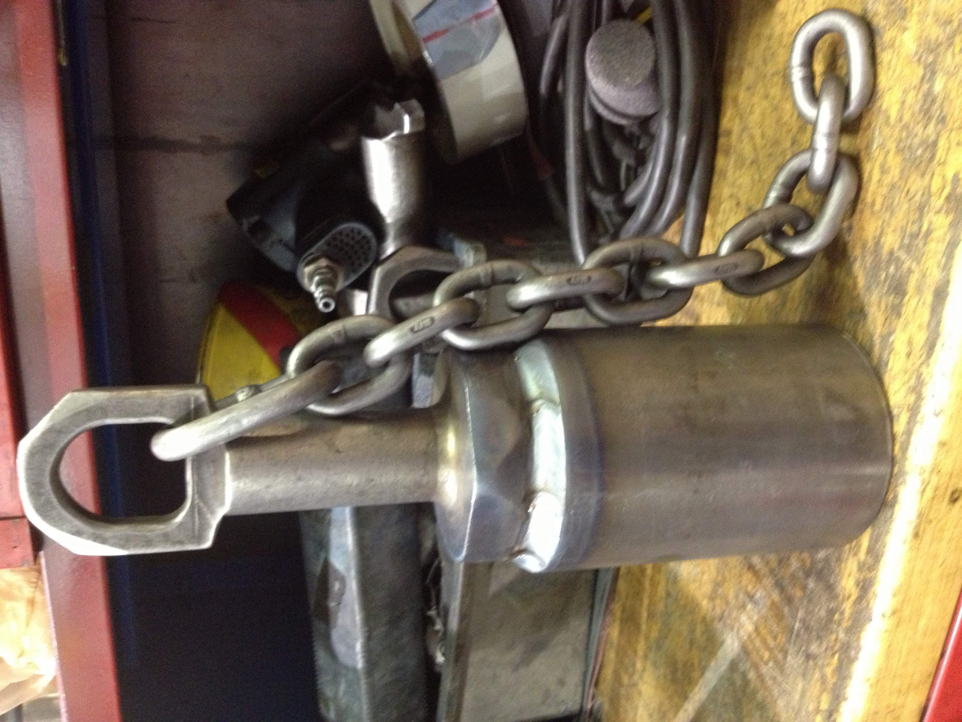

Here's the mole I'm gonna try to pull with it. I still have to grind an angle on it and short'n up the chain some but here it is. It was used to lift big parallels at work, someone busted the chain on the other side so they threw them away. I went to the welder and had him attach a plug on the end of it. Sorry, I tried to shrink the pictures and rotate them but I don't know how to do that. I can barely make this thing work sometimes.

I thought about parabolic rippers when I was making mine. In stead of being straight, I set the pivet point back on my rippers to give it a longer cutting angle. They will engage the ground at a 60* angle and the foot will be parallel to the ground. That will give me an extra 4" of cutting edge in 24"s of depth. I've only looked at pictures and never measured the central angle on a parabolic ripper. So I'm not sure how much more length of cutting edge there is. I'm hoping that the longer cutting edge and the 45* down the length of the ripper will help it pull a lot eaiser thru the ground.

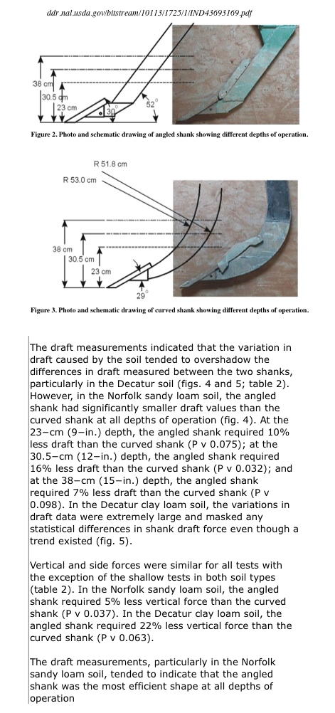

Subsoiler shank style comparison test:

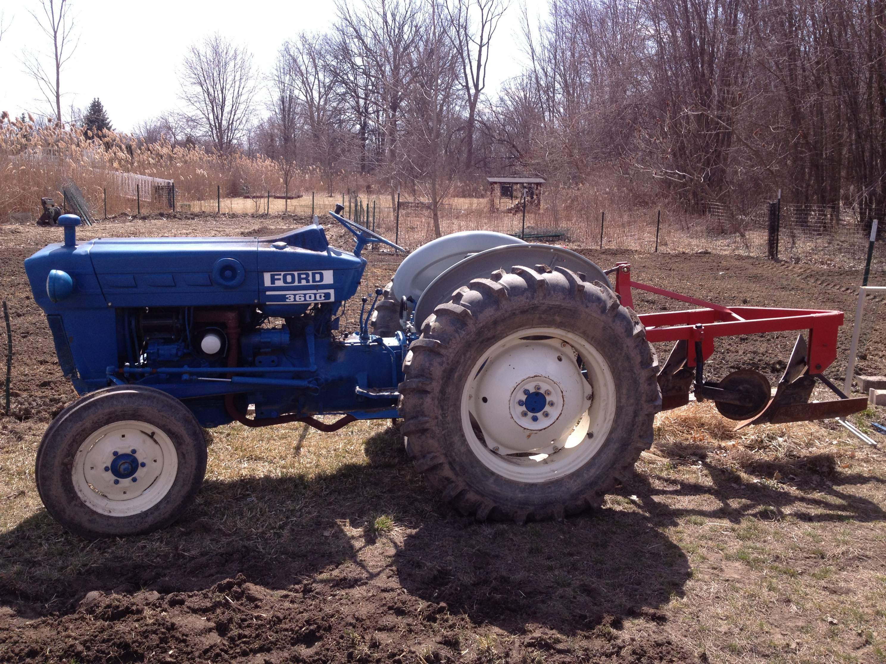

Thanks Bruce, I'm happy to see its easier to pull an angled ripper than a parabolic. The plow frame I have has an angle of about 54*(could be 52*). To make things easier to cut/fit I set everything up on 60*-30*.
I tried it today and it didn't go very good. It's still pretty wet so the tractor had a hard time hooking up after 10"s. With both rippers it went in the ground nice and even but was to much so I removed one ripper. There's no way I'll be able to pull a single ripper with the set up I have now, I only have a chain connecting the lift arms. I need a turn-buckle on the left side of the tractor because when the ripper starts to enter the ground the other side of the plow frame goes up causing the ripper to tilt while its in the ground. I'll give it another shot in a few days after things dry up. I'll grab a turn buckle from tractor supply too. Worst case I'll make a new mount for the single ripper to keep it centered behind the tractor.

It seems we have some conflicting information. The artical Bruce posted showed that an angled ripper was easier to pull in different soil conditions. In the URL it looks to have come from the USDA.
