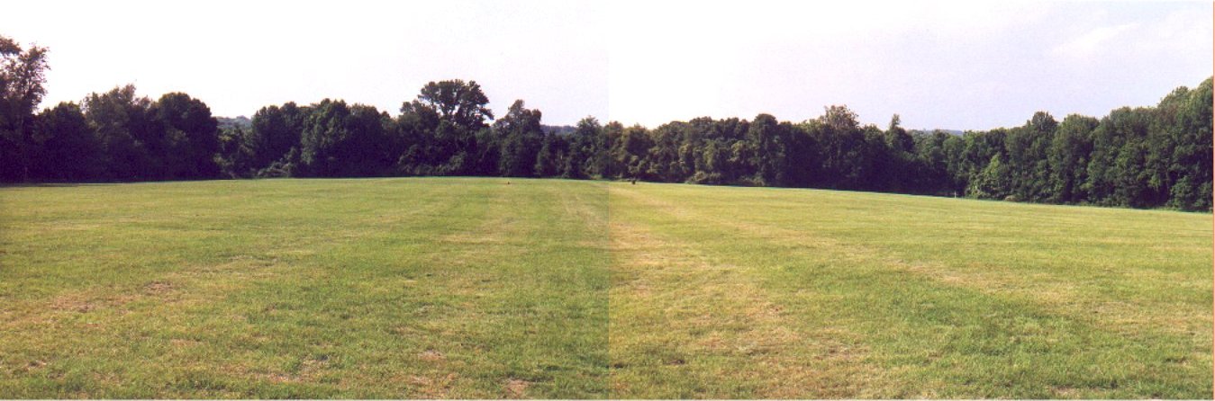

Dave, I usually have no problem with the pictures, but this one is a puzzle. My computer wouldn't open the picture on the other link either this afternoon, but in the original message, I got just a band across the top; got to see the top of the trees. I have no idea why.
Bird

If I closed my eyes and was planted here… this looks like some of our property… thick nasty and tough vines…

Bird -
Sounds like there is a dirty data path between you and Dave's website server. Not much you can do about it yourself. Just hope that it's annoying other folks along the line so it will eventually get fixed.

Harv, that's the only thing that makes sense to me. Everything else seems to be working. I get maybe the top half of Dave's picture and that's where it stops. This morning, I got just a little bit more than I did yesterday.
Bird
