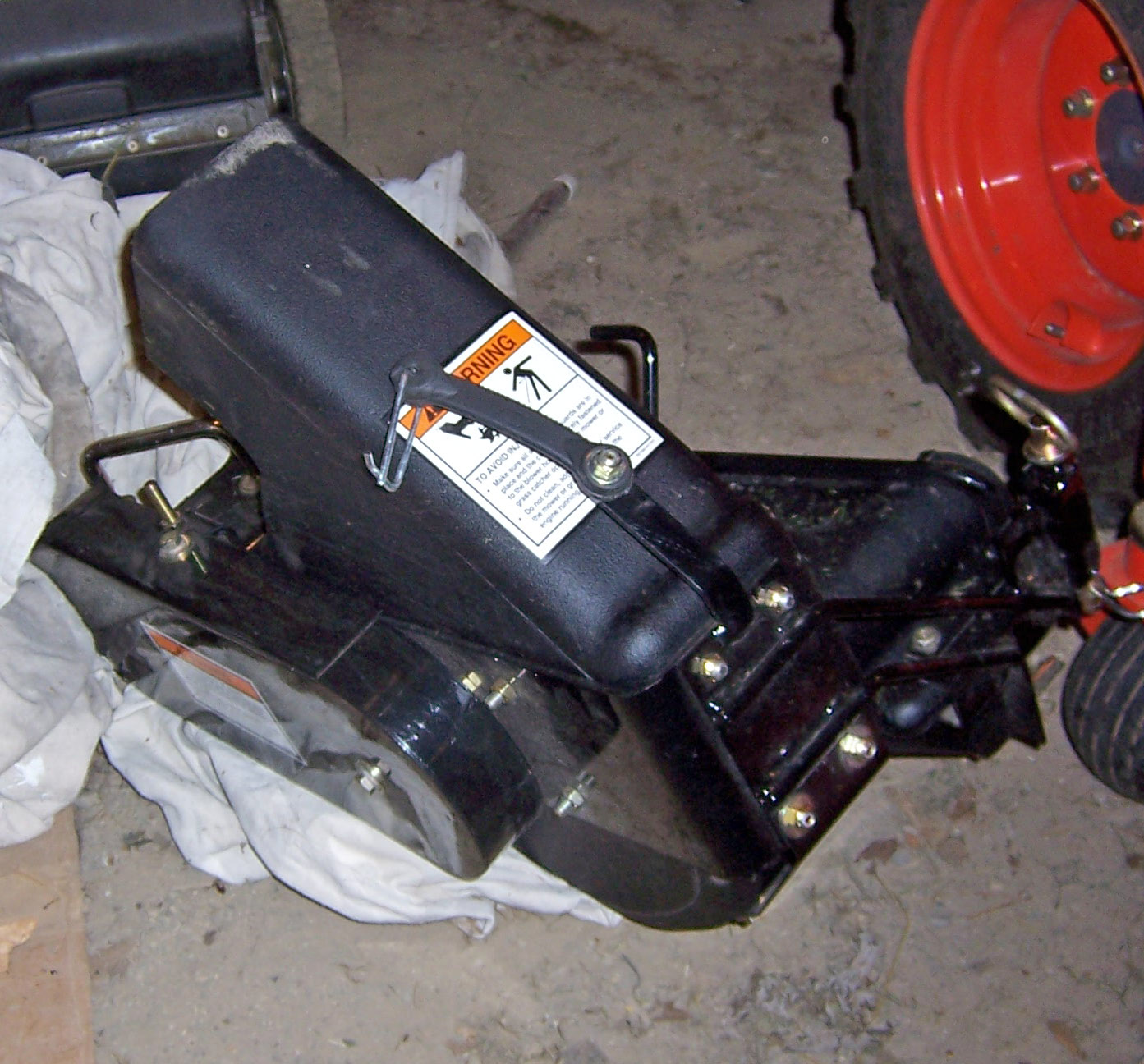

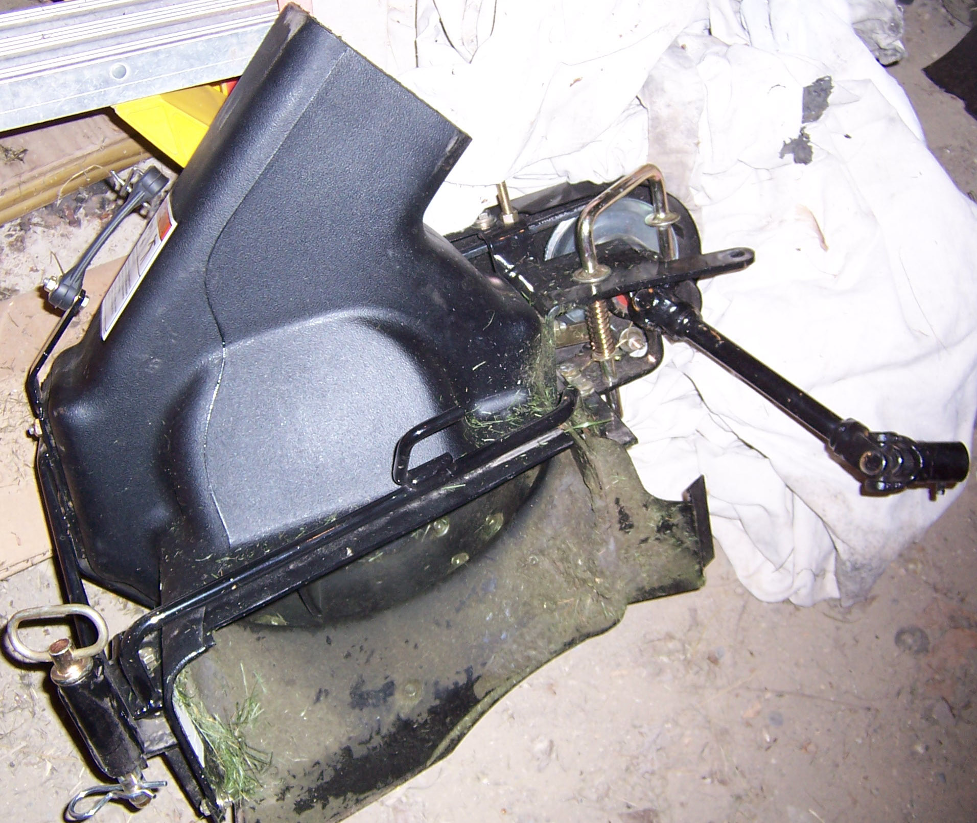

Raddad,
You mentioned that the collector on your tractor is loud. In the picture I can't tell if it is motor driven, pto driven, or driven by a pulley on the mower deck. The collector on my Simplicity is driven off the deck, and has worked well, so I was looking at the B7510 / B7610 partly for that reason. Could you supply more information, or a picture from the chute side of the tractor? Thanks. I enjoyed your review.

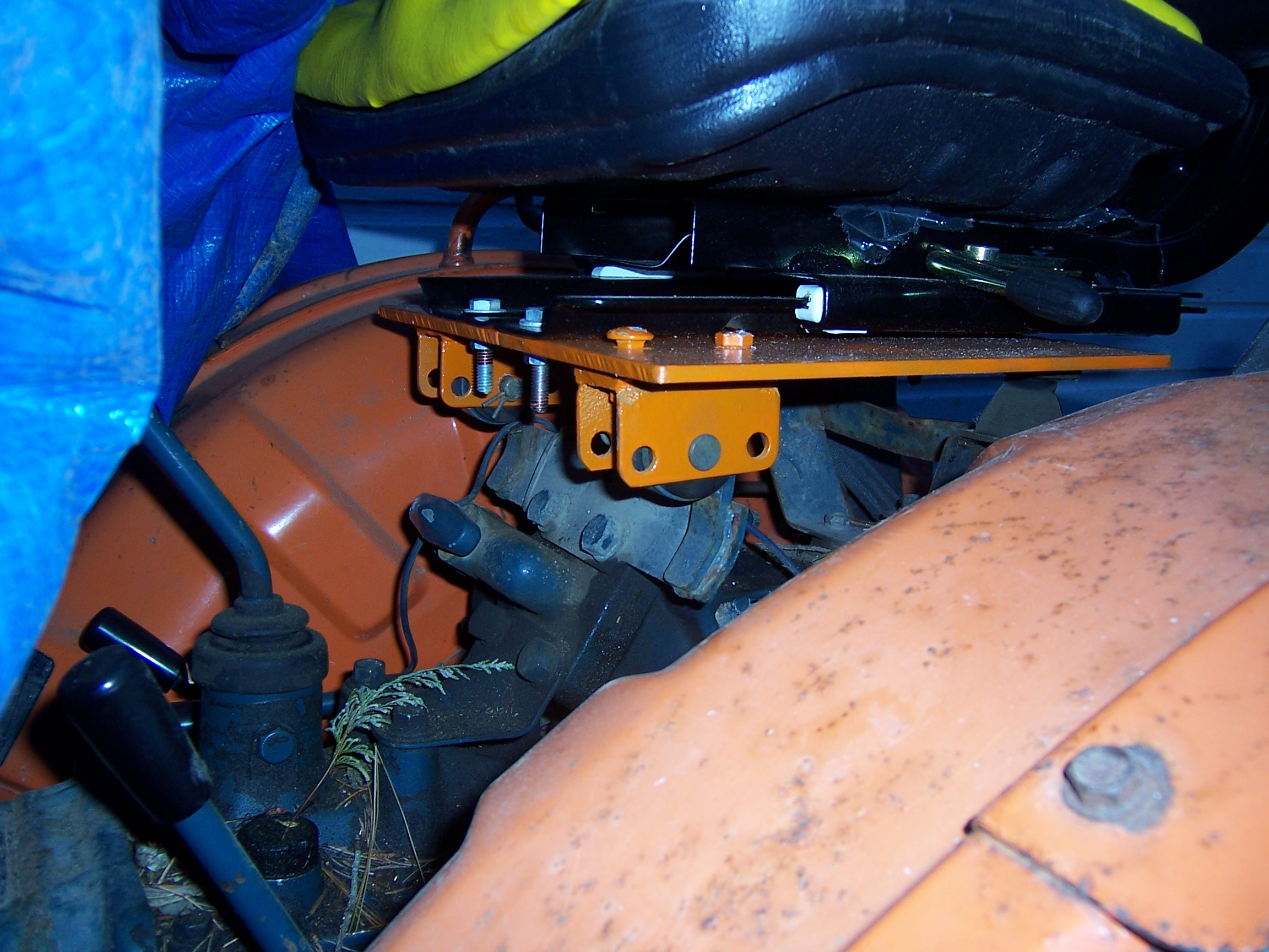

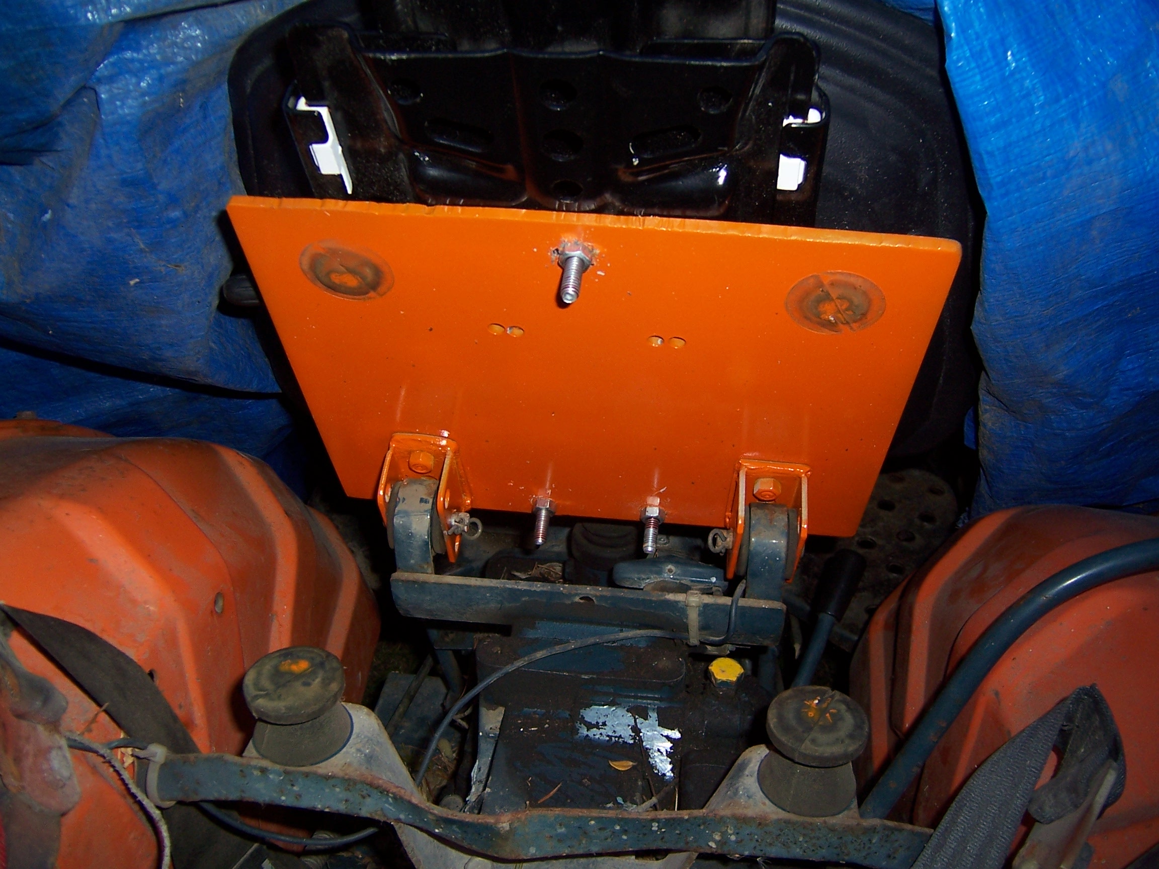

That is a nice looking seat on the B7100. Where did you get it. My 7100 needs a new seat.

There is a second gearbox mounted on the right hand pulley that connects to the short drive shaft you see in the picture. The shaft spins a pulley that connects to the blower pulley by way of a short belt. I think having the blower connect to the bags with a large non coragated solid PVC tube helps with performance also. 100_1451_edited.JPG

The seat is from Tractor Supply. You can see in the attached photo I used the brackets from the old seat to mount a 1/4 in steel plate that I then bolted the new seat to. It makes you sit higher because I chose an adjustable position seat.
