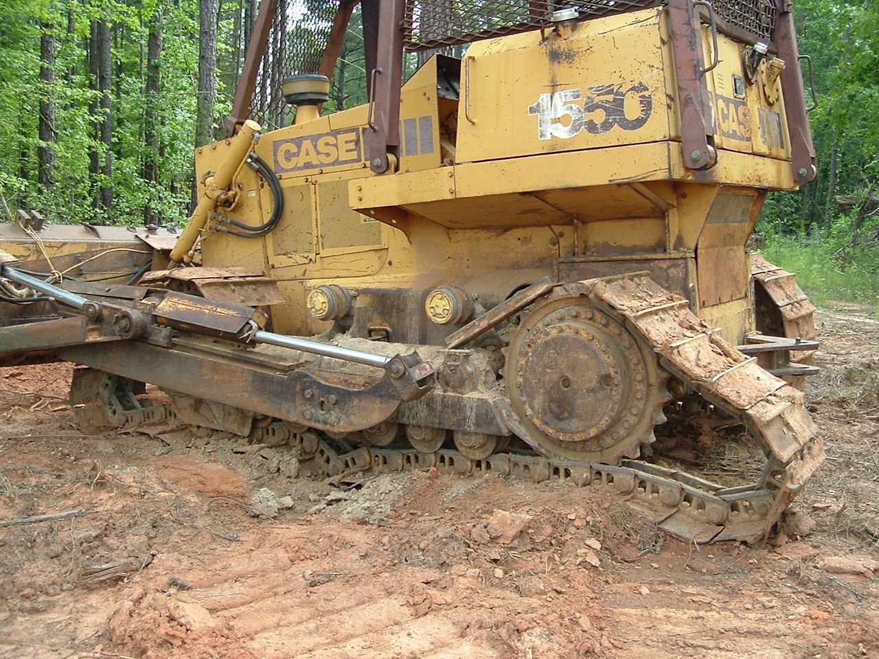

I have an IH 250-c series lll and it is the 4-1 loader. The guy that hauled it said he weighed it at a certified scales and it weighs 60,000 pounds.---I have been in some nasty areas with it and you can't see a thing from the seat,--only the back of the bucket! ---run one for a few hours and getting the feel of your own machine will give good results.
This is my 250 thanks; sonny580

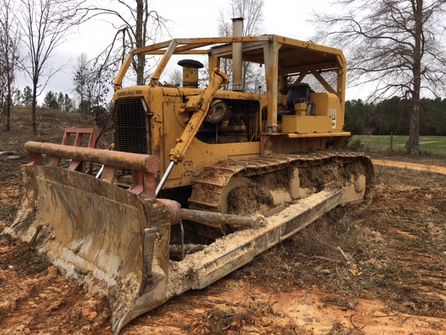

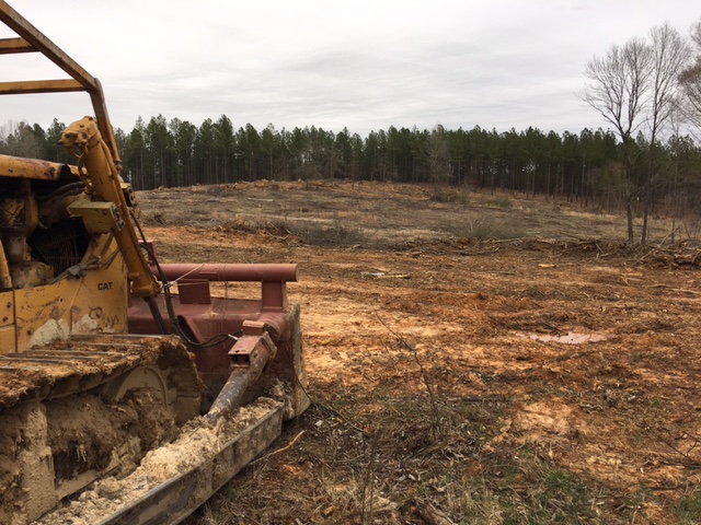

He got the dozer. It is a D8H and not a D8K. It is old and looks old. Most of the dials don't work. Seat is all torn up. But, the treads and sprockets look good and he says it cranks and runs great. He has been learning to use it and has already done a fair amount of clearing with it. He says it is hard to operate well and you're working both arms and legs the whole time. Steep learning curve. He says it handles even the large stumps fine but it is a slow process and requires backing up at least once. He says it is a problem with the stumps taking a lot of soil with them but it is wet and sticky right now and will probably not be as much of a problem when it is dryer. He says he will eventually need a root rake for it. Can't imagine how much that must cost.
He says he wants me to come drive it (it is just across the road from my place) and I'll take him up on it just for kicks.
View attachment 540920View attachment 540921
