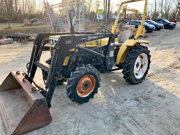

Hey everyone. I have been looking for a tractor and I came across one that I can not find any info on. It looks to be a 80's vintage Freedom FT-254 tractor. It is yellow and has a logo of a horse with tires instead of legs. I can not find any info on the web for Freedom tractors. I see that Foton has a FT254 but can find nothing on a Freedom. It has a XINXING 385 engine and is 4WD. If anyone has any info on these tractors I would love to hear about it.

If you can find nothing on the brand it may well be an orphan with no repair parts available. It may be a wonderful and capable tractor but when it breaks you may find yourself unable to fix it. I have a grey market Mitsubishi tractor. Yes, it's a name brand but this model was never sold in this country. Consequently finding parts can be interesting.
/ Freedom tractor? #4
Were I looking at an unusual tractor brand, first thing I would do is try to find parts online. No parts. No purchase.

it's interesting that if the tractor is made in China, that it would be allowed to be called Freedom!. Freedom in China??.. maybe it's made somewhere else!..
/ Freedom tractor? #8
Foton has been using FT-254 on models, Chinese tractors gets the name the customers want, they have no sense for building a brand name like other manufacturers.

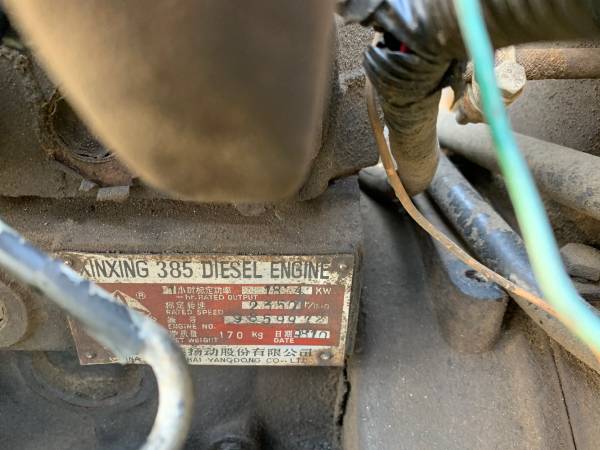

It is likely a re-badged popular Chinese brand Like Jinma, or a Korean Kioti or Daedong. It will be in these lists somewhere but under a different name. A GOOD pic of the engine nameplate would be helpful.

Little effort turned up an engine parts manual.
Parts Manual - Xinxing Y385T

Good. Is there a block casting logo such as a diamond with "JD" inside it, or any other casting ID's?
I am unsure of any casting numbers. It does have this on the steering wheel.75220726_2828109587221904_1529172884688207872_n.jpg

The logo on the steering wheel leads me to believe it may be a Jinma, if the wheel is original.

OK so mystery solved! I was searching through a list of tractors that Jinmar makes/made for other companies and stumbled on Iron Horse tractors. They are the same color yellow and have the same horse logo. Not sure if the Freedom name on the side was put on there after the fact. Thank you for all the help.

I translated the Chinese writing on the name plate... It translates into English as,
STAY AWAY!!
