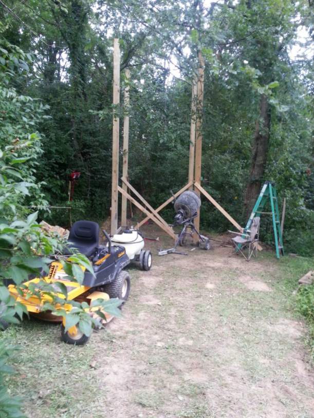

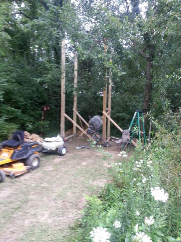

I promised my little helper i'd build her a treehouse after I finished the trailer. I got started on it a couple of days ago. I'm not using any plans, just gonna kinda wing it. I have a pretty good idea in my head how it's going to look, so that's our starting point. The main frame supports are 20' 6x6's set four feet in the ground. I got my post-hole digger stuck on a root, four feet deep, on one of the holes, I had to unhook it from the tractor and put my backhoe on to dig it out, fun stuff. I used five 80lb bags of concrete on each hole except the stubborn one, it took 12. Here's a couple of pics of our progress so far.

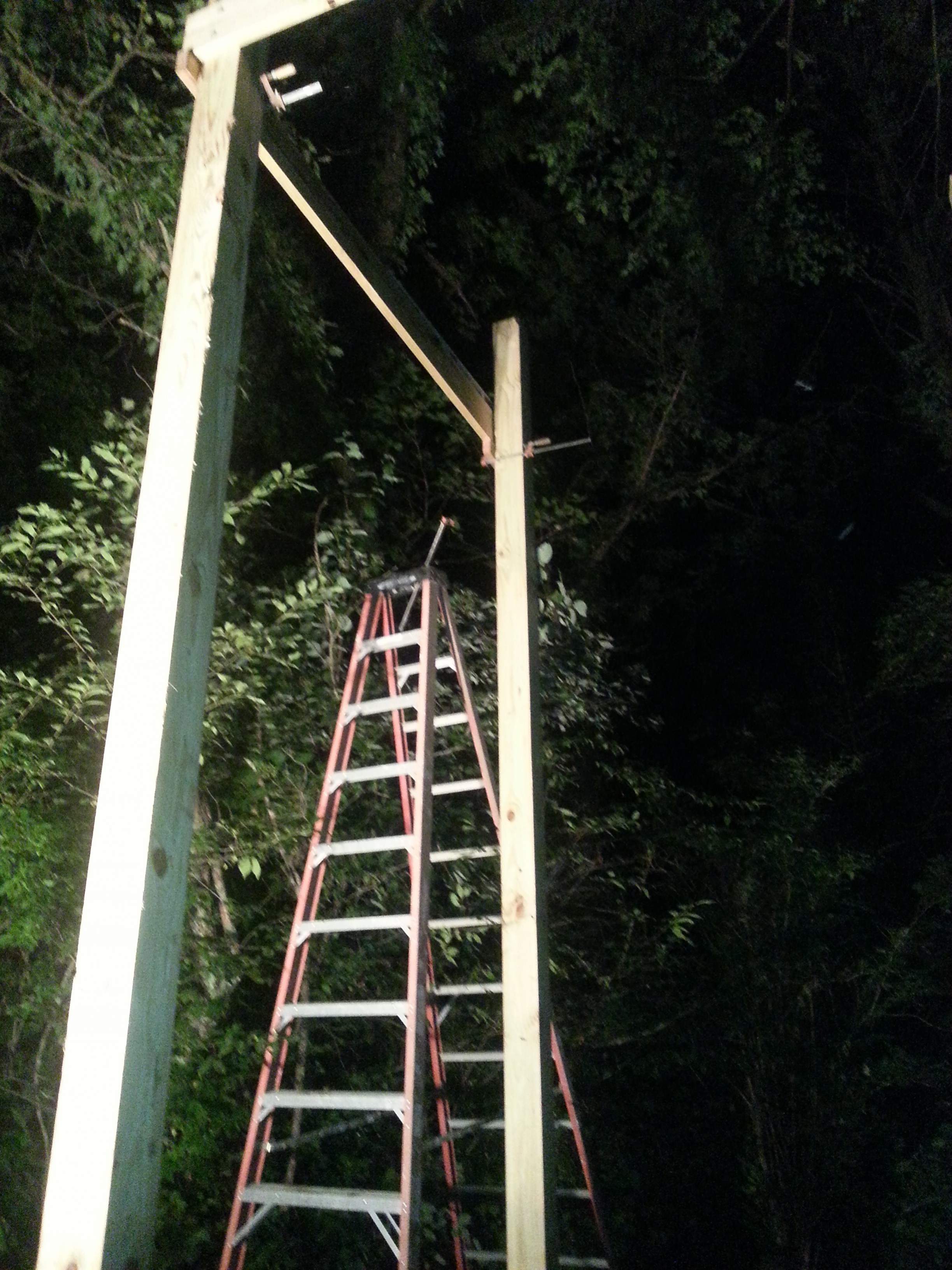

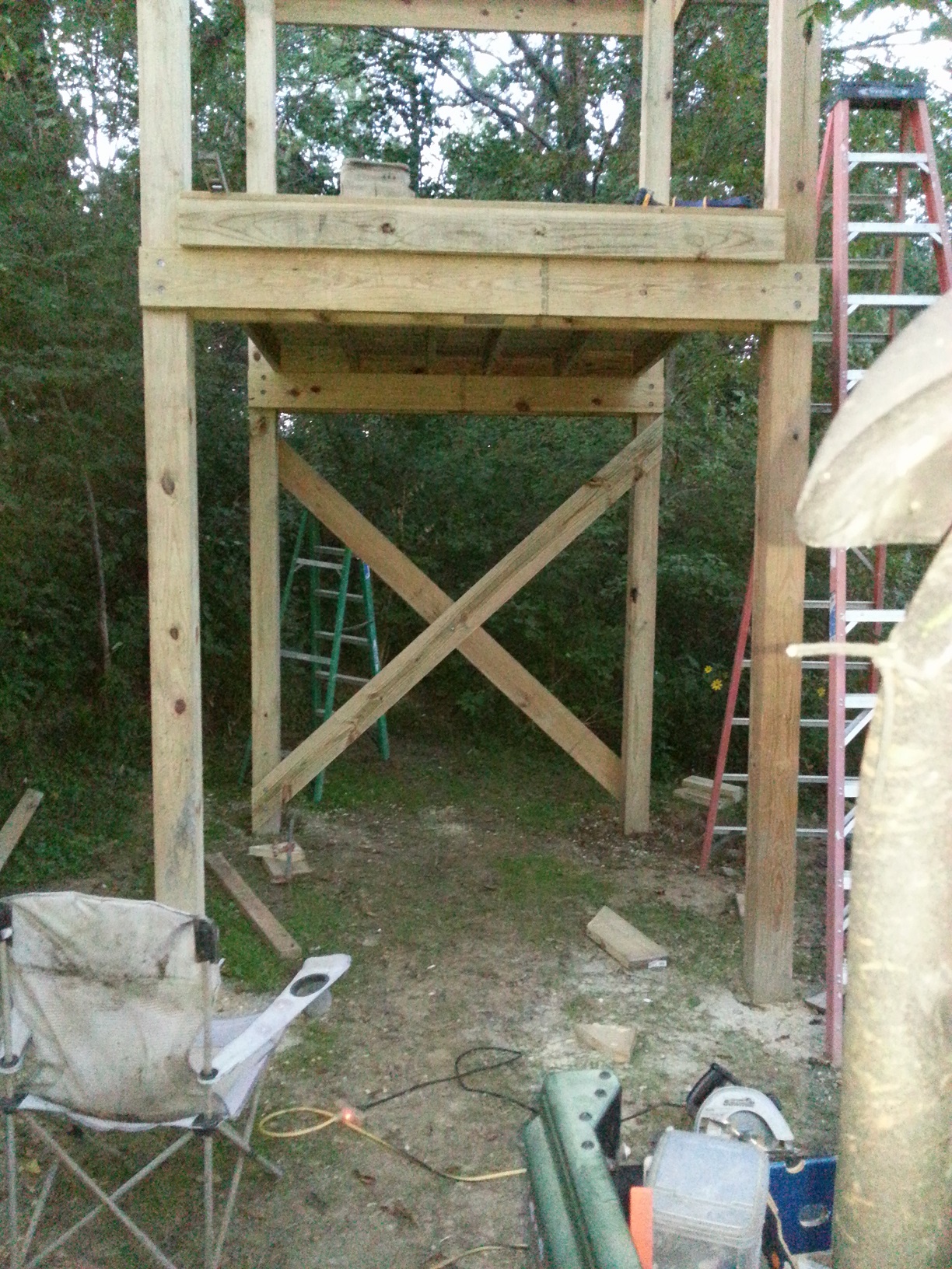

I decided to make it two floors. The X bracing is temporary, I plan on using 45 degree 6x6's for the permanent bracing.

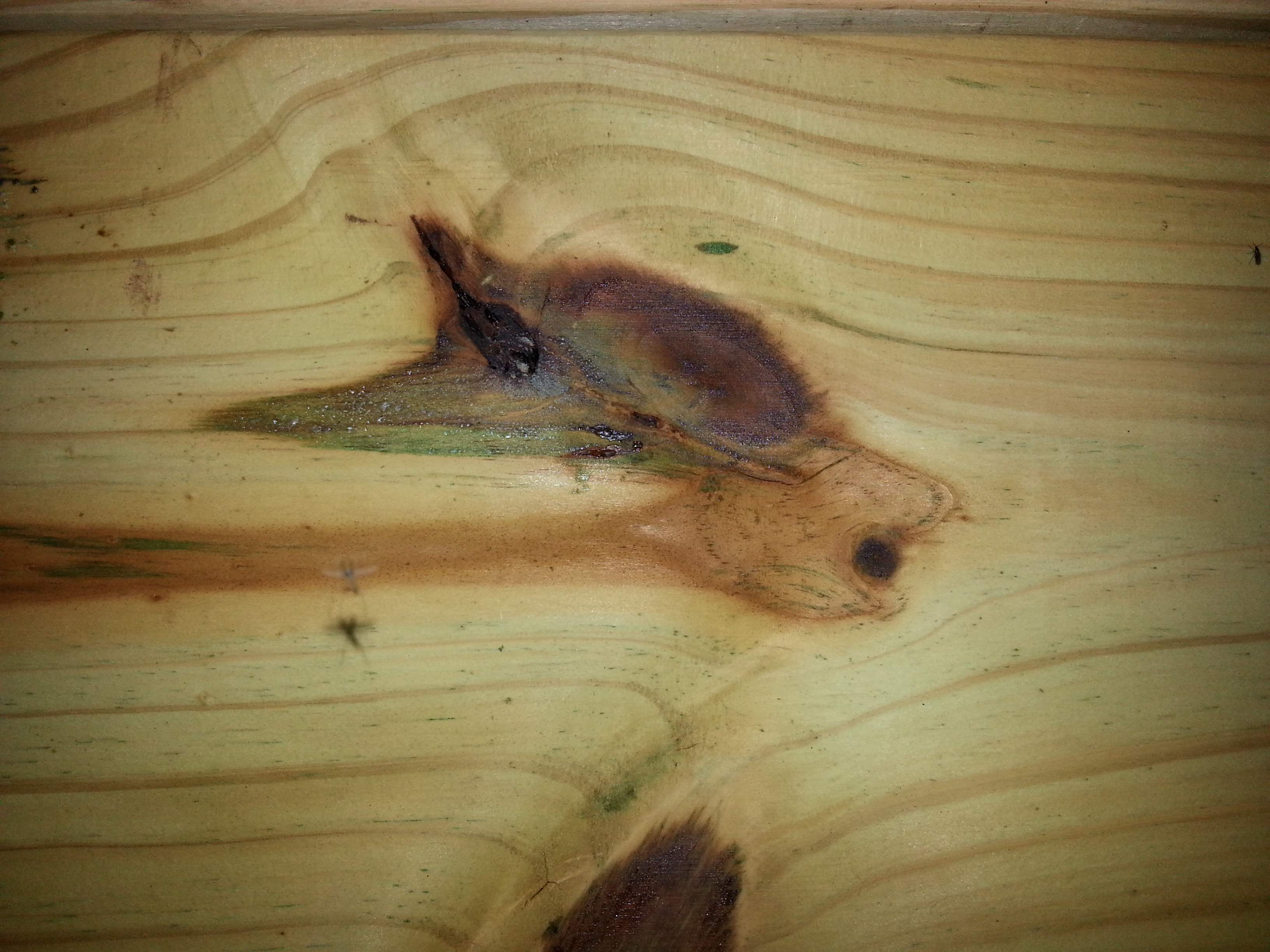

Pretty cool-looking knot in one of the beams, I thought it looked like a dog, or maybe a bear.

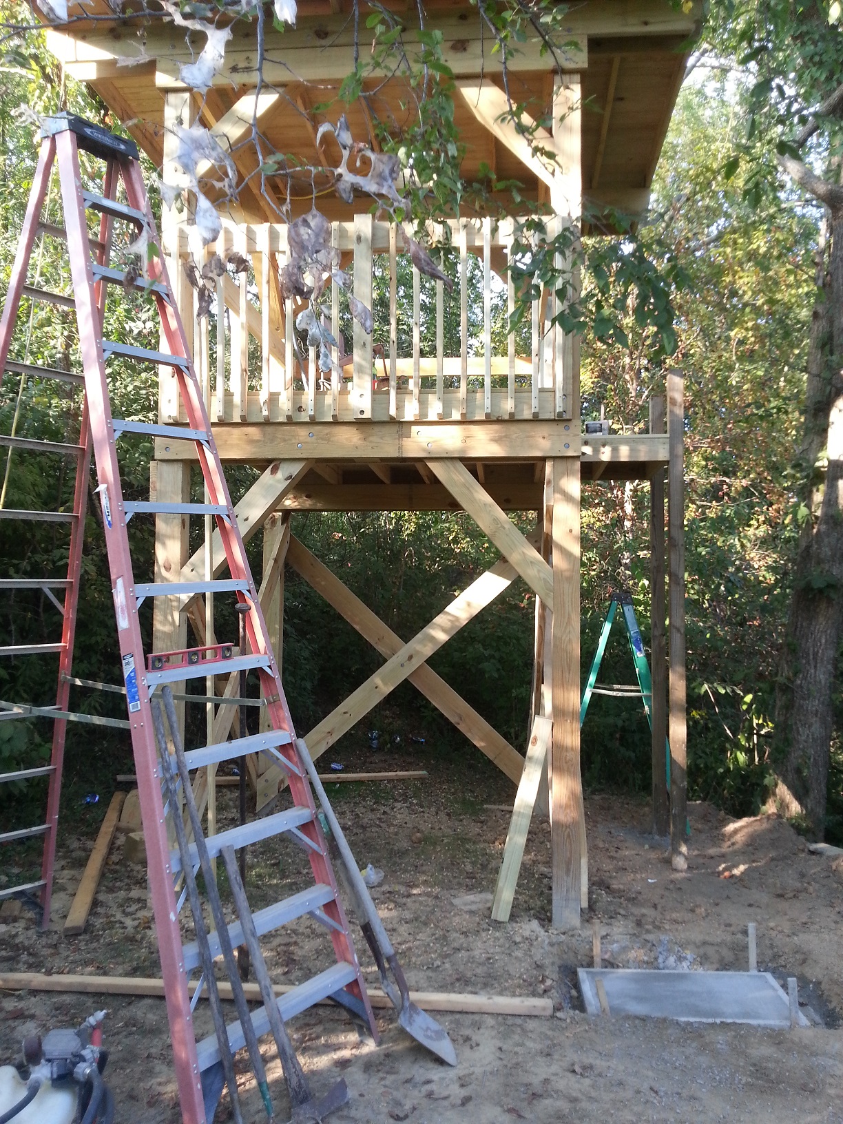

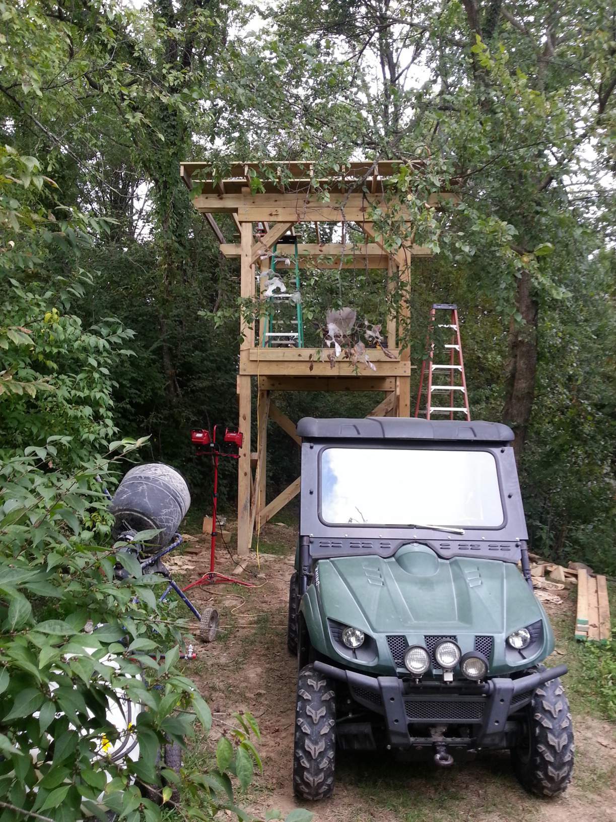

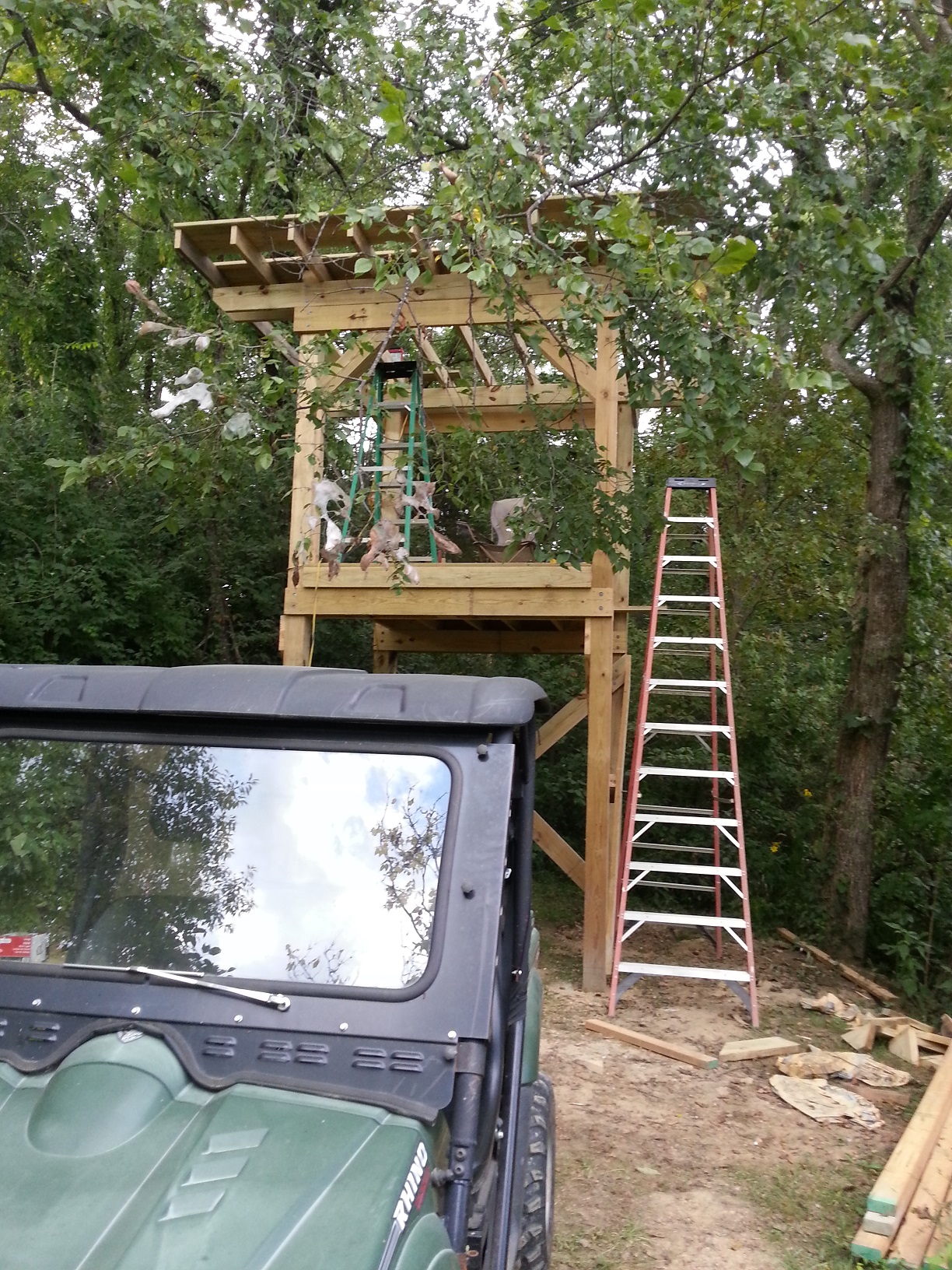

Floor joists in and laying down the decking for the top floor. I used 2x6's for the joists and 5/4 for the decking. The support beams are two 2x8's bolted to the posts with 6x6's sandwiched in between, also used some 45% angle 6x6's for bracing. Is that clear as mud? The top floor is 16' off the ground at its tallest point, that's a 12' stepladder in the pic. (on the ground).

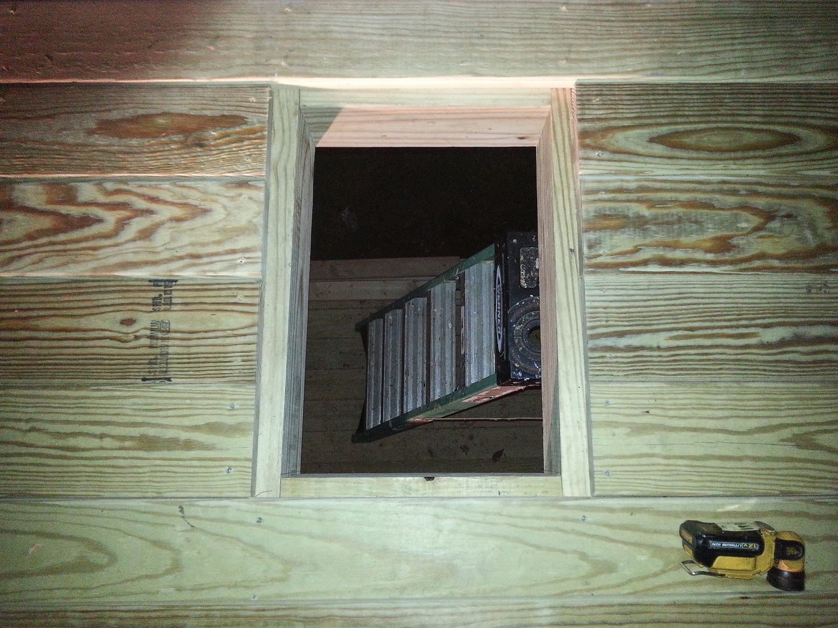

Access hatch to the top floor.

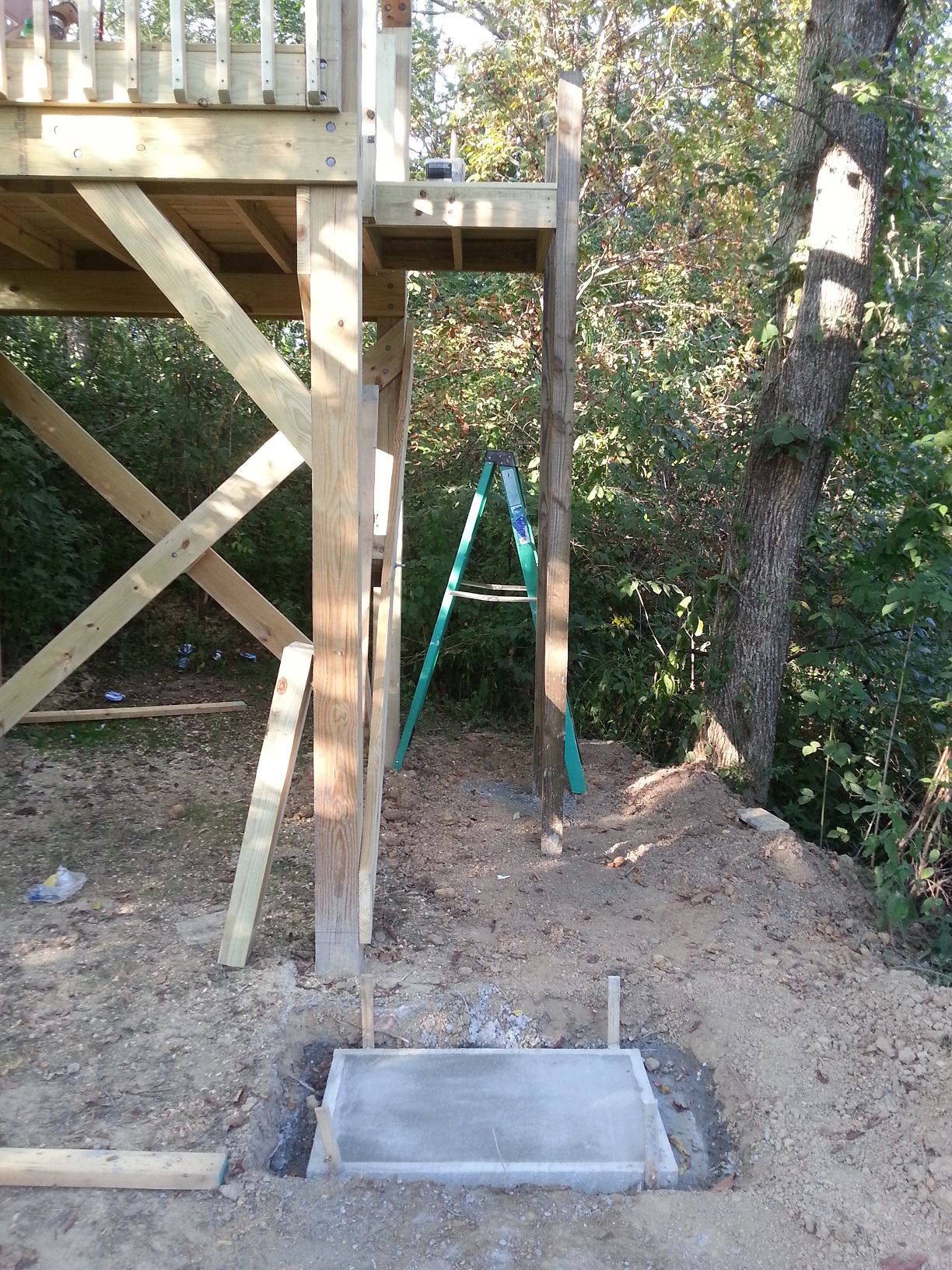

I set two 4x4 posts and built a small landing for the stairs, also poured a small pad to anchor them, the concrete is below grade so it won't be seen. I also got all the spindles in for the first floor.
