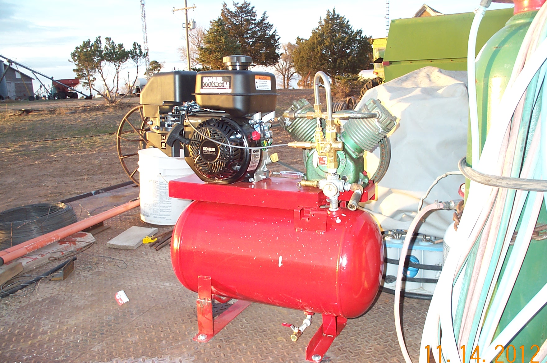

many of the farmers around here have made rear bumpers out of 4x4 or 4x6 tubing, and weld over the ends and drill and tap for a valve and quick fitting and some times a gauge, so they have a air tank on the truck, and going a step further many put air conditioner pump (the ones with a separate oil crank case) and use a pressure switch under the hood for a on the go air compressor,
and the gas engine air compressors are wonder full IMO,
I had a few compressors go down and I took the tank of one and the pump of another and bought the engine and a unloader valve and put one together, It is the handiest thing around, I take the air to the machine not the machine to the air,
