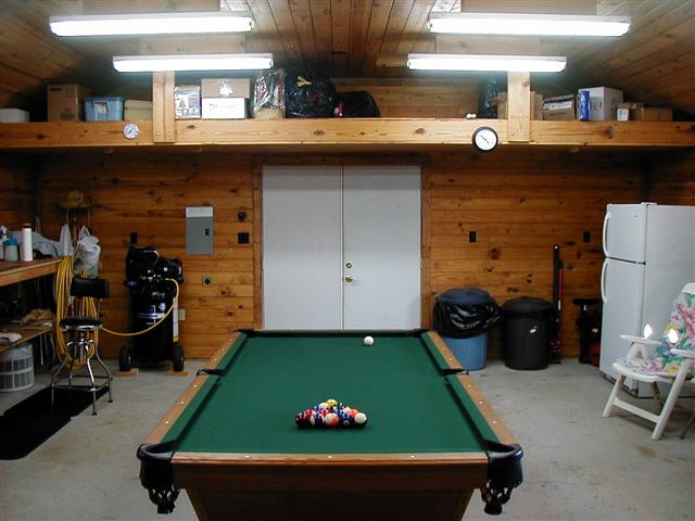

The one thing I have been meaning to do for a long time is install a 90 ell and 1/4 turn valve on the bottom for draining the water.
I did that a long time ago. Since it's so quick and easy, I pop that valve open at least 4 or 5 days a week.
Unfortunately, the drain was so low to the floor that even a little 90 el was against the floor, but since I never move the compressor anyway, I put some blocks under the wheels, as you can see.

As I stated earlier, I was determined to put in a quick valve to drain the water, so while in town at Lowes I picked up all the fittings I need in brass which was all Lowes had in 1/4" size- 1 street ell ($5.20) one 2.5"long nipple ($5.29) and a 1/4 turn ball valve ($6.49). It all fit like a glove and by using the street ell, it keeps everything up off the floor by at least an inch and the 2.5" nipple puts the valve out far enough so the curvature of the tank bottle allows for the valve handle to be facing up so it is easier to reach. I just need to take a picture of it to prove that I actually did install it.
