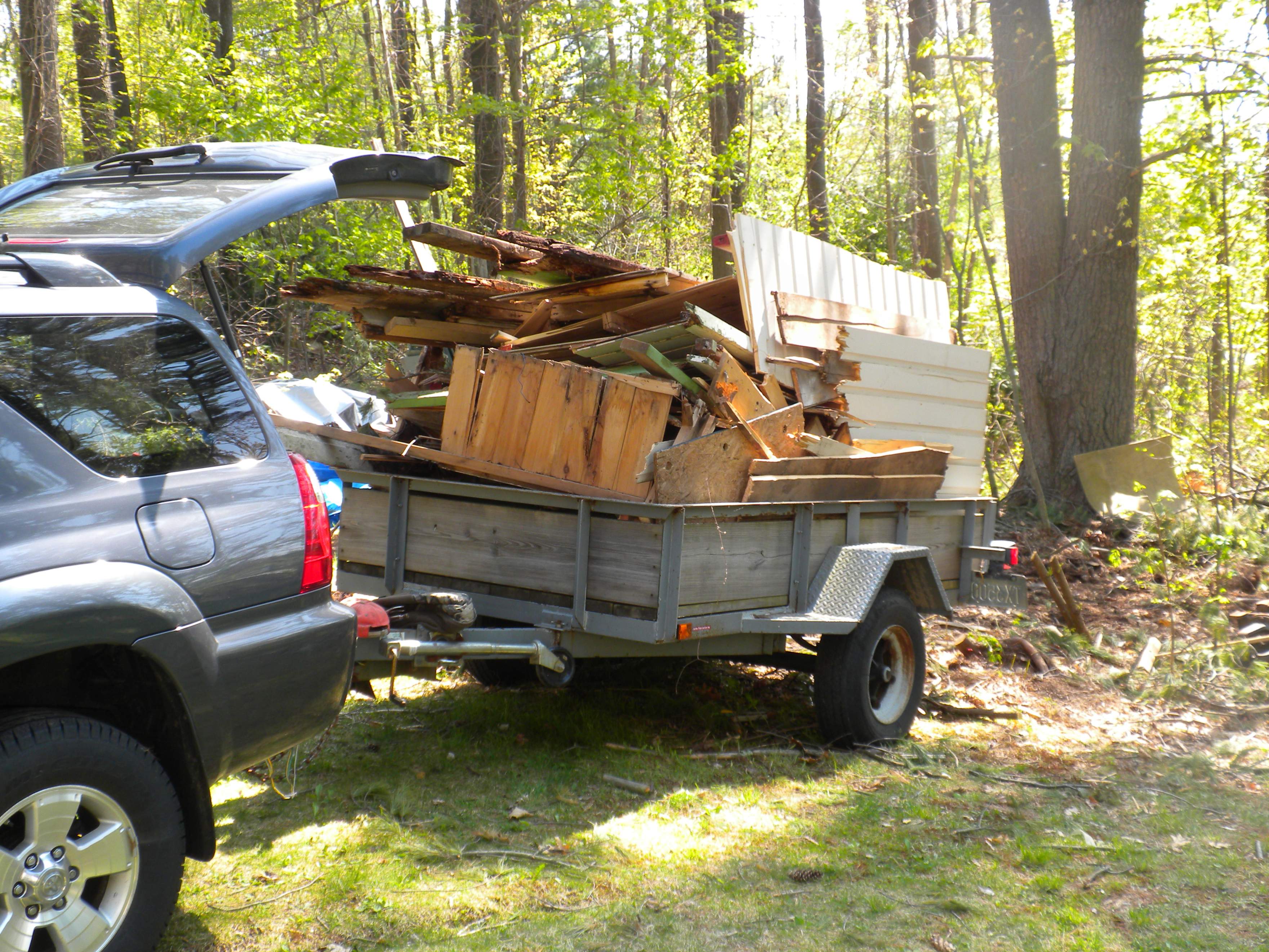

I made two of these 5 x 8.5' with tilt (no hydraulics)......while backing, the tail of the trailer would bite the ground, wheels would raise off the ground and the trailer bed would raise up almost vertical to dump......works great at the dump......

wdchyd....Great setup! How do you get the initial lift so that the tail bites the ground.....gravity? Is the pivot point directly above the axle? Or, on second thought, is the pivot ahead of the axle and you just block the wheels and back up?

The frame is 3" channel iron and the rear piece is facing out back leaving the pointed sharp edge to dig in to the ground when backing up......sometimes 4wd is necessary to attain lift but the weight of the material in trailer helps to hold down rear......the pivot is ahead of the axle and the axle is fairly tall (mobile home axles/wheels).......blocking wheels doesn't work cuz the tail of the trailer is the spot to bite.....geometry has to be just right...
The first trailer like this I built was just an accident that it dumped.....
Didn't use hydraulics as we all know it probably would cost too much to send out to repair if it spings a leak.......:laughing::laughing::laughing:

wdchyd,
That is a nice setup. Do you release a hold down in front that allows the pivot to tilt the bed to the ground initially. And then back up?
It looks like, after you dump, you must have to pull the box back down after pulling forward a bit. Right?
/ Frame dumping trailers #10
Yes, I had a latch that would snap in and later changed it to a nut/bolt to minimize rattling going down the road ,most time using trailer I don't use for dumping, just hauling......
/ Frame dumping trailers #11
It looks like the pivot points are approximately even with the front spring pins. Are you careful to load the trailer for dumping balance?
/ Frame dumping trailers #12
After taking off the retainer nuts (to tilt)....I tilt to ground and gravity takes over (balance is important)......the pivot pins raise up when tail is on the ground..... it's all in the geometry and this would not work with small wheels/short axle or long bed.......
The other consideration is the pivot pins could be moved forward (didn't have to) if dumping is too tough to accomplish......this would increase the angle when the tail is on the ground....
