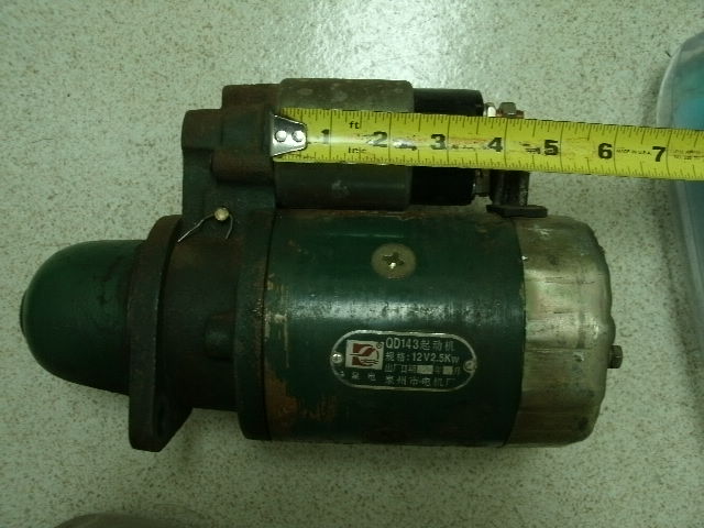

Long story short: EX's now gone new friend installed a new solonoid on the starter pictured.
Starter does not disengauge all the way after engine fires up. After taking it off, I get a measurement of about 1&7/32" from flywheel to end of bellhousing where starter mates to. When I pulled it off, it was obvious that the starter gear was to far out and staying engauged. I could hear it and feel the starter and tell it was spinning while engine running. The gear does have some play in it, see below. My question is, should there be enough spring action to retract starter gear all the way back to clear flywheel, OR IS THERE MORE THAN ONE SOLONOID FOR THIS STARTER which would have a shorter throw?

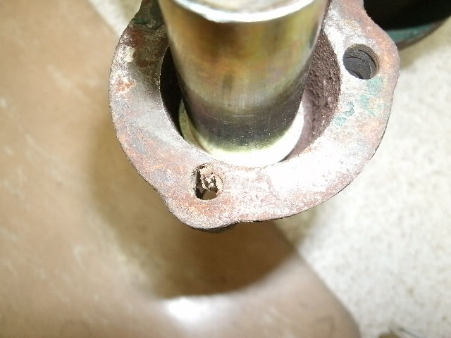

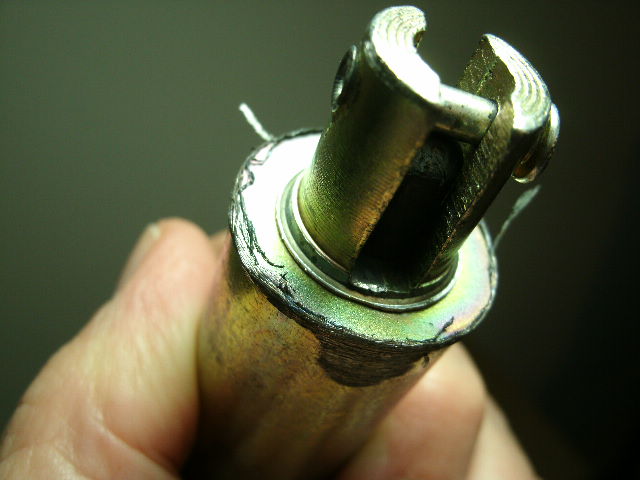

Think I found the problem. I think the return spring is slipping past plunger lip and causing plunger not to retract starter gear all the way. See damage to plunger and how spring will slip in picture and video below. Thanks for all the help. Click photo to enlarge. Click on video to play. By the way, that is a new solenoid plunger with less than 4 minutes run time on it.

That looks wrong , in the sense that the plunger end should have a shoulder or lip ( something) to keep the spring from sliding past the end of the plunger like it is...
I think you have found the root of the problem - it might help to have an exploded view of that starter, is it possible a piece is missing??

See post above and click on picture of plunger. It appears it self distructed somehow. I dressed up the damage and tried the spring which failed in my opinion. Just ordered a new solenoid from Affordable(Harold-great service).. I am coming behind someone who put a new sonenoid on this tractor and never cranked it. When I jumped it off, I knew right away that the starter was still spinning and probably engauged at the flywheel. Heck, I'll post some picture for you. What you see is about 4 minutes of run time. Click on pictures.

OK- after looking at those last two close ups it would appear the shoulder that keeps the spring from sliding past has been damaged and worn down , and the spring is sliding over the end which should NEVER happen
hopefully the new solenoid includes a new plunger and spring The above statement about the solenoid having just been replaced- worries me that when the solenoid is ordered - that they are only supplying the outer electromagnet structure and internal power transfer switch- just like some american replacement solenoids, In reality the only parts you need are the spring and especially the core/plunger...
If the new solenoid includes the plunger/core and spring
Re assemble, and everything should work great. Might want to check the starters operation on the bench before remounting it- especially that the starter drive is pulled back into its parked position after power testing it. Good Job :thumbsup:

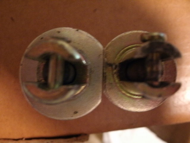

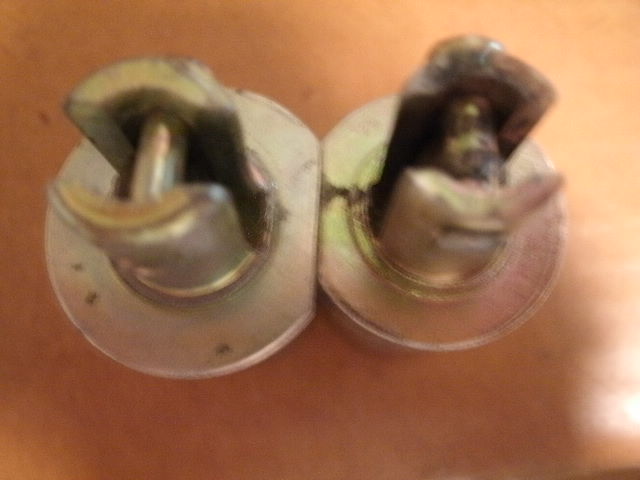

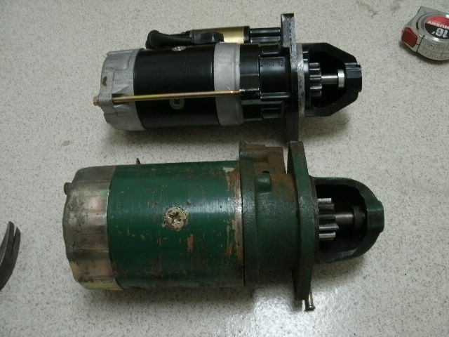

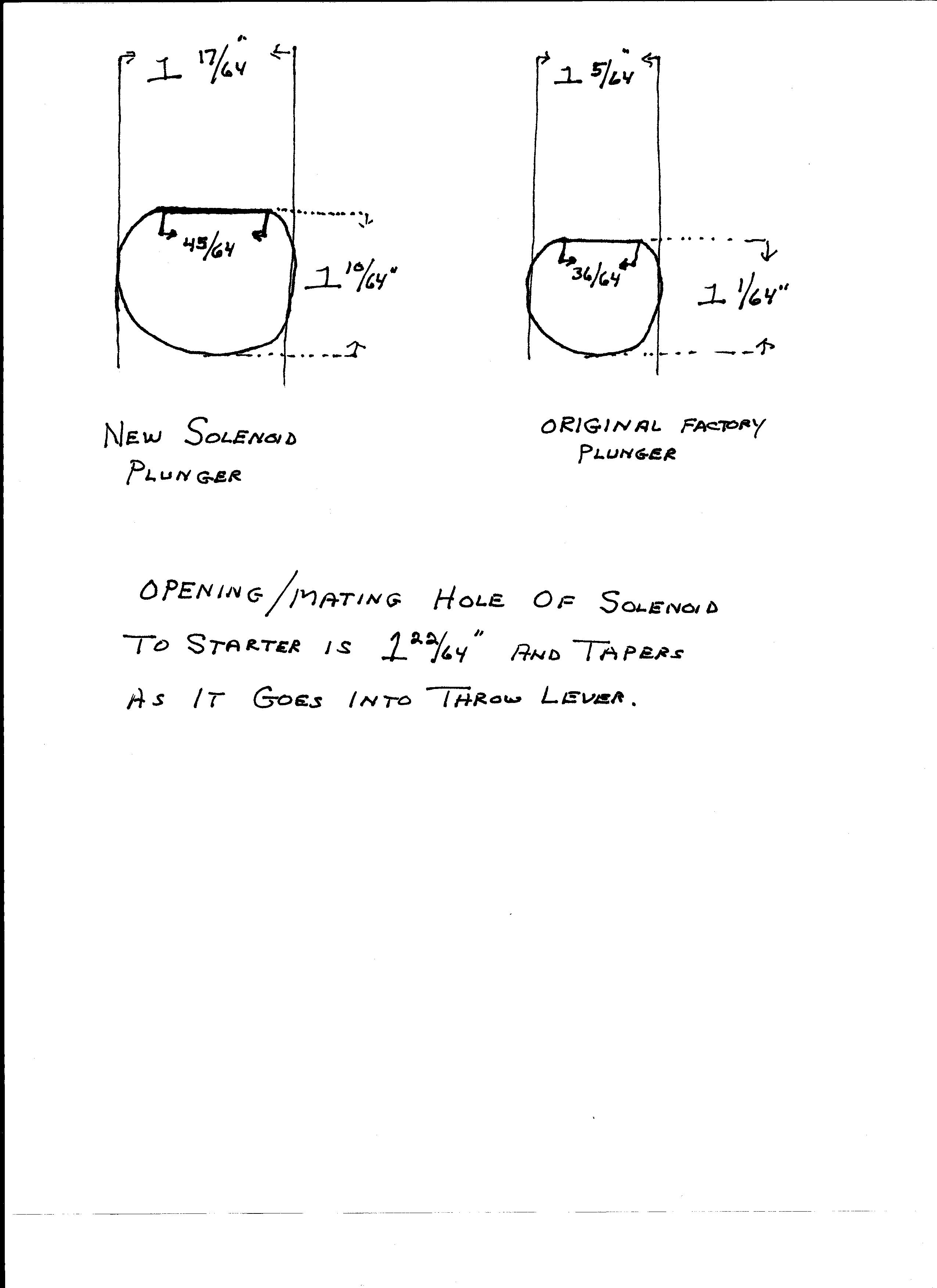

This post may save some people a headache. Starter problem fixed. I will try to post pictures of original QD143 starter, the replacement solenoid for it which did not work,QD1315A and the new replacement starter QDJ1408, plus one more drawing. What was happening with the first replacement solenoid someone else ordered and put on, was that the plunger was to big for inside throw space. It was just hitting the side and chewing off the lip that holds the return spring. This happened during engaugement. I ordered a new solenoid through Affordable and upon arrival, I could tell that it was to big for the opening it was supppose to travel through. It hit bottom as soon as I hand fitted it. Pictures enclosed of how far original would go in vs. replacement. Had to get a whole new starter. Click on each to enlarge. Start a beginning of thread to see plungers and damage due to wrong size.
